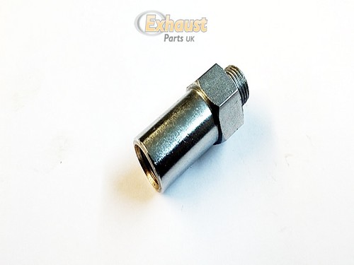

Long Extension Lambda Boss Exhaust Oxygen Sensor - De Cat - M18 x 1.5mm

You can also look for a "spark plug anti-fouler" which will allow you to mount the downstream o2 sensor farther out the exhaust stream. Many times that will fool the system into not throwing the cel. They can be found at most auto parts stores pretty cheap.

Well the kit comes with an extender but it still threw the code. I wonder if that one would work..
I never got an extension but did get 2 blanking plates. I cable tied the 2nd lambda probe outside of the header so it would read clean air (from the engine bay) but it still tossed a code! I'm not sure why haven't had it diagnosed yet.
