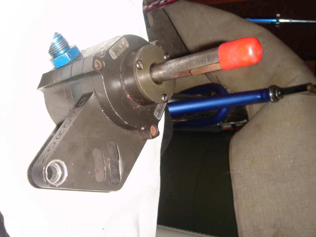

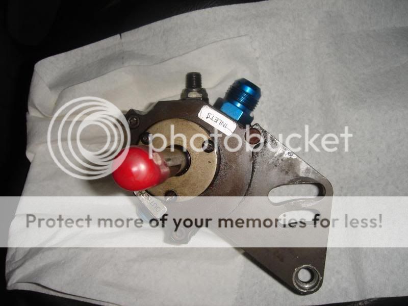

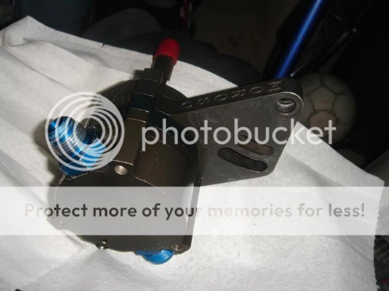

Just realized I didn't put up pics of the oil pump..and realized I didn't take any pics of the chromoly retainers and such..
Its a used pump, but was just rebuilt by Moroso..just needs a cleaning up.
