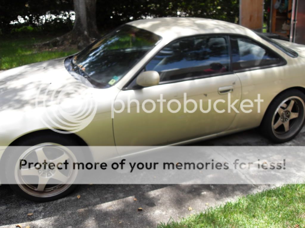

hey everybody Im actually building a S14 for one of my friends but I picked everything out, the shell and all the parts and take in perspective I only have 1 month to do it, and the only guide lines are it has to be under $15,000 with around 400HP and a bad ass suspension (drive2)

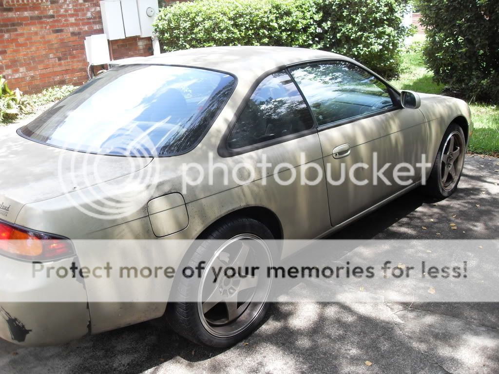

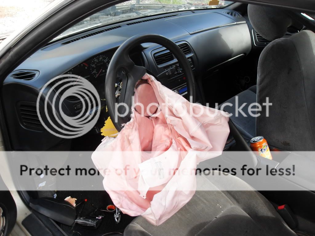

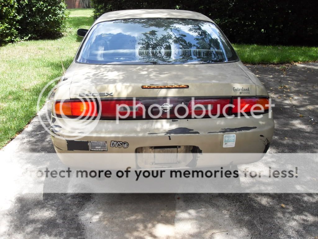

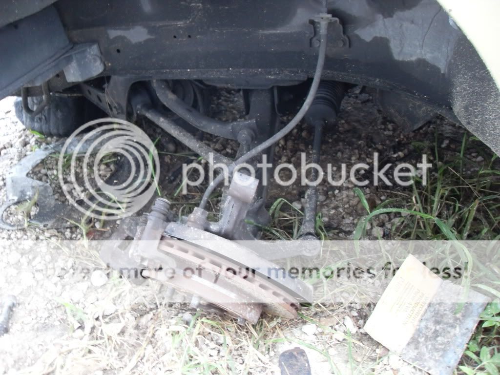

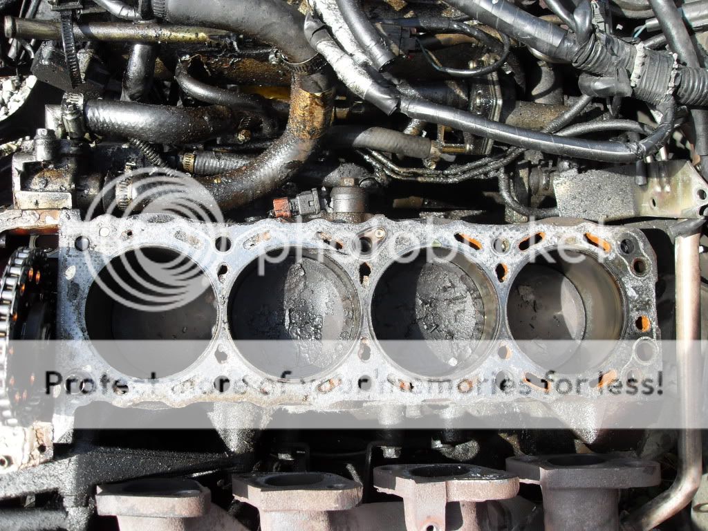

this is the shell I got

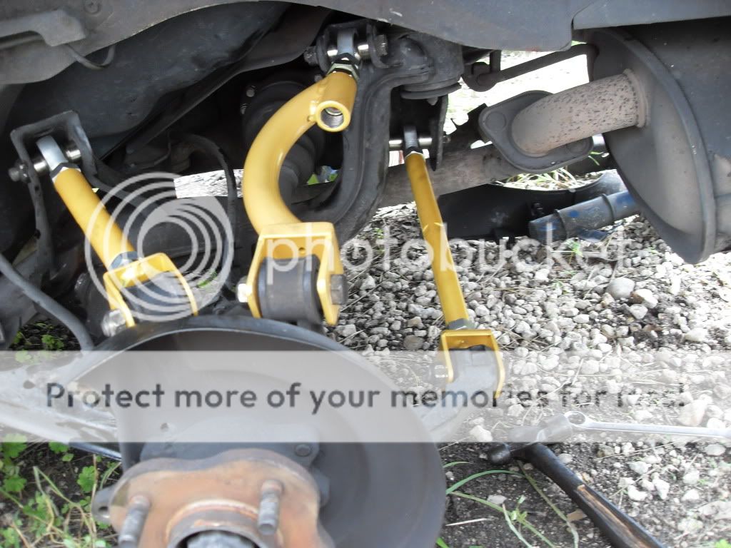

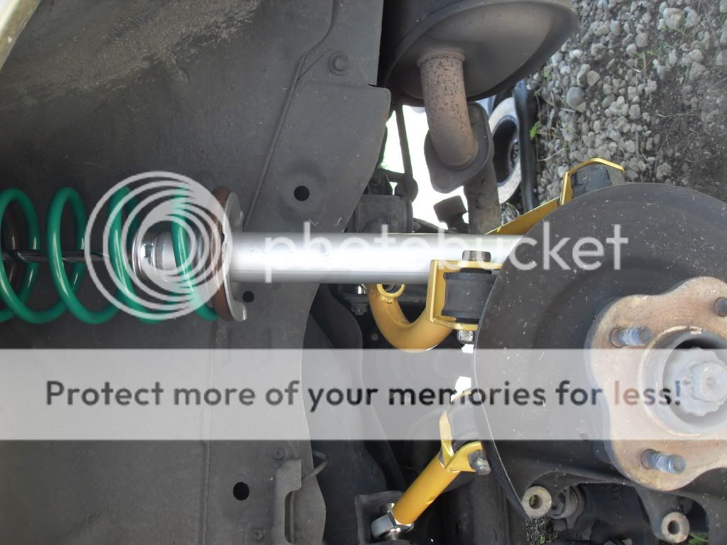

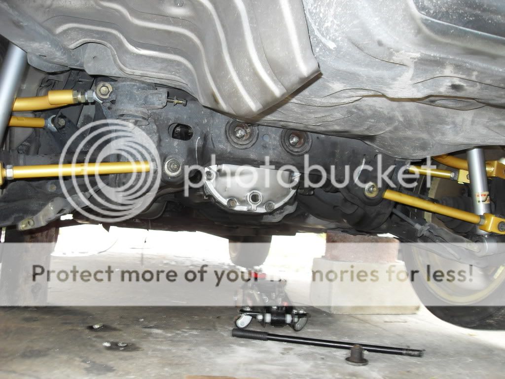

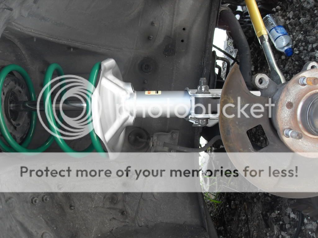

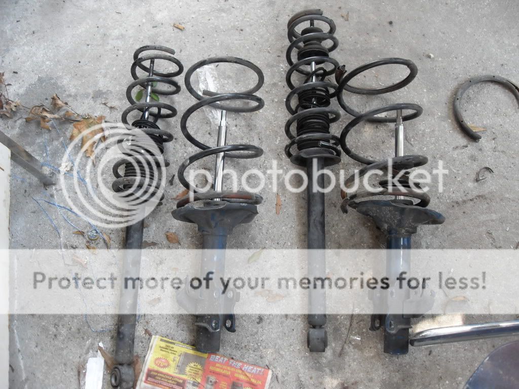

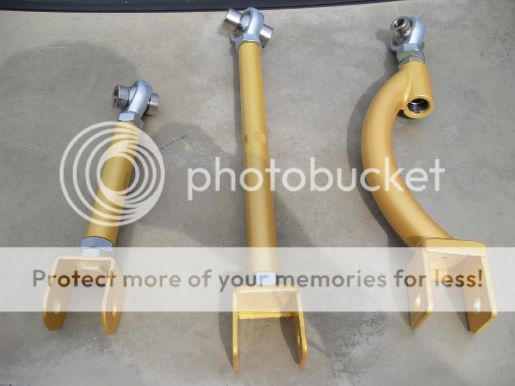

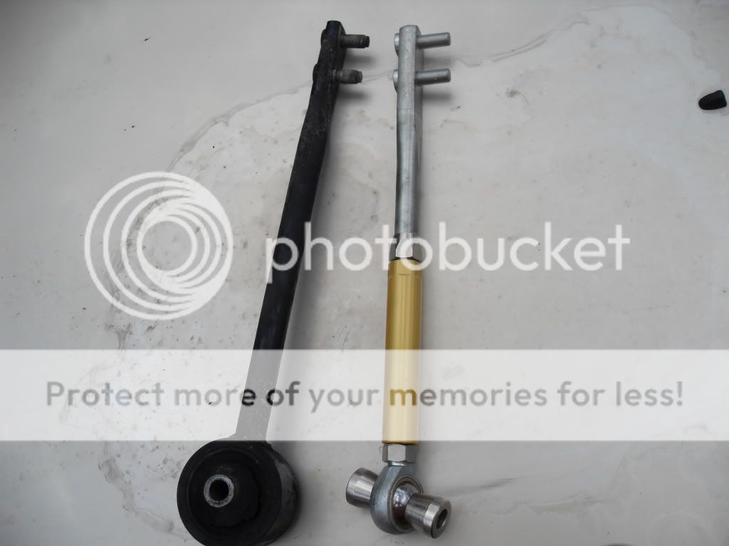

Suspension work.....
Tein Springs + KYB Struts
stock differential
Infinity J30 LSD + Suspension

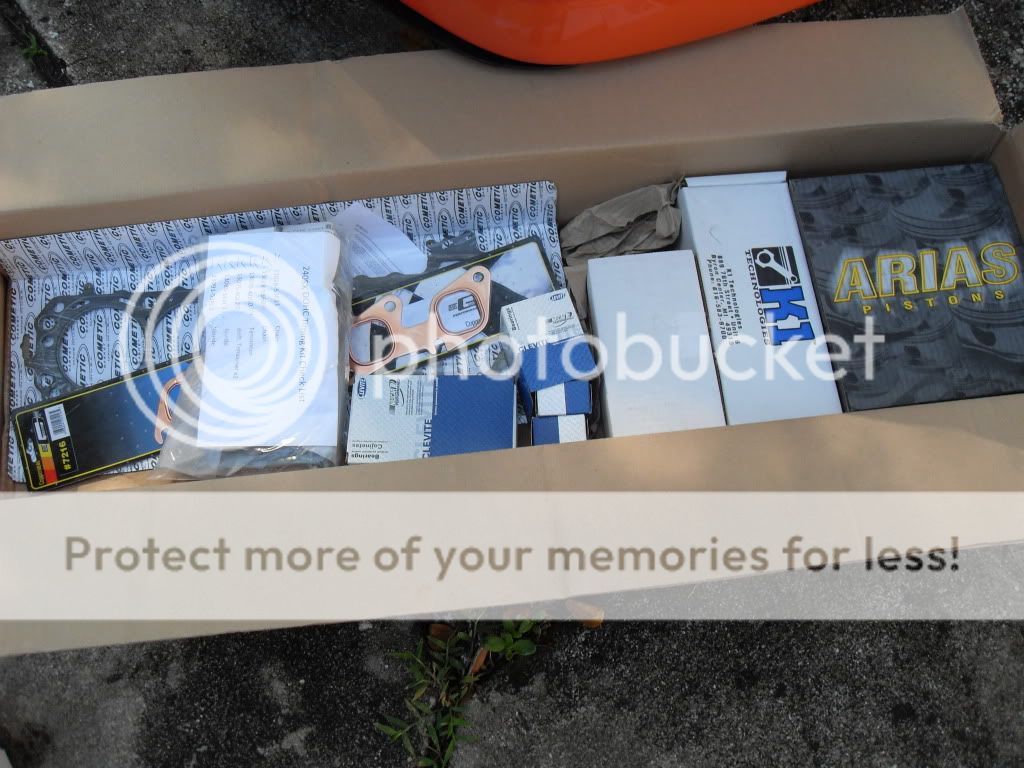

All New Parts

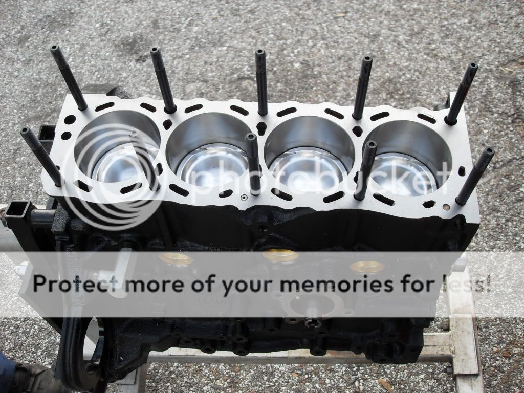

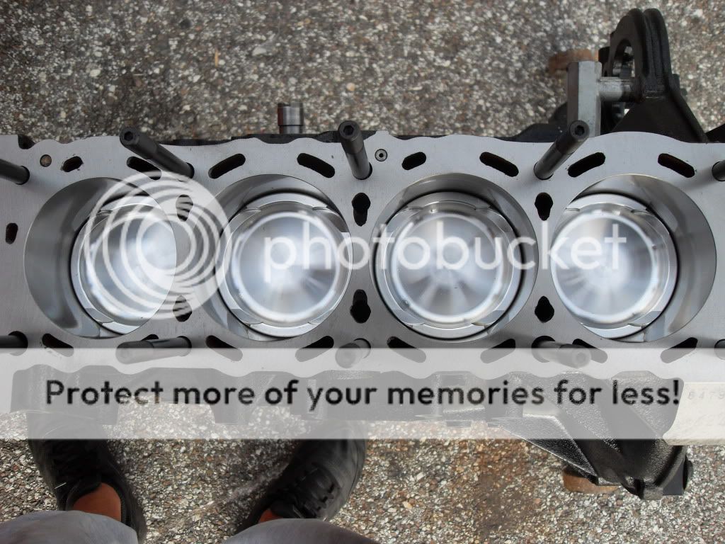

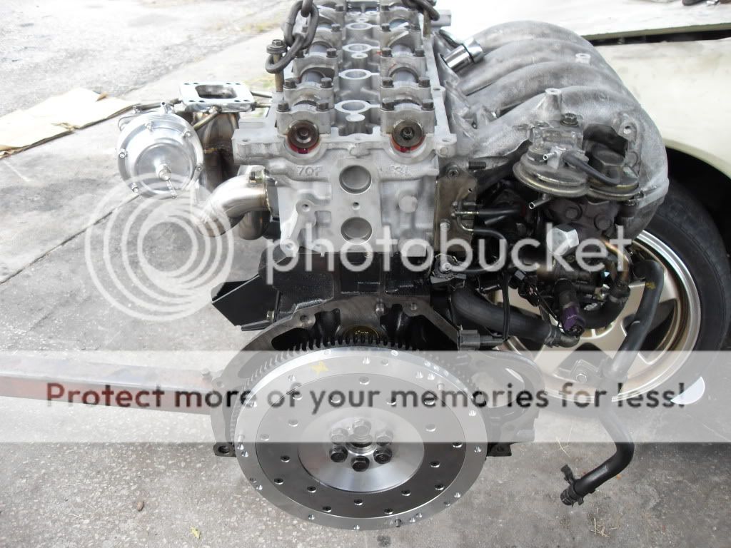

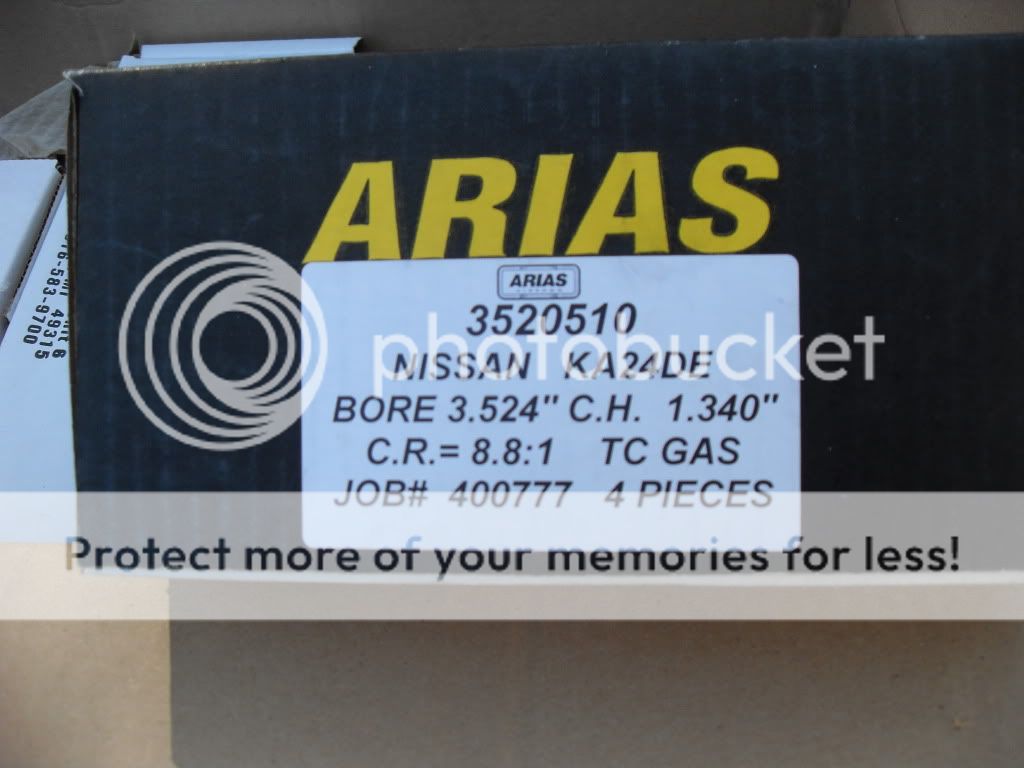

Arias forged Pistons overbored .20

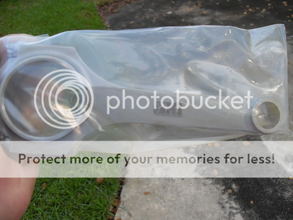

Forged K1 Rods
Motor Rebuild Kit

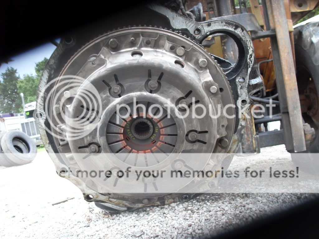

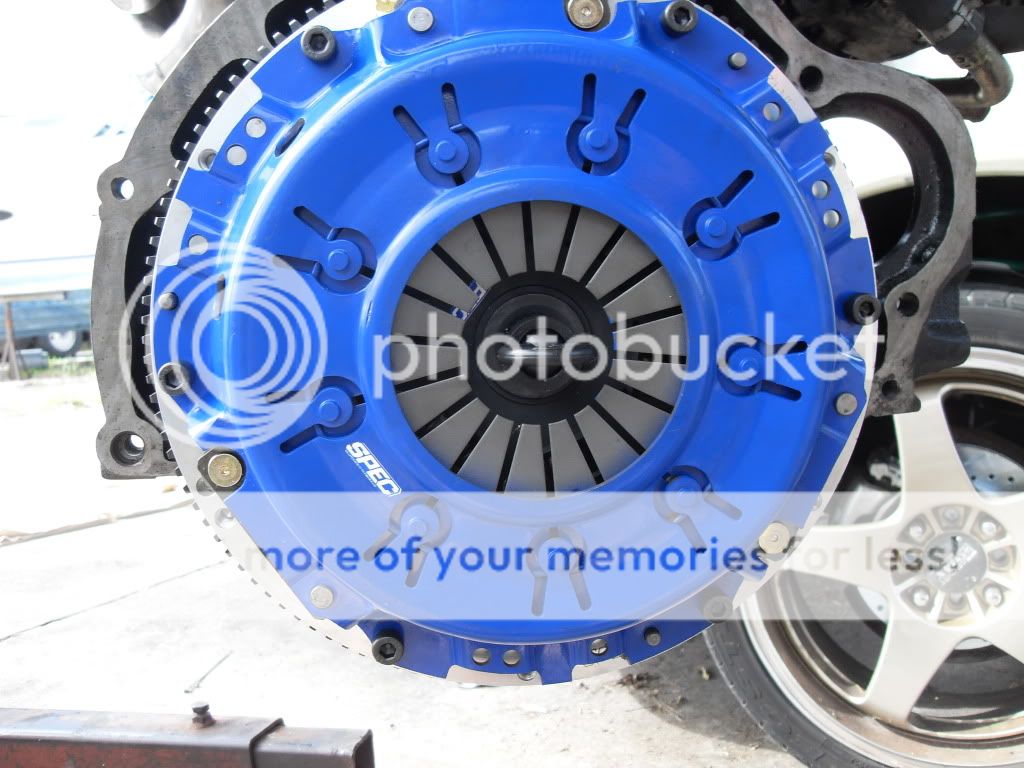

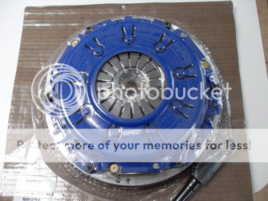

Spec stage 3 clutch and lightweight flywheel

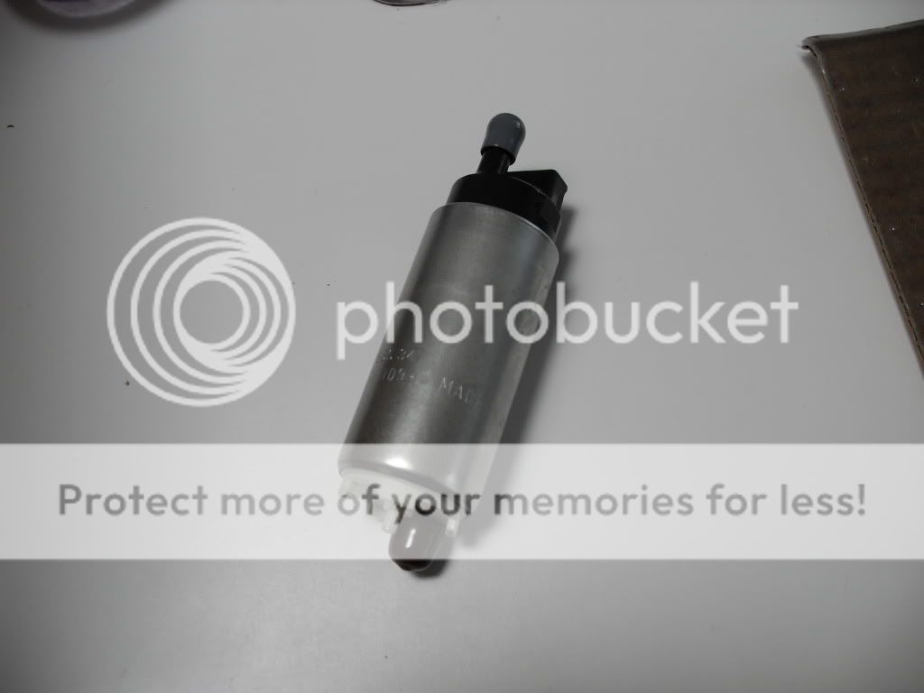

walbro 255 fuel pump

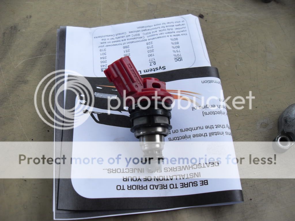

455cc sidefeed injectors

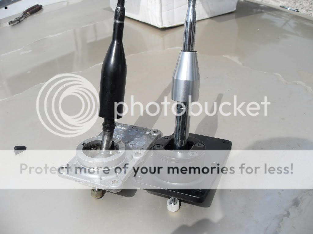

Stock shifter VS Short shifter

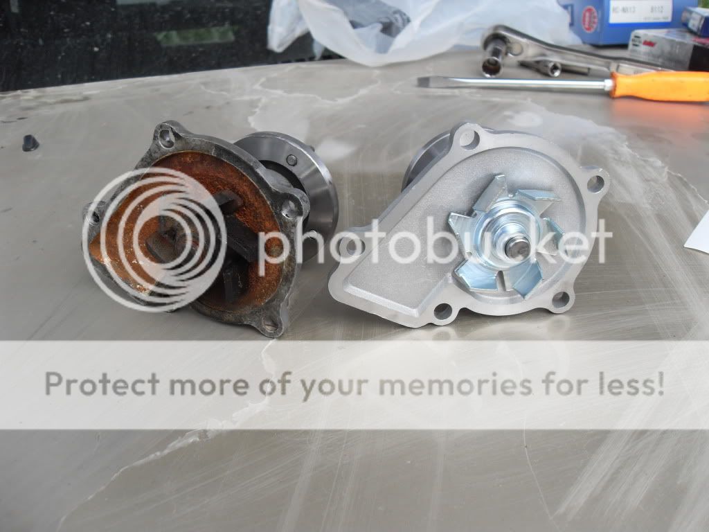

Old water pump VS New water pump

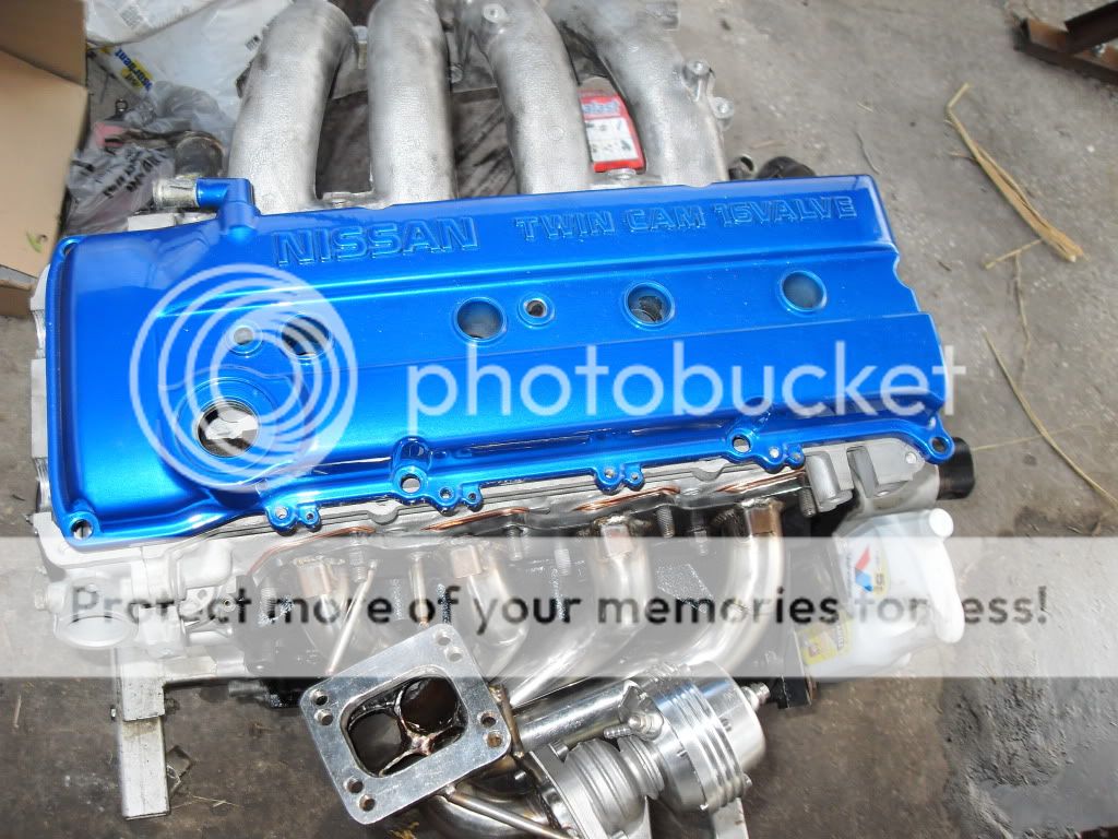

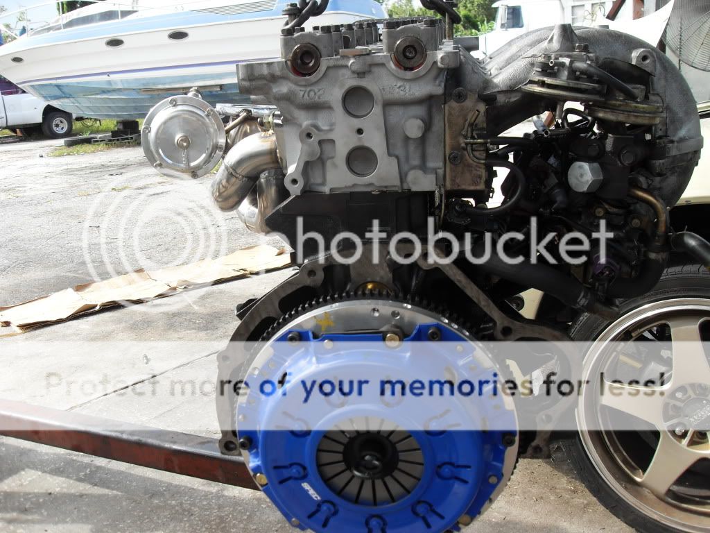

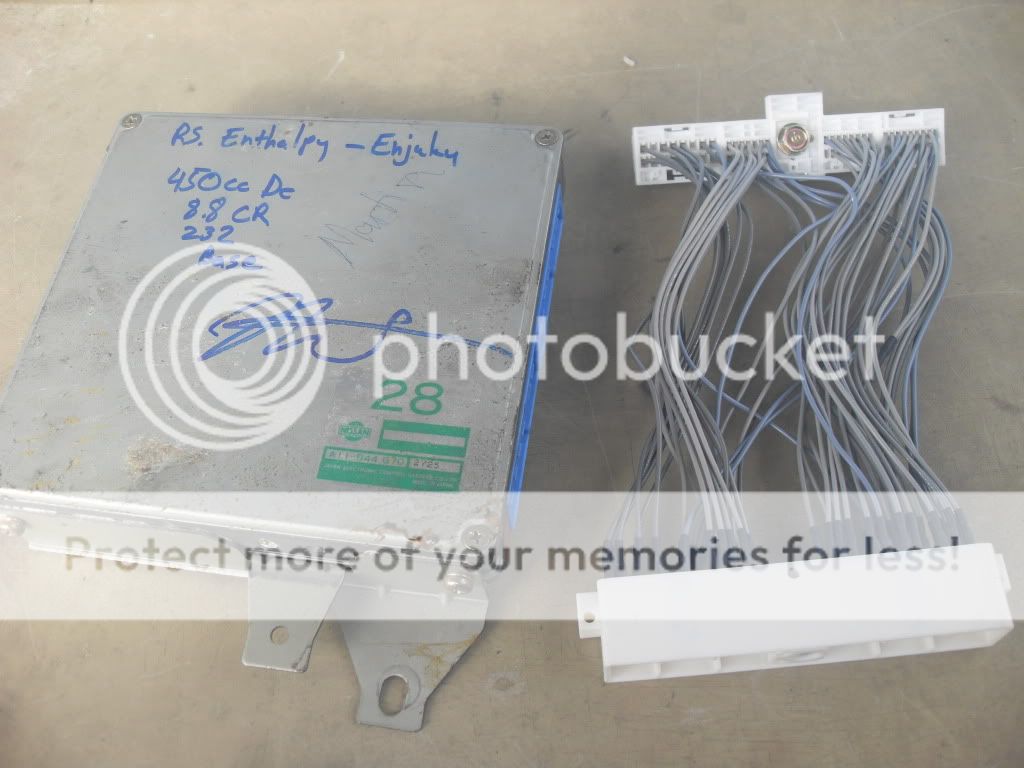

Tuned S13 ECU with adapter harness

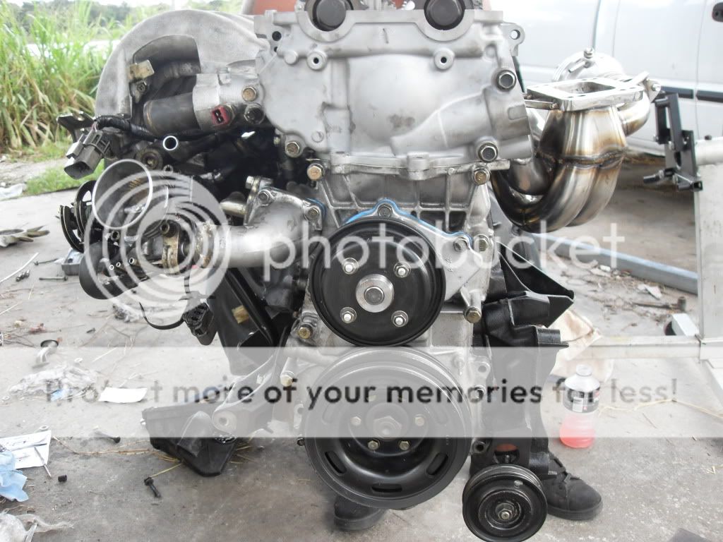

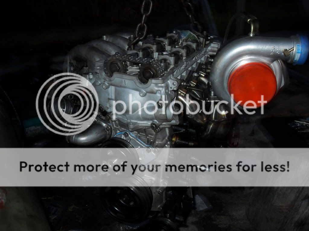

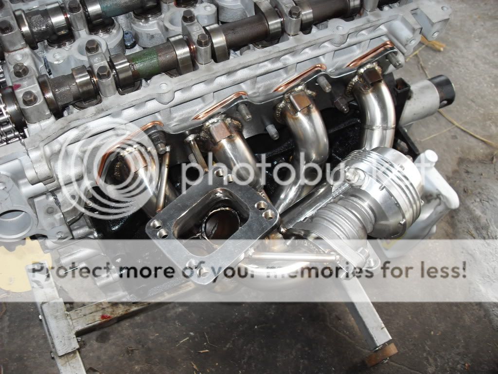

38mm Wastegate

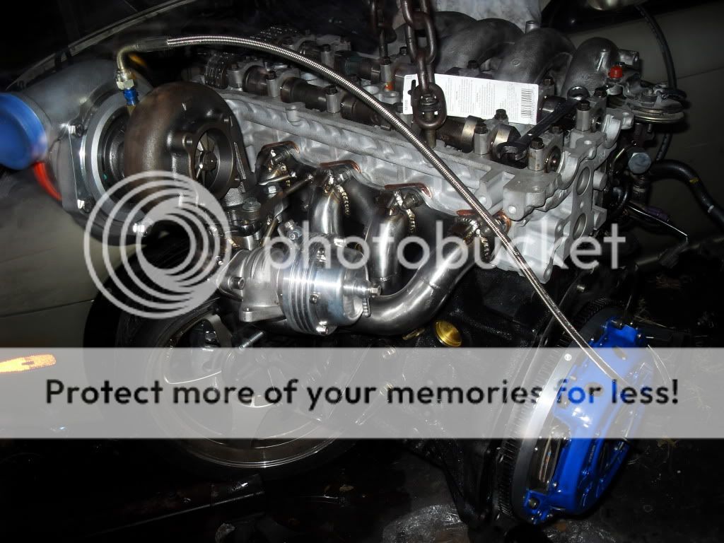

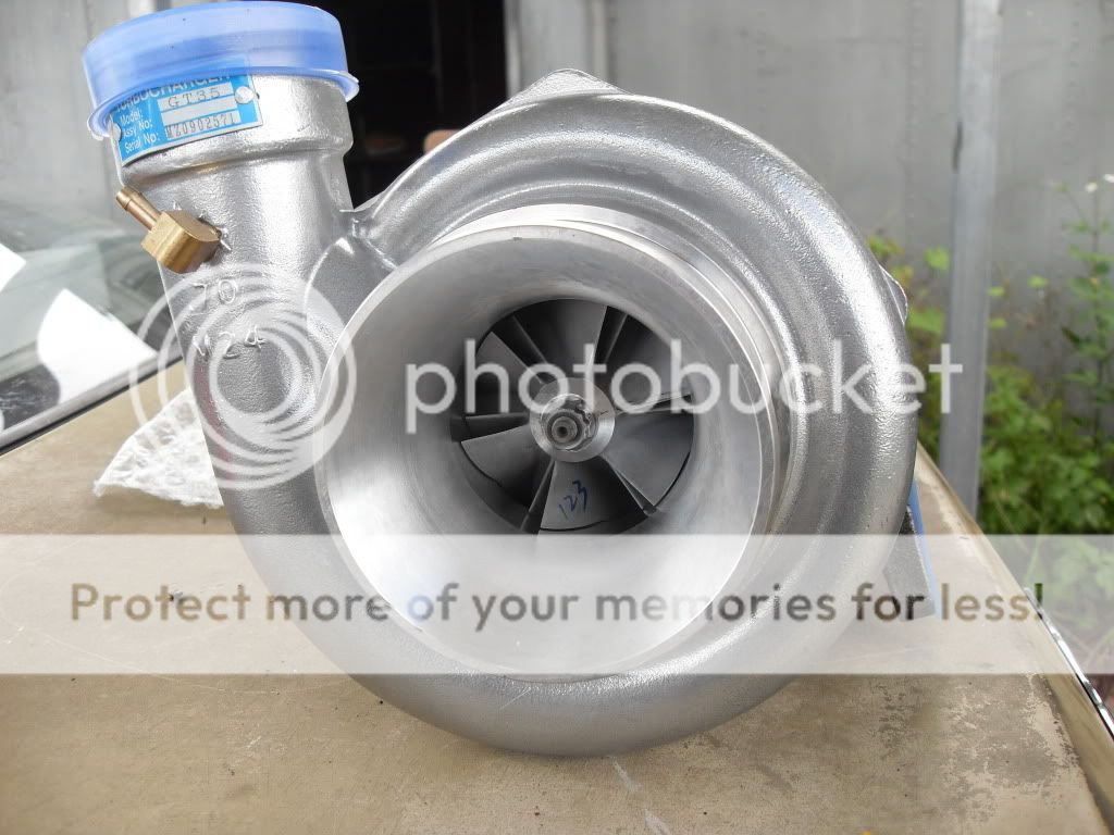

Garrett GT35 ball bearing

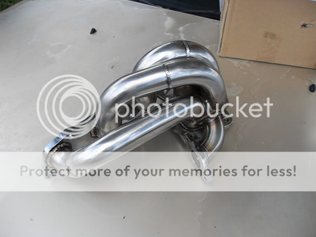

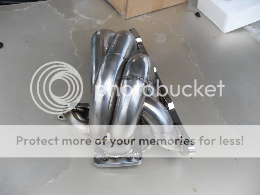

Turbo Manifold

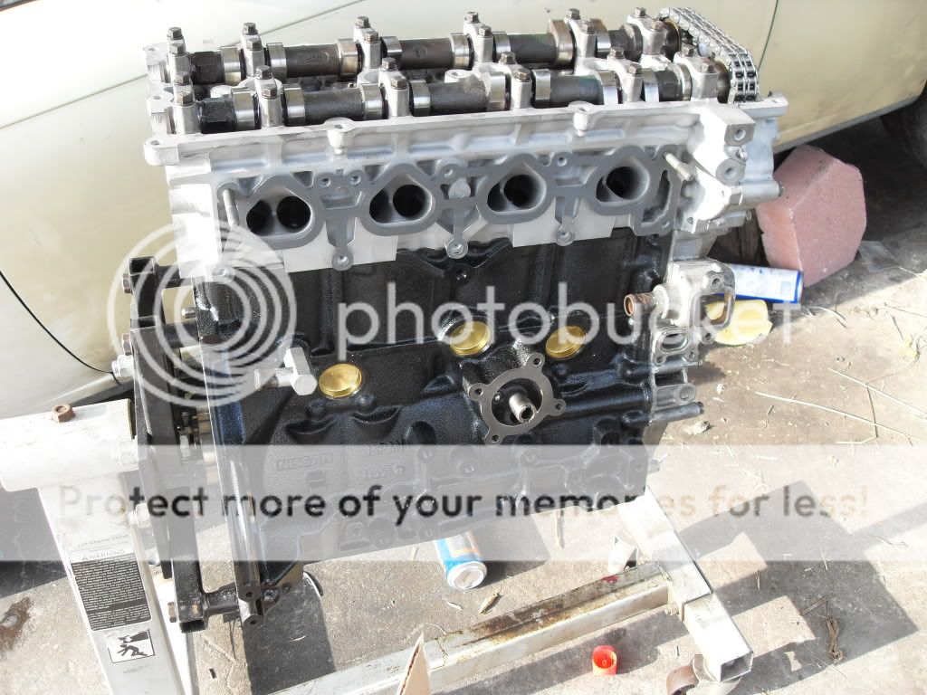

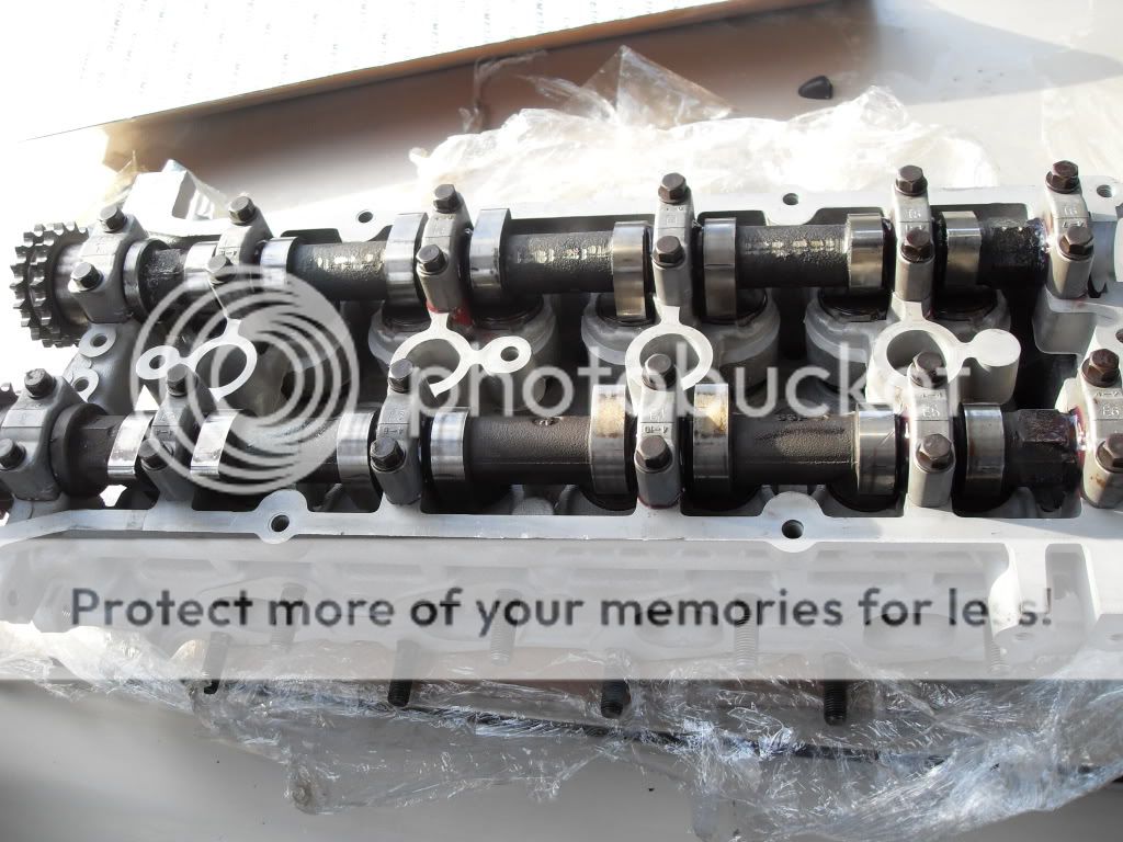

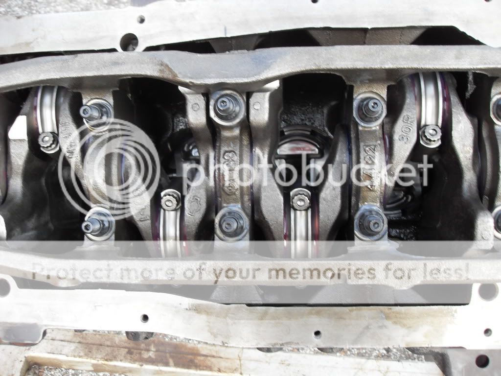

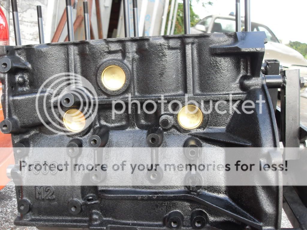

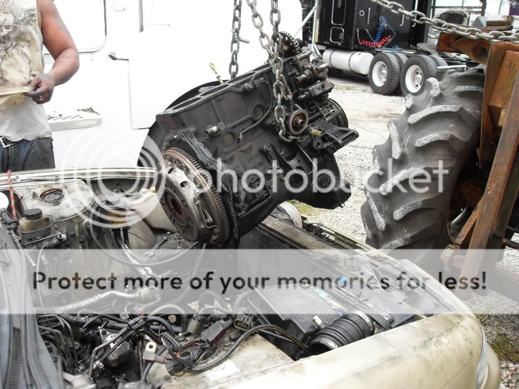

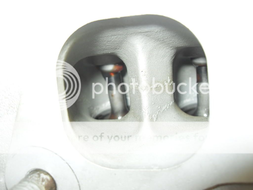

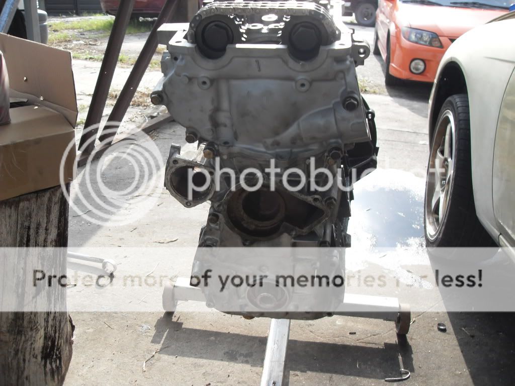

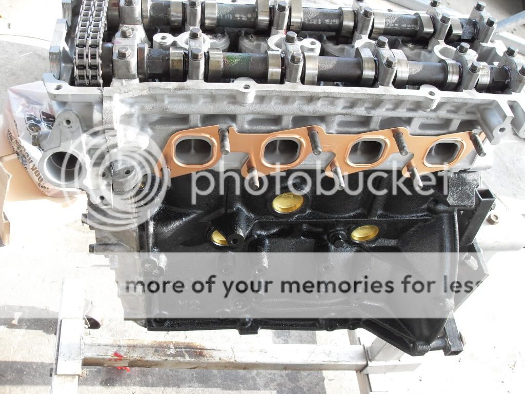

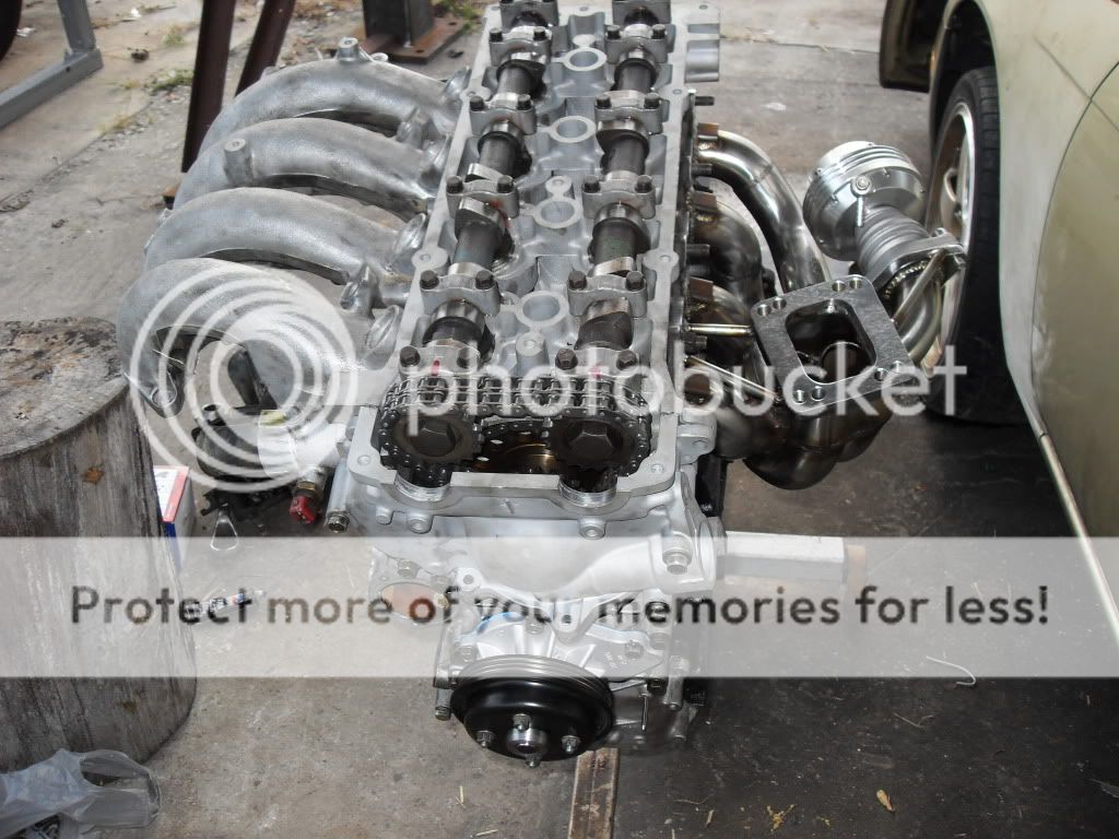

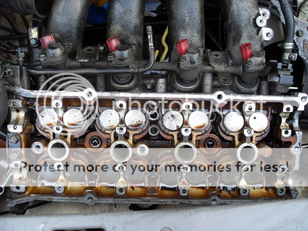

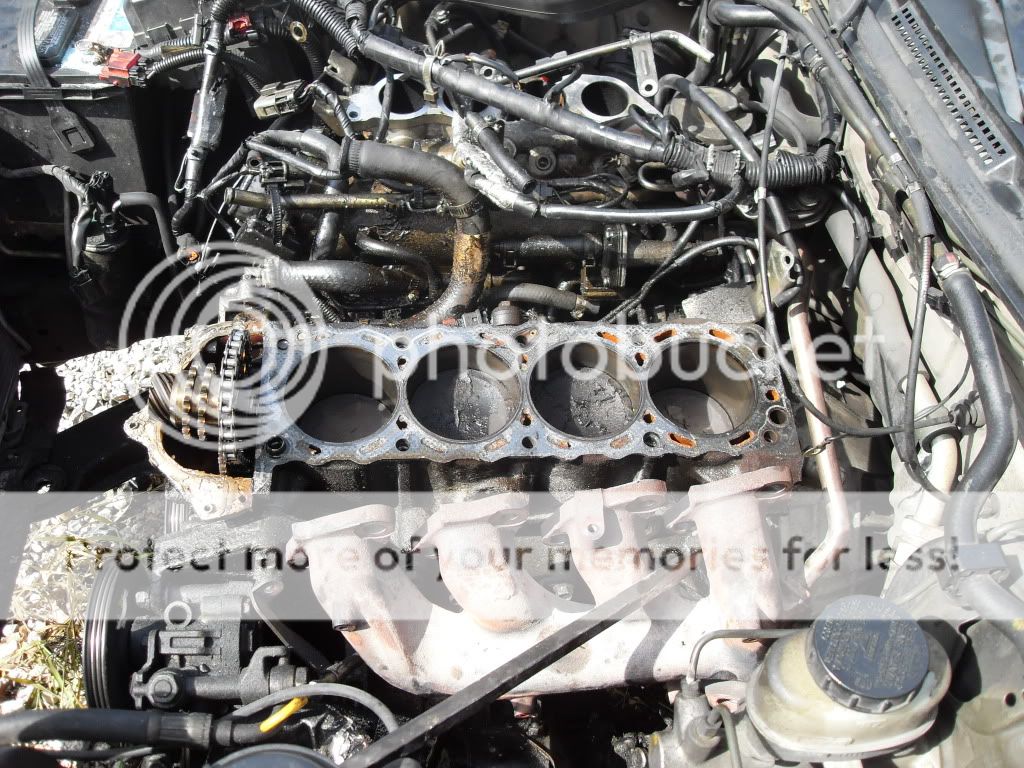

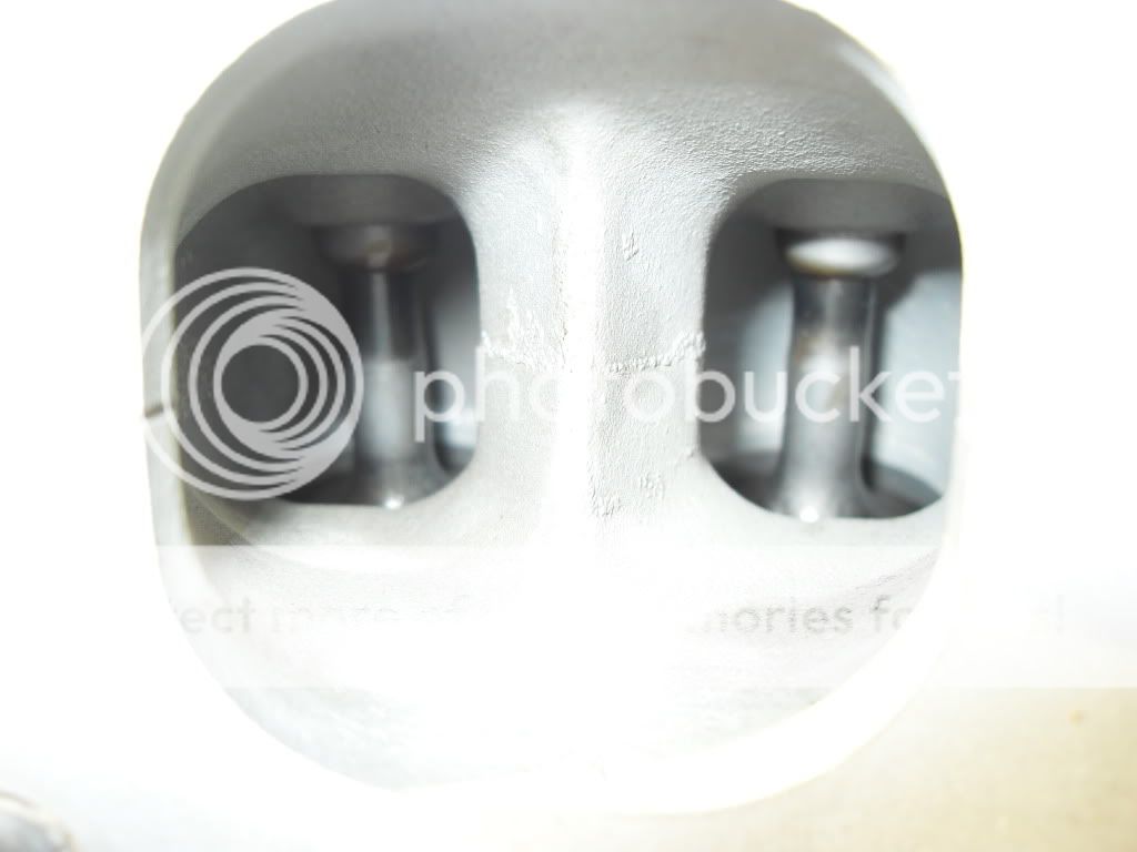

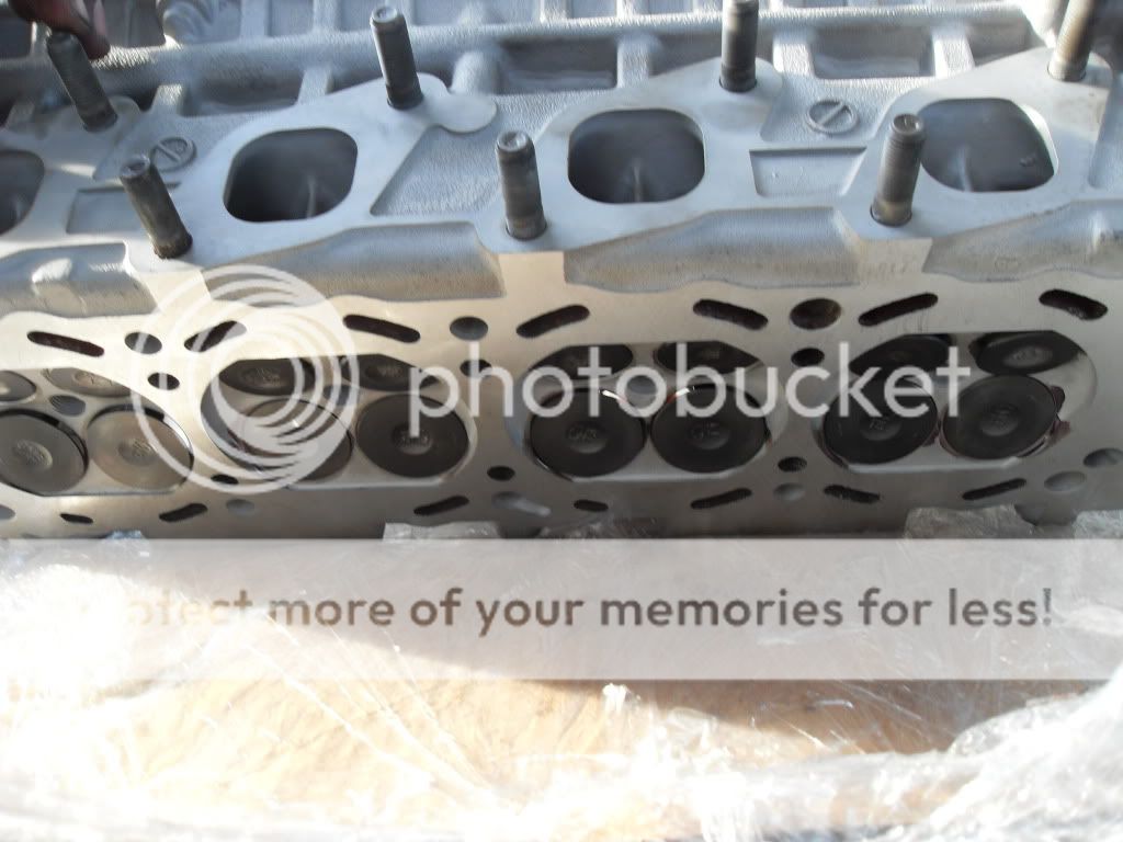

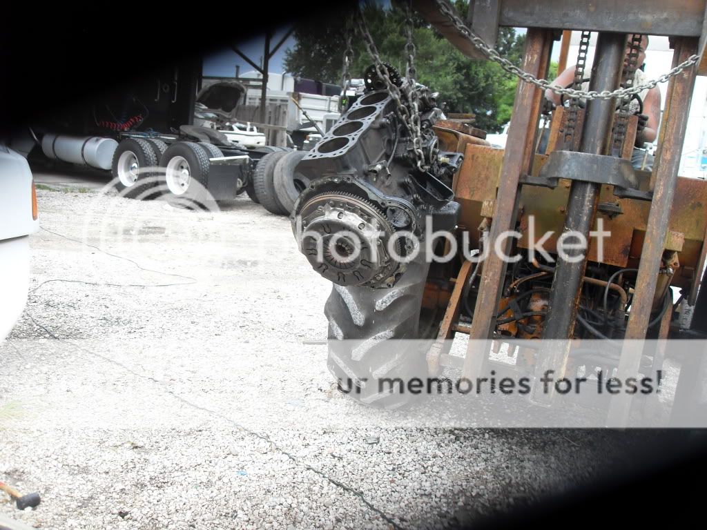

Got the block and head back from the machine shop... the head was so warped they had to shave it 11/1000 of an inch... I got a 5 angle valve job and everything hot tanked and had the cylinders overbored 20 over and the whole rotating assembly balanced
