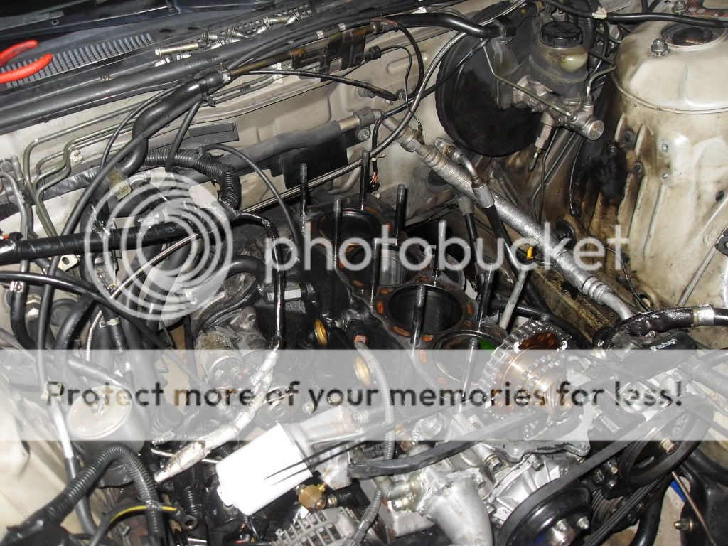

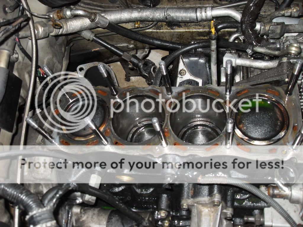

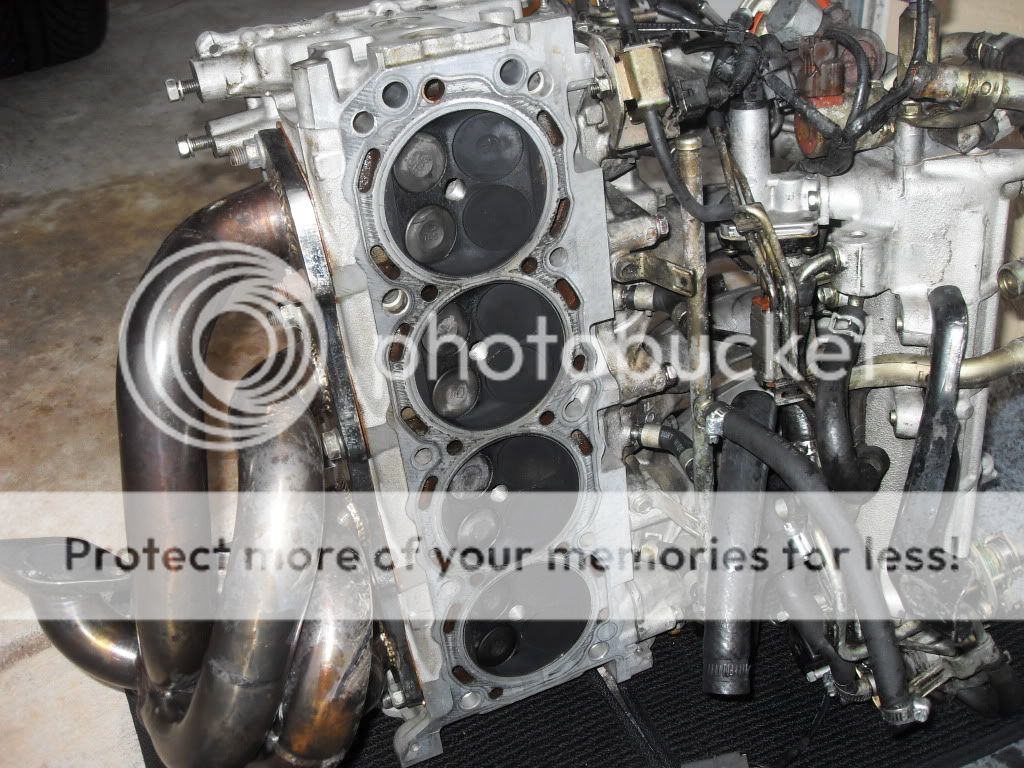

got more pics.... its of doing the head gasket
Ah man that sucks...wtf happened you figure? Doesn't look like your sending the head out. I'm surprised to see the water pockets/jackets so corroded?
cuz the kid im doing it for doesnt know much bout cars, and one of the colant hoses burst and it leaked all the colant out and it started over heating and thats how the head gasket blew. cuz the head was torqued down to specs

did you guys check the head for warping? cause if not you might expect him calling you up for another head gasket...
the kid didnt want me to take the head to a machine shop to test it if its warped even though I told him too, when I put everything back together the oil and coolant started mixing (not surprising), then I had to do it all over again and took it to a machine shop and had it resurfaced cuz it was warped .0007 inch and put everything back together.
