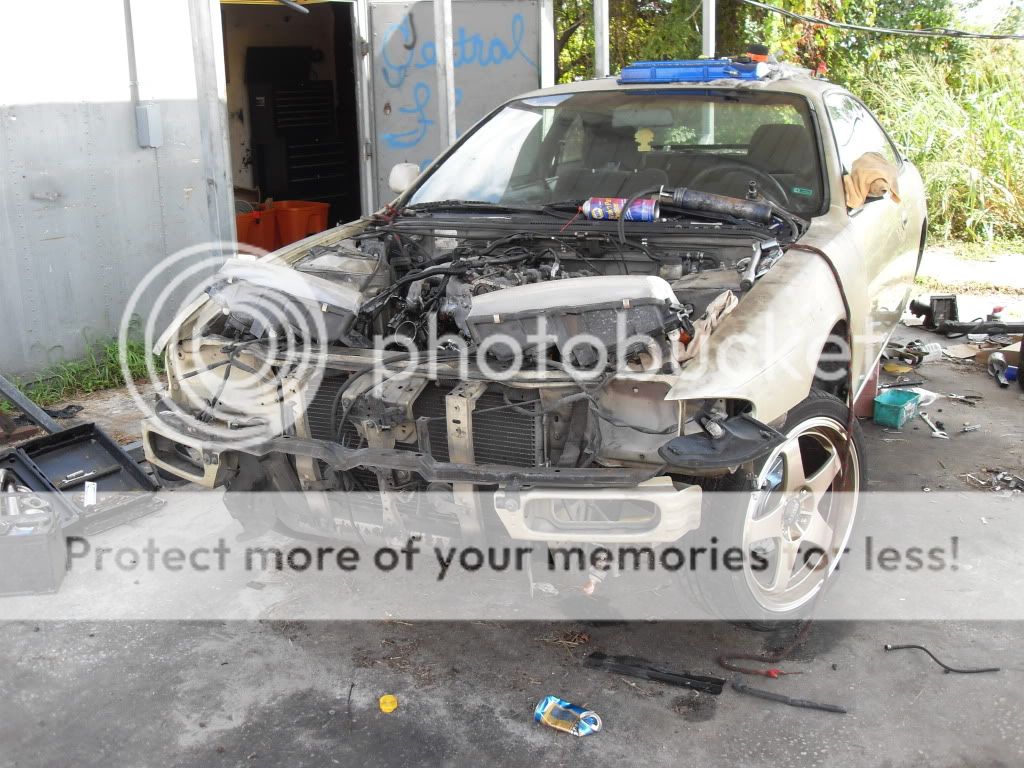

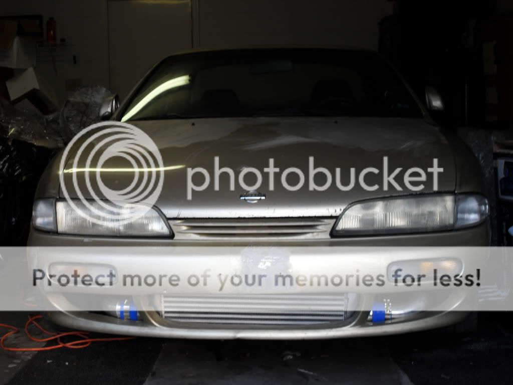

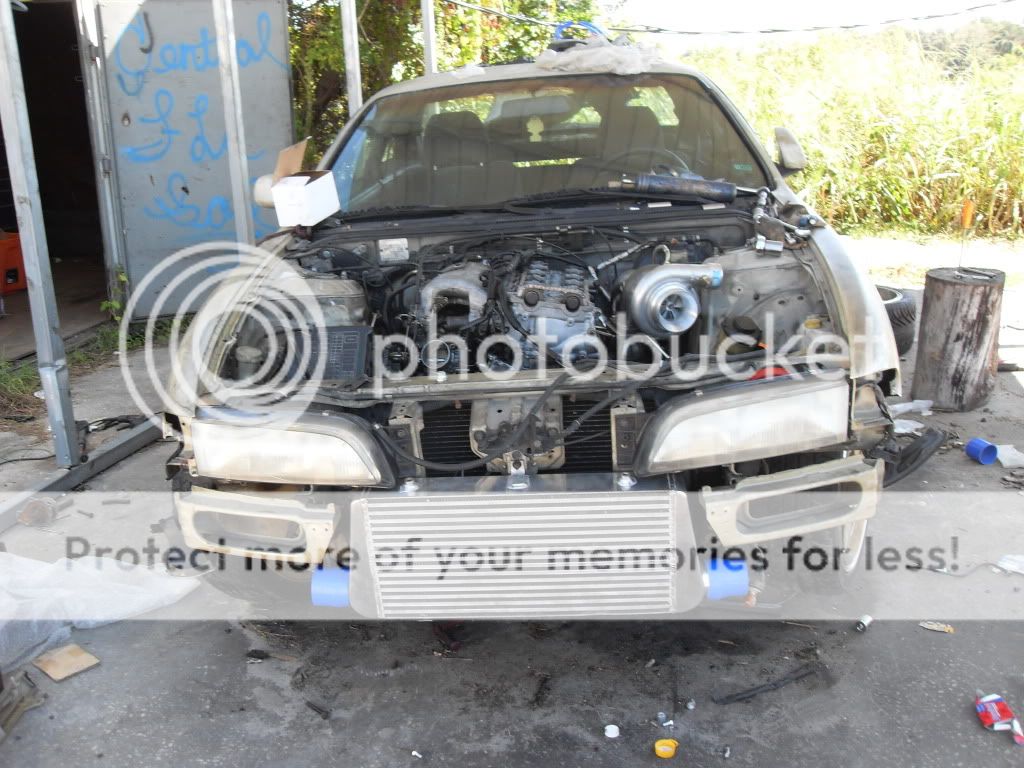

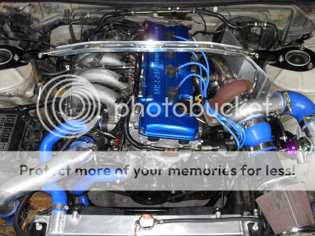

setting up the intercooler

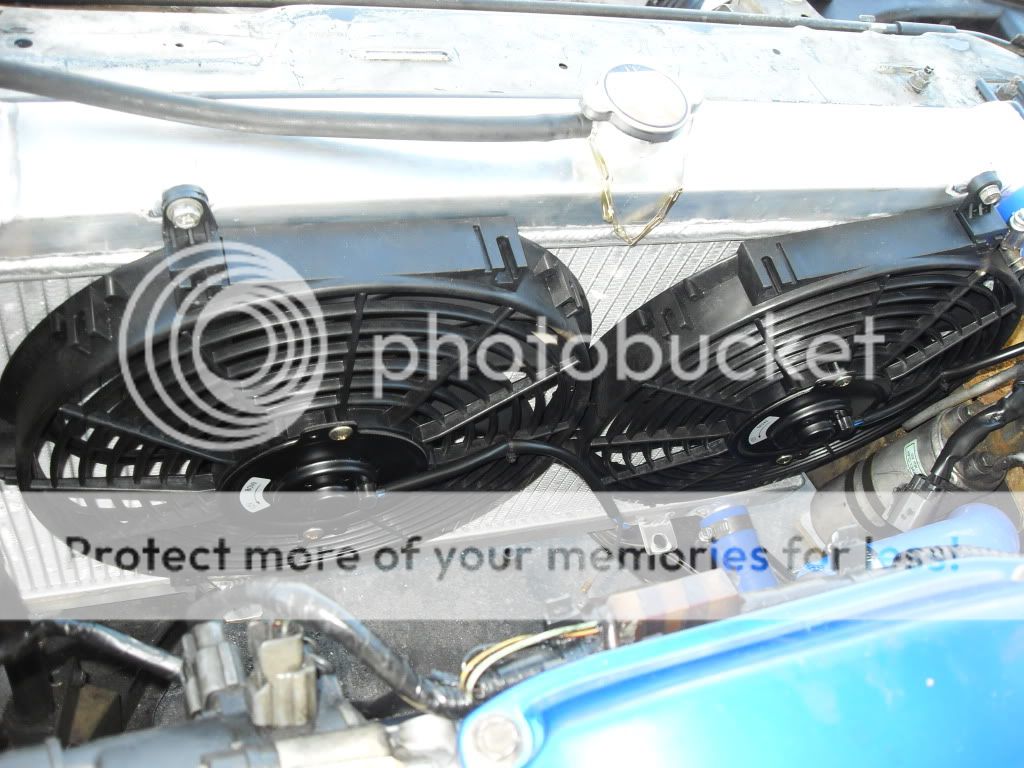

Radiator with 2 12'' electric fans
Z32 MAF
Wow that came out really really nice...your budy will be thrilled. Great job!

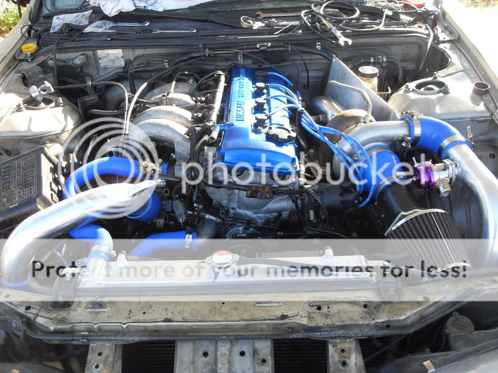

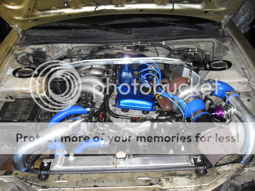

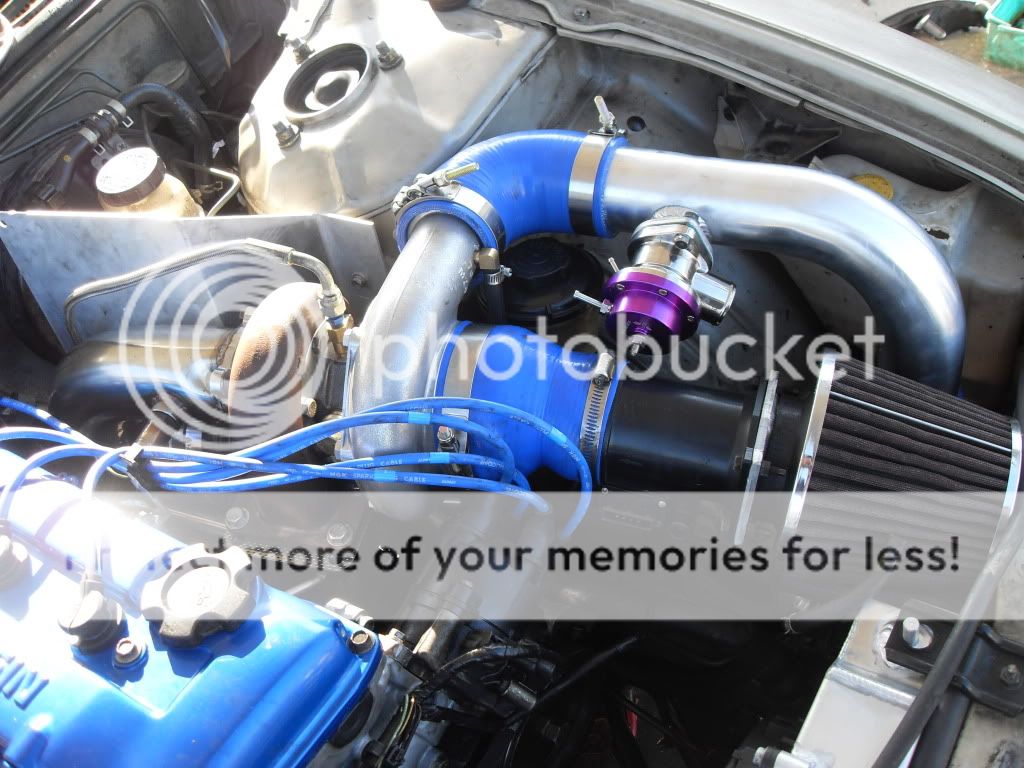

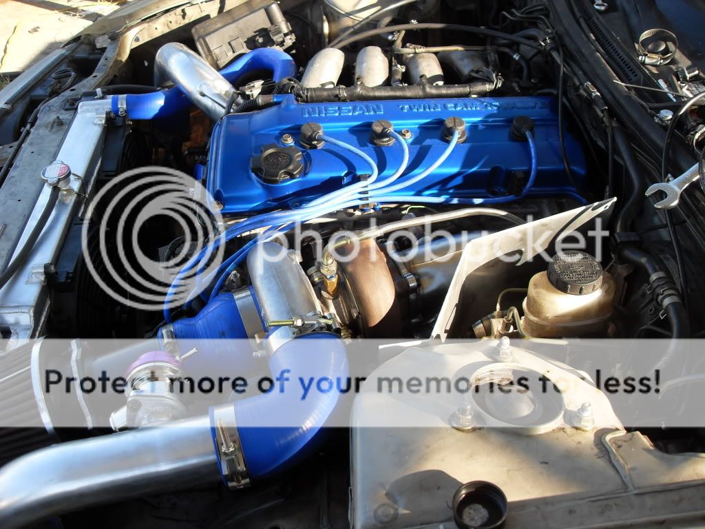

My mechanic has a similar set up on his 240, he's had issues with the heat generated from the turbo in that location...fire proof and fire sleeve everything in that area.
yea for some reason it produces an extreme amount of heat more then I even expected thats why I had to put that heat shield there so it wont melt the master cylinder, also its burning the hood cuz I think its touch and burning it so I gotta cut a hole so it wont catch the hood on fire lol
