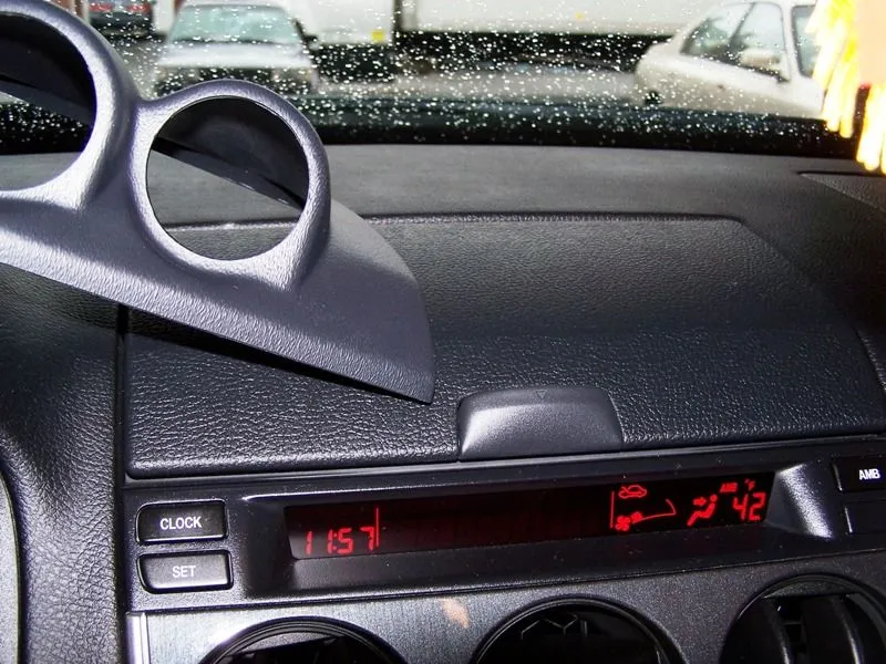

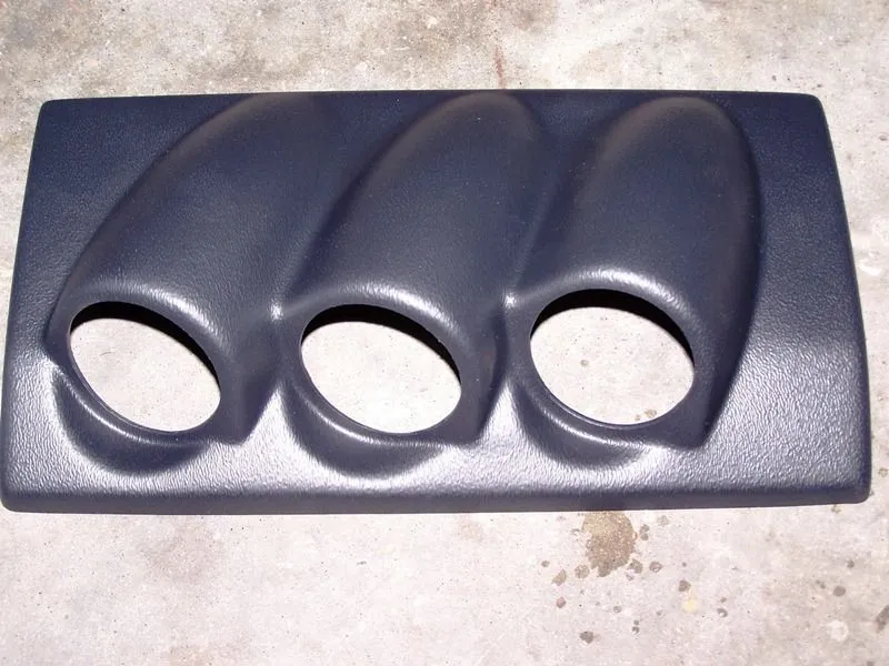

I'm going to Install these.
Boost Gauge
Air Fuel Ratio
And Oil Pressure
Wish me luck!!!

Looks like a lot of fun. You should take a lot of pics and notes on what you do this would be a great how to and if it is good I will pin it for all to enjoy.
Make sure to show how all the gauges get wired and installed into that pod. So get to work and have fun with the writeup if you want.

kick ass. I love mine. the only thing I don't like about it is how you have to remove the door, but everybody that gets in my car loves the gauge pod. Just need to get some more gauges.
How do you get the wires back there? Is there somewhere you can get them through from underneath the steering wheel? Also, I heard you have to remove something so that it is never possible to convert back to the stock door there. Is that true?

yes yo have to removed the door, which is probably damn near impossible to put back on. I drilled a small hole in the back bottom corner of it to route the wires through.
Is there any other possible way to get the wires through without drilling a hole? I saw a tutorial once that made it look as though there was already a passage behind that compartment, but it was for the regular 6. Would it be the same for the MS6? Does anyone happen to have a picture of the compartment removed?

Here is what I did. I taped three wires off of the stereo harness (harness on the bottom going into the stereo.
Routed the wires and tube between the air vents. drilled a hole in the bottom left corner of the pocket (the pocket carpet still covers it)
