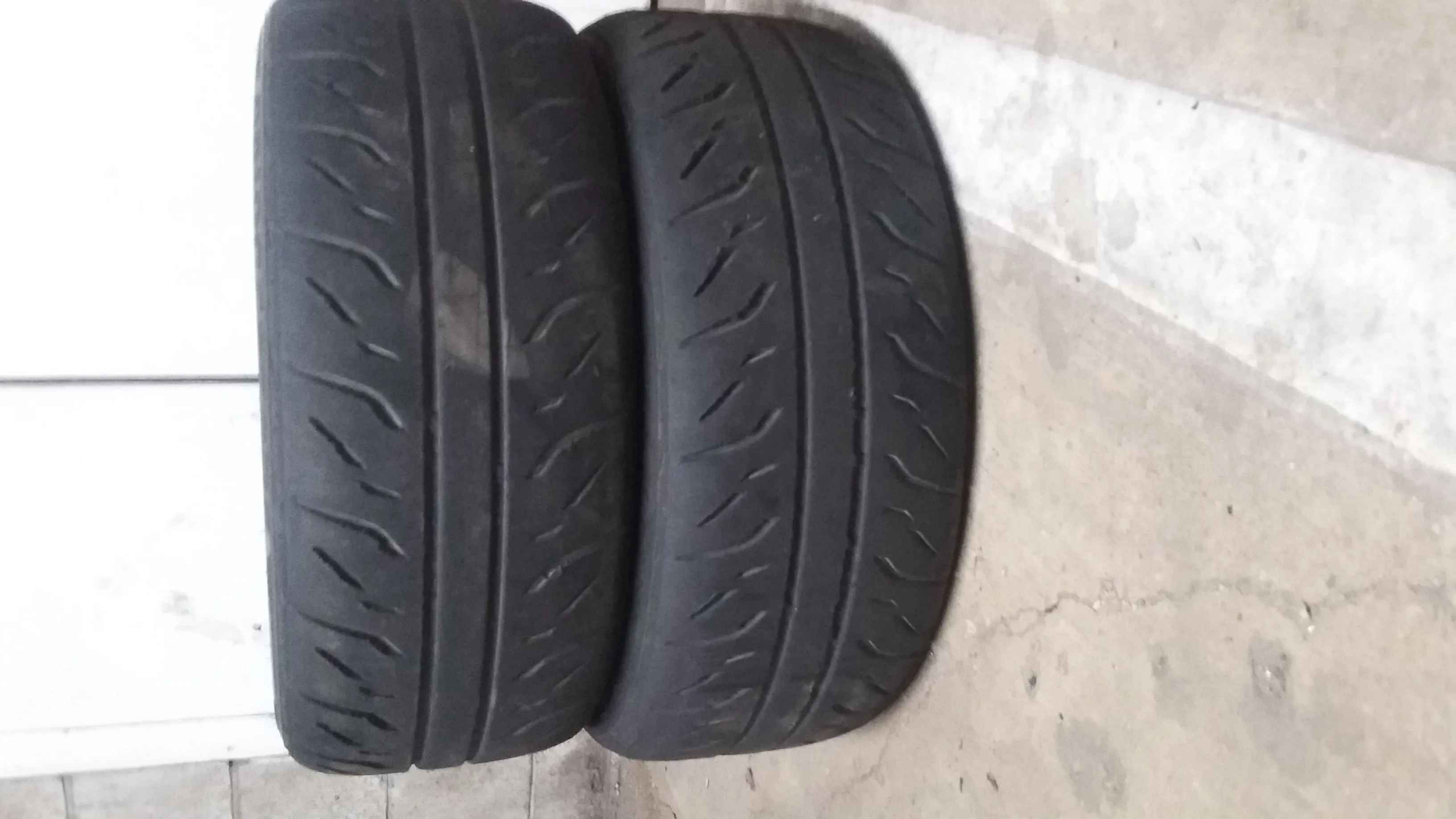

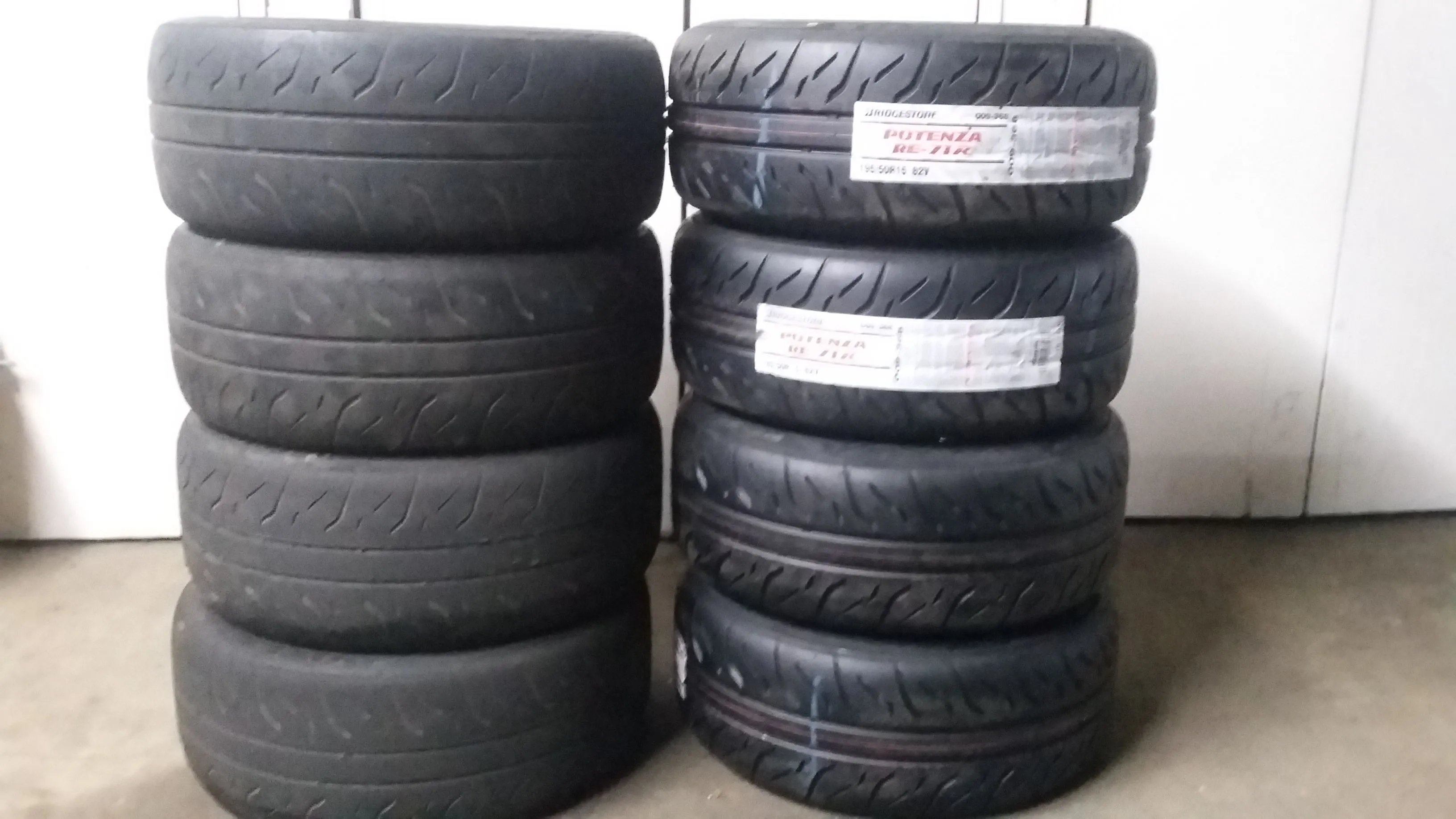

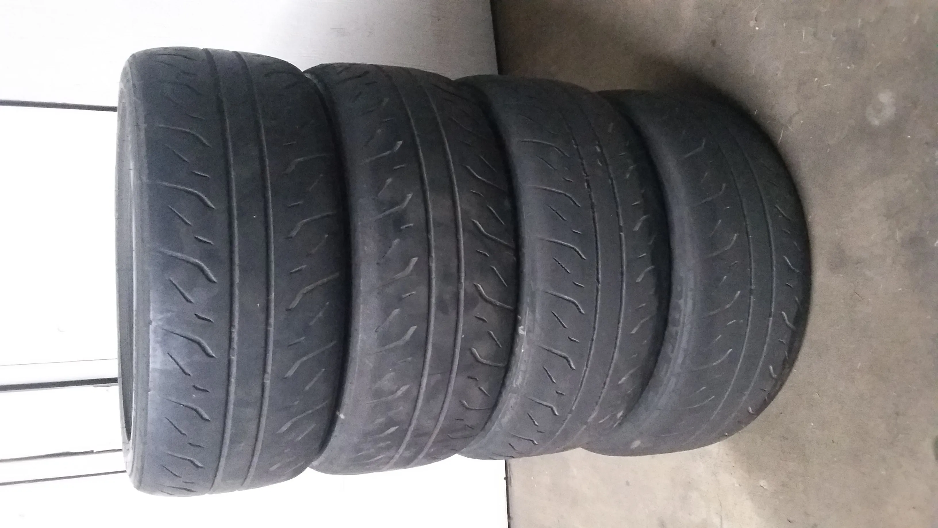

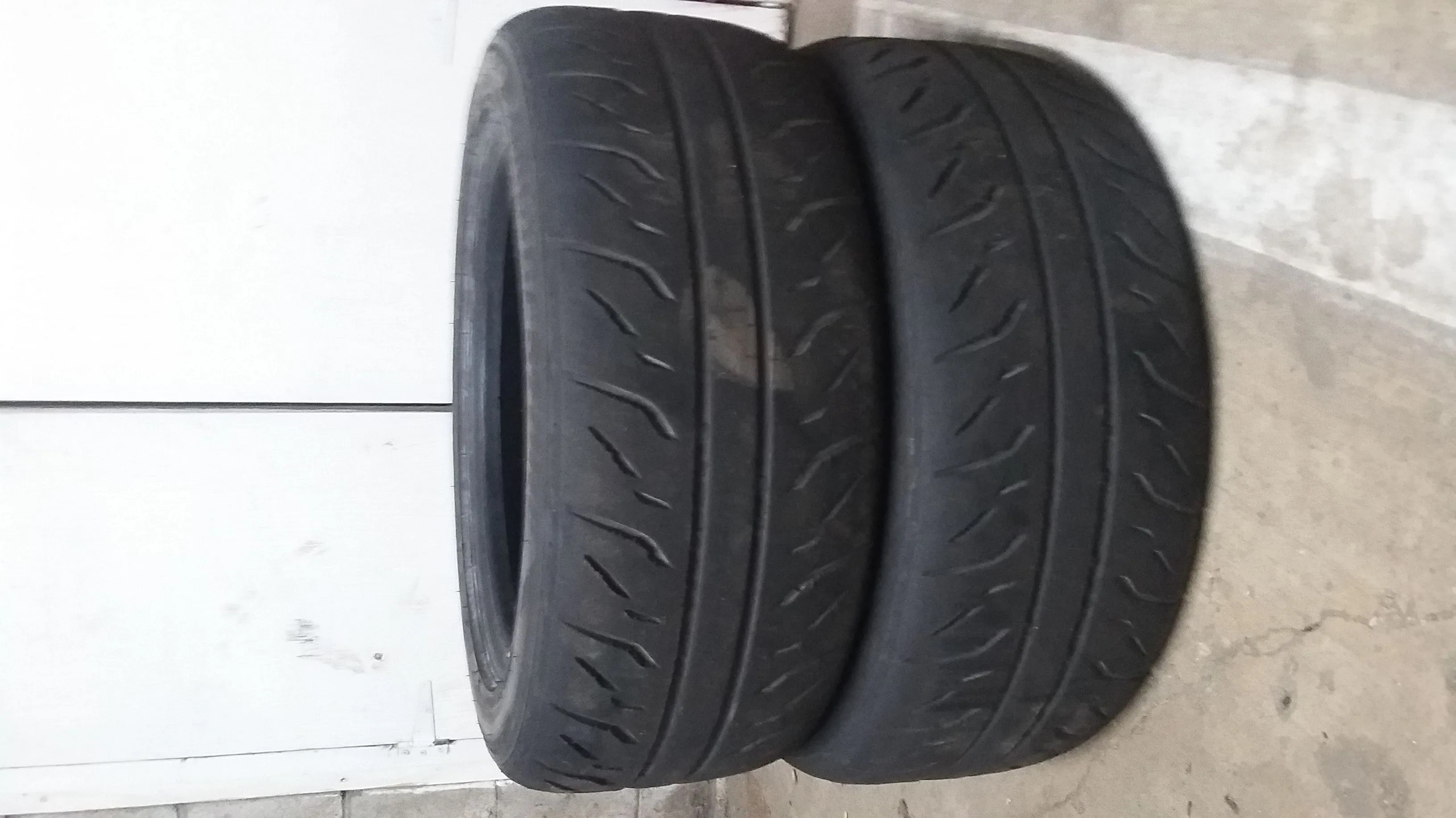

New tires for 2016 old for sale
Not selling very easy so is part out time, items included:
