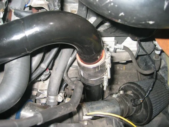

Here are some pics of my new setup. Wish that I had dynoed it before I made the changes becaused it would be nice to know how the setup changed the flow and power of the motor. Especially since I change two things during this round of tinkering.
Background: Previously, had all 2.5" piping for the intercooler and the MAF was in its pull-thru position on the CAI. I recirculated with the stock BPV without a second BOV venting atmospheric. The last mod prior to this change was the custom 3" J-pipe. I had noticed great response and top-end gains (all via butt-dyno) with this change. I was concerned about a 90 degree bend immediately prior to the FMIC since the 2.5" was a tight fit and I hadn't wanted the frame cut. I wanted to change to 2.5" piping that had a more natural path to the FMIC inlet.
Changes made: 2" mandrel-bent piping (turbo-IC) now routed underneath the frame rather than in front of the rad. MAF moved to the pressure side, ~12" after the outlet for the BPV and ~12" before the TB. IAT wires extended and IAT left adjacent to CAI in bottom of engine-bay.
Impressions: After resetting the ECU, the car ran perfectly. No hesitations, no stalling at stops. It ran smooth as stock. It also spooled faster (likely the change to the piping diameter). AFRs stayed the same at ~14.x. EGT was about the same, perhaps a bit lower. However, it felt like it had lost some power. Accelerating under WOT did not feel as frenetic or angry. Pipes causing this or MAF position? I suspect both. However, when I thinik about the MAF position a bit more I suspect the MAF more than the piping, and I think that the ECU may be pulling timing.
Granted, all the air that is in the system is measured by the MAF in this position. However, now that the air is moving by the sensor quicker it is more likely to cool the element (MAF uses temp differential between IAT and MAF to determine airflow) than slower moving air in the CAI. My FMIC is pretty efficient so the IC-TB air is pretty cool to begin with. The pressurized flow only exacerbates this issue. With the IAT in the stock position, the gradient in temp between the MAF and IAT is now alot larger than it otherwise would be. I haven't checked the MAF voltage under WOT, but I bet that it reaches max long before WOT now.
I haven't read the whole thread so it may have been said before, but I bet that moving the IAT to the IC-TB pipe somewhere before the MAF would alleviate the problem to a large degree. I am not sure how the IAT sensor would stand up to the pressurized flow, but the temp gradient would be less steep and the MAF would be less likely to intervene.

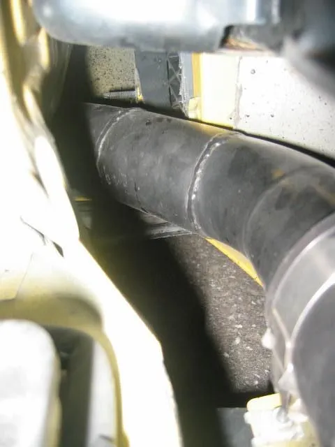

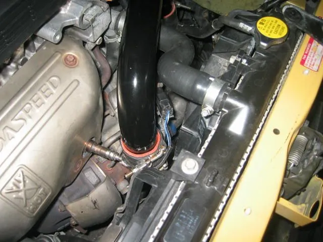

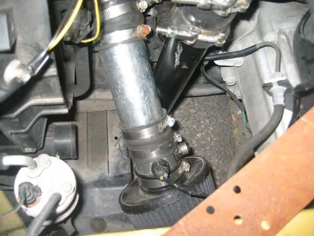

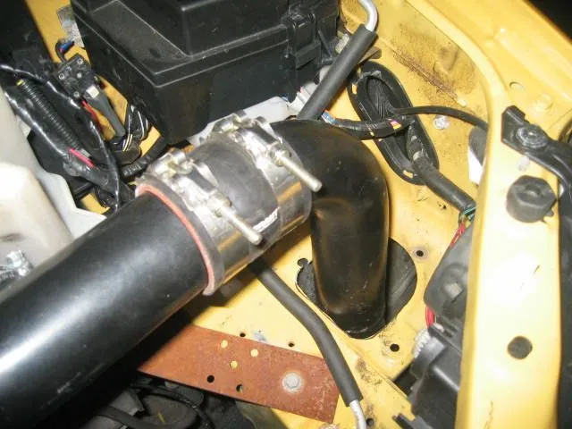

1. 2" turbo-IC pipe
2. as above running down behind CAi
3. CAI with IAT
4. 2" turbo-IC pipe as it peeks up from underneath frame and curls around to IC inlet
5. IC-TB pipe exiting FMIC

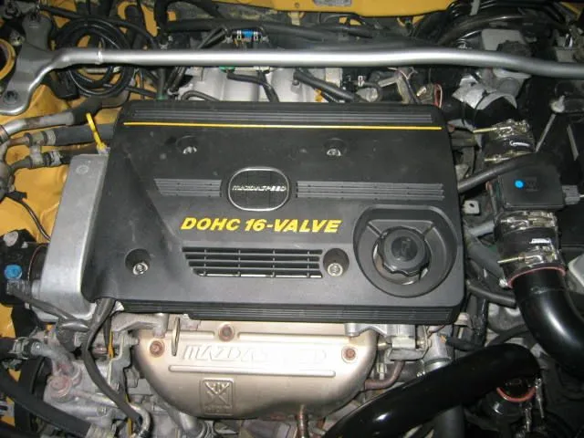

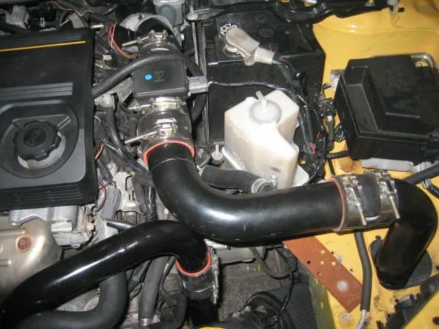

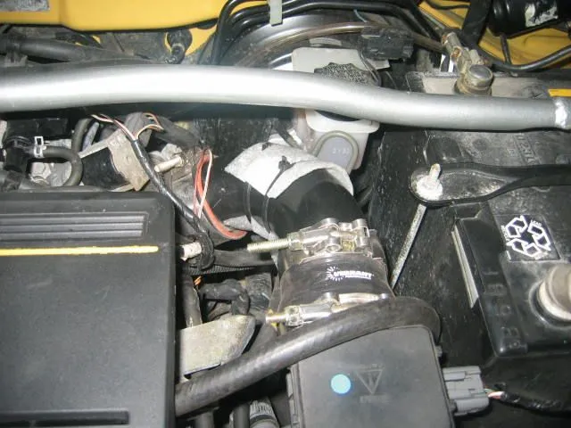

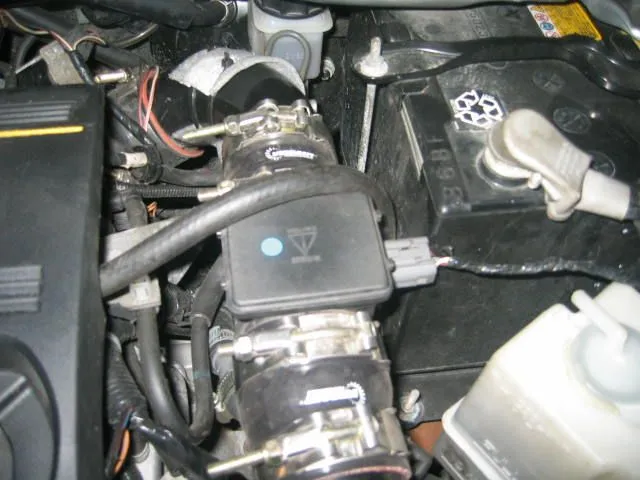

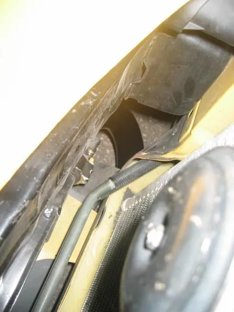

More pictures
1. IC-MAF pipe coming up through fender well. Note that the frame was cut here a bit.
2. as above showing MAF connection
3. MAF connection
4. MAF-TB pipe
5. engine bay snapshot

BTW I am also building a larger MAF to see whether this will help matters.

You gave me an idea. No drilling required (at least not in my hardpipes). Check out pic 1 in my second set of pics. There is a connection right after the pipe comes out of the fender well. If I inserted a short piece of pipe (it could even be high pressure PVC piping as suggested in Autospeed for a rebuilt MAF) I wouldn't have to do massive modifications to my setup. Here the sensor would then be sensing air before the MAF that was also pressurized, rather than unpressurized ambient air. This air (leaving the FMIC) would already be cool and moving at speed, but the IAT would read this as ambient. Then when it read the temp at the MAF the temperature differential between the IAT and MAF would be less. In addition, the differential would be solely because of engine demand for oxygen/air since the air at the IAT and the MAF are both pressurized, thus moving at speed, therefore allowing the speed of the airflow attributable to the turbo alone, to be ignored since it is represents a baseline flow present at both sensors. s***, that is a mouthful. Anyway, now that I've found a place for the sensor, I just got to do it.
Of course, if my MAF upgrade experiment is successful, I could simply extend the length of the MAF body to include a port for the IAT sensor, before the MAF heating element.
