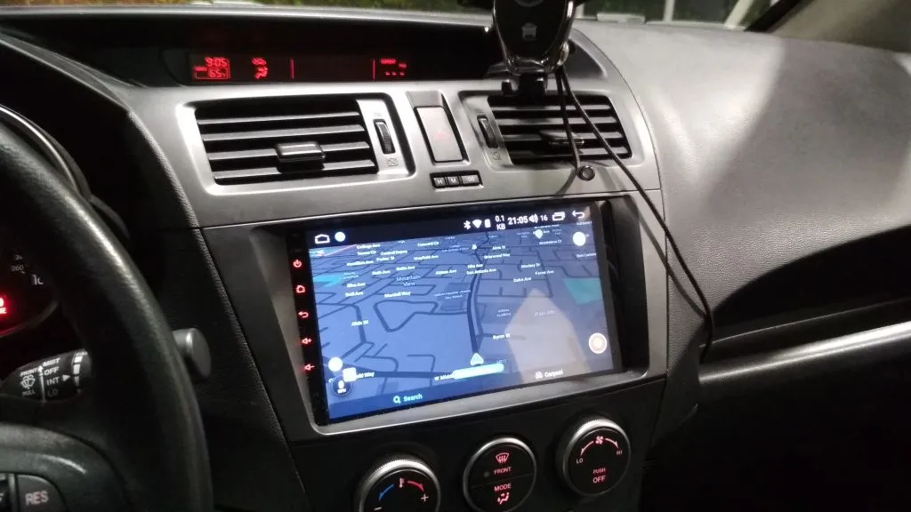

On a side note, I'd like to use this opportunity to flex 9" android head unit, see attachments. Sharing my experience: if you ever go aliexpress way, better stick with popular brands that have community, firmware support, etc. I purchased "otojeta", which is a rebranded "idoing" and I'm quite unhappy with overheating, lack of mounting hardware, minimal support and crippled canbus adapter.
Think about aliexpress android units more like as of "DIY kits" than a product.

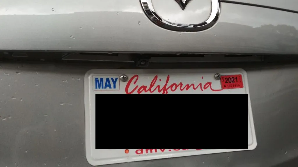

On a positive note: I would definitely recommend this particular https://www.amazon.com (commissions earned). This is not my first installation and these are cheap, they come with an easy to fish cable (round barrel connector) and the picture quality is awesome. Also, you can disable parking lines, which I did, as my head unit has adjustable parking lines.

Yes, I've seen that post. Seems like everybody has Mazda 5 sport - without the BT unit and call control buttons. I think the extra buttons are somehow wired through the BT unit which I've just disconnected.
The factory BT unit is not retained in my setup. All controls are passed through CANBUS.
Feel free to start a new thread with your particular setup/issues.

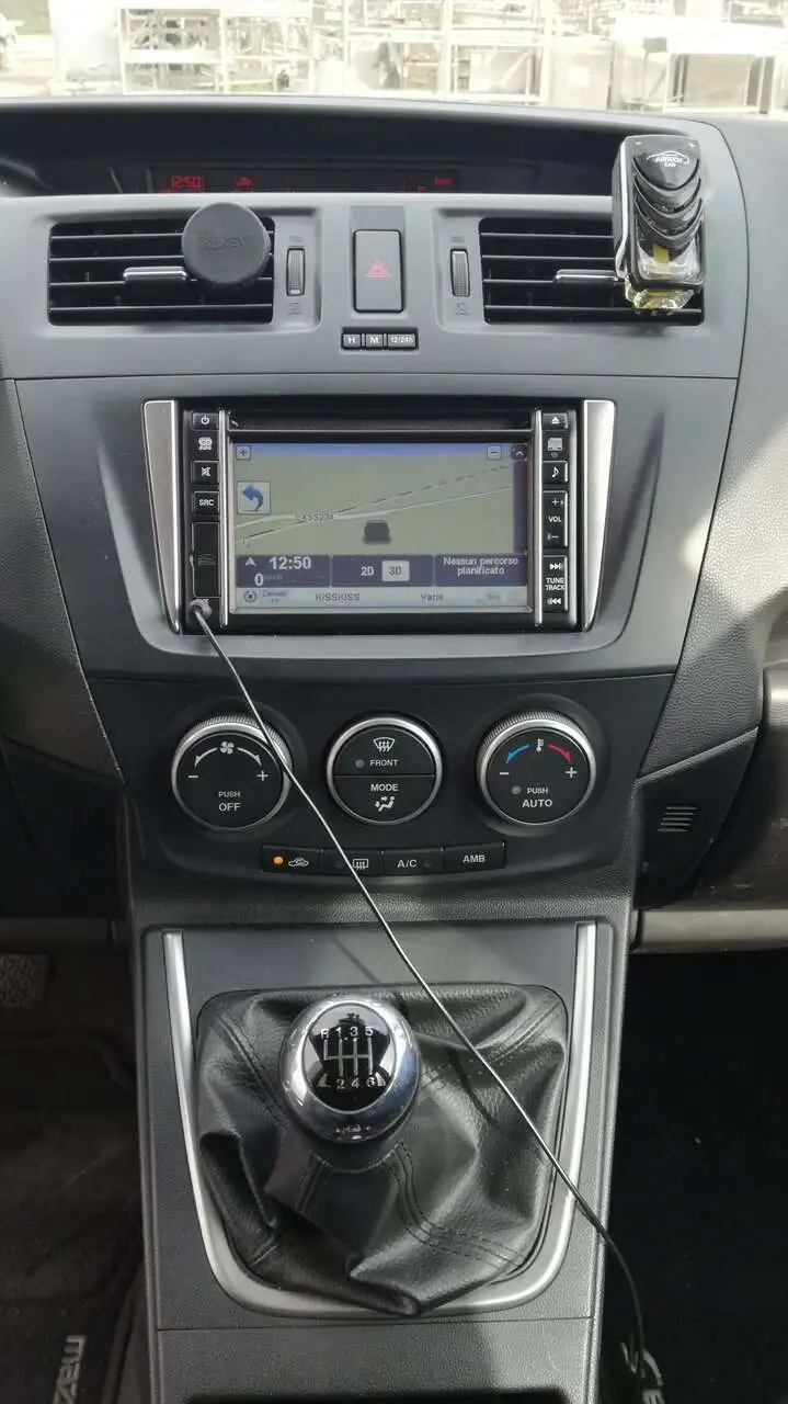

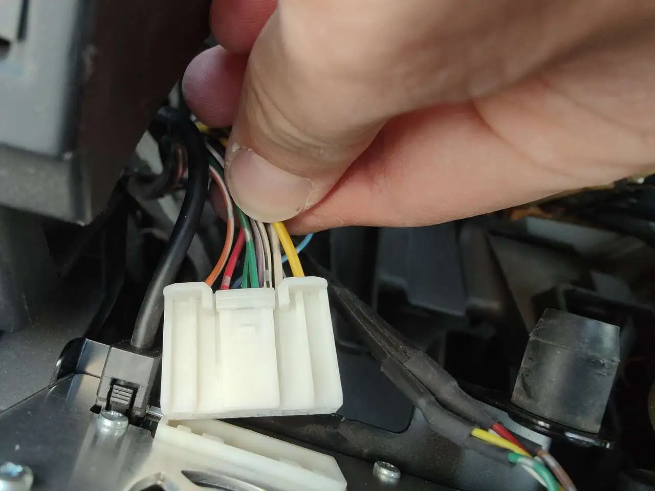

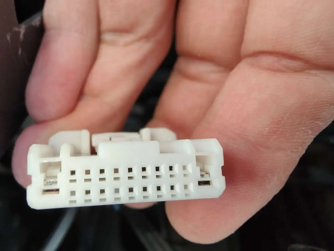

hello friend, I have a 2013 Mazda 5 with the original navigator and I would like to change, putting an Android 2din.. the problem is that the power cable has a different connection and I have not found any cable that fits, what power cable do you have used? Attached are the photos of the original power cord of the car and of the new car radio that I would like to buy. Thanks in advance

I have no idea what you said, but I did see the picture of the total piece of s*** Chinese "Android" head unit. You do NOT want one of those things. Avoid at all costs.
