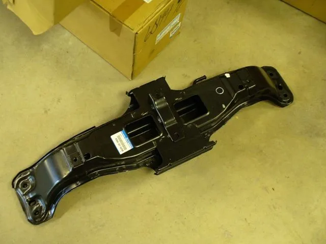

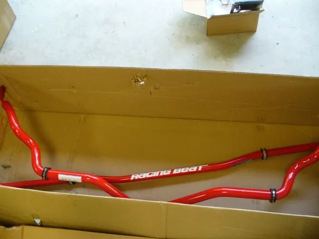

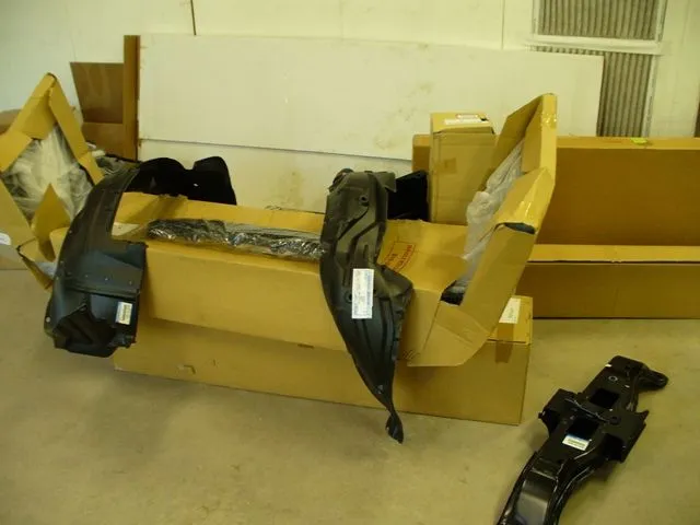

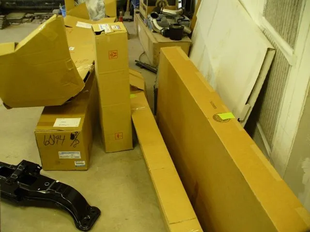

Here is a few pictures of the parts after I took them off the skid.

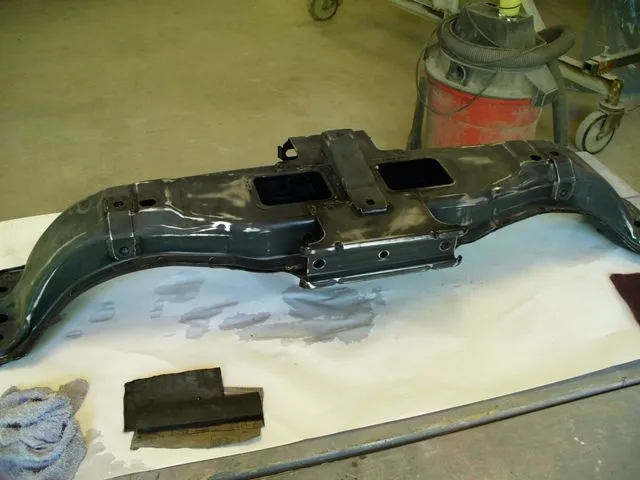

The crossmember came painted but not very well it was a really light coat so I figured I would wetsand and scuff it and get it rdy for paint. I will be primering it with apoxy primer first for some rust prevention and to cover the bare metal spots so the paint will stick. Then I will paint it will some gloss black single stage laquer. Here it is after I wetsanded and scuffed it.

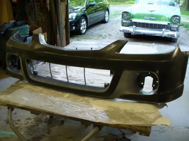

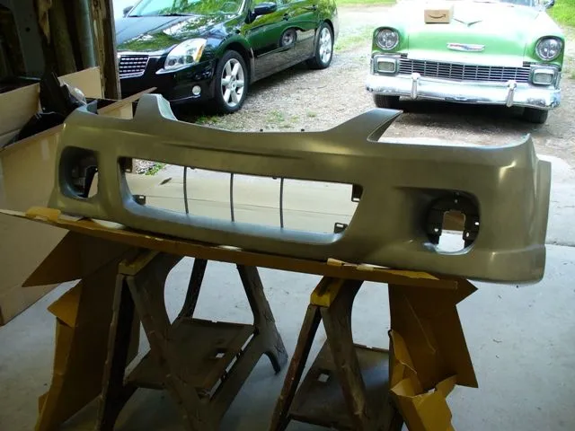

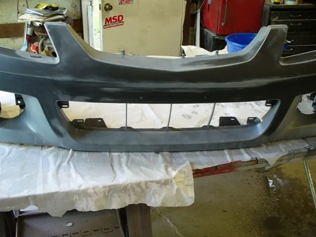

I almost finished wet sanding the front bumper for the first time around. The bumper came with a light coat of gray primer I used this as kind of a guide coat and wet sanded it with 360. Next I will primer it again with K36 and then put on a black guide coat and wet sand it with 600 and then she will be rdy for paint.

Thanks just finished wet sanding the bumper today if I get a spot in the paint booth monday ill primer it again.
