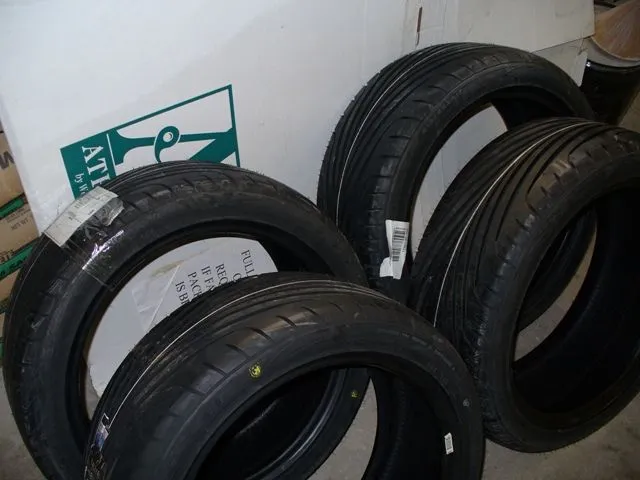

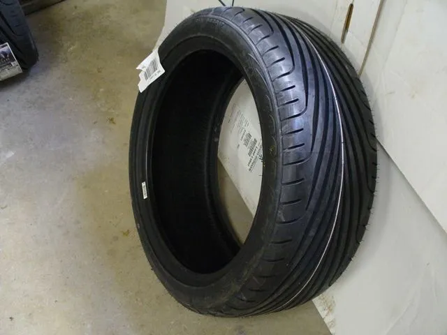

Thanks most likely putting some snow tires on them for winter cause no way will I ride on the 3.5's with gs d3's.

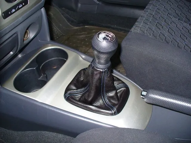

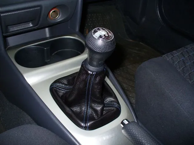

Installed my SR shift boot today from HPF.

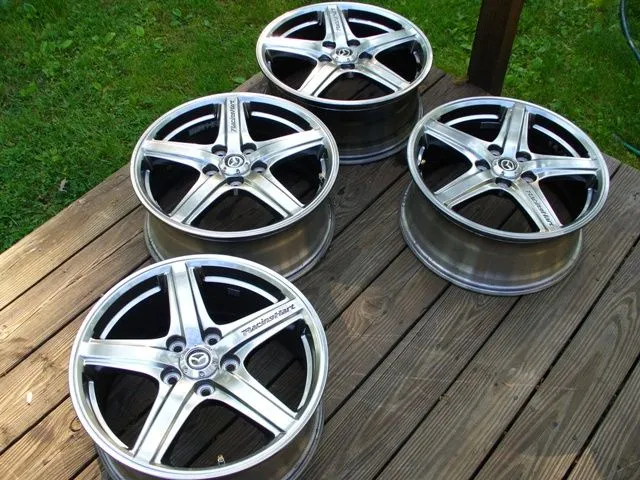

MmmmMmm Racing Hearts

Cant wait to try these out.

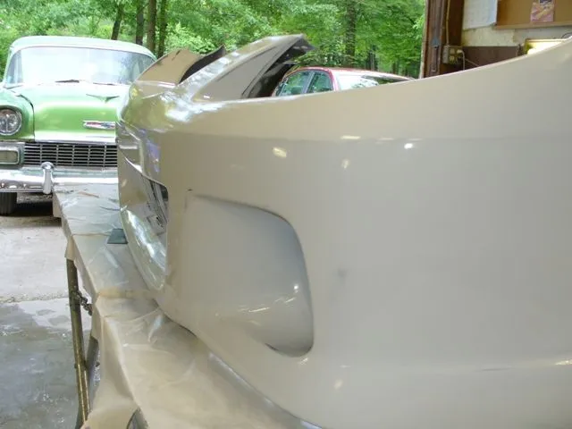

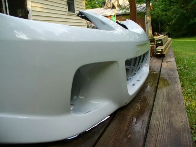

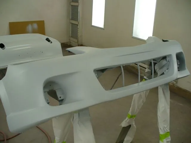

Got the front bumper in filler primer today. First I had to clean it with a prep then let it dry and wipe it with a anti static cloth. Then I coated it with some adhesion promoter which is sprayed on after letting that dry 10min I coated it with the high build primer with the flex additive. Next I will spray the bumper with a black spray paint for a quide coat and wet sand it with 600. After that it will be rdy for a light coat of sealer then paint.
All blocked nice and slick just about rdy to paint.
Thanks i want to have everything on by the first week of july and next week if nothing comes up hope to have some stuff in color.
