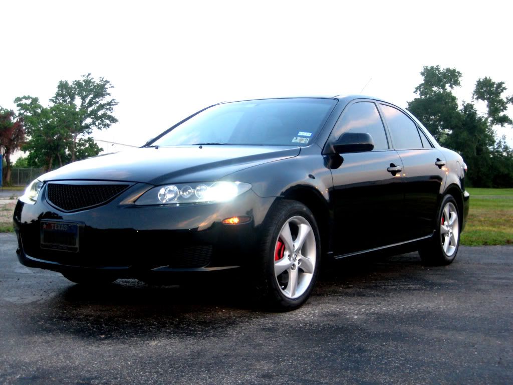

I just finished putting in my last 2 led's yesterday.. Car is now completely LED swapped inside and out..
I find 6000K has more of a blue hue to it in person... Maybe it's just me. I guess it depends on the make, the bulb, projector, source of lighting, ect. ect.
Here's my 6000k HIDs. They do have the slightest blue, but it's like a Pearl White maybe. They match the LED's pretty good as my LEDs have a bluish hue. Once the HID warm up, they are really bright white
Here you can see that blue hue on warm-up
Here's right when you turn them on... Before I aimed the lights too lol
Hope that helps man.
