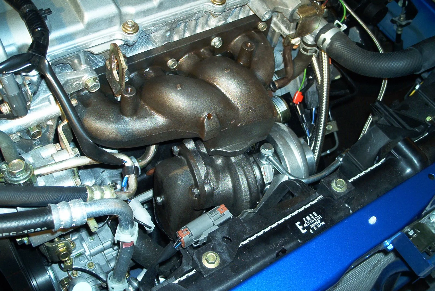

hi accuser,im actually installing my turbo 2 and im having some comfort in ur install. I bought i tsi extreem turbo kit and the install inst sucked, basic turbo install instructions and no i mean no intercooler piping instructions. I figuered it out tho.
but thx for the info on ur install experience, it gave me some hope that ill be done and ill join the boosted pritege club, ill post pics soon!!!!!!!
heres my progress so far ive been on it for 2 days.

looks good... you're almost their... and don't worry ... you will get their.
take my advice... get a wideband o2 sensor... it really helps
i thought my car was pretty much tuned... untill i installed mine today... when i started driving ... i was running so lean... it was sickening...
i was about about 15.00:1 at high rpms...
put my wideband on... took 4 trips around the block and i'm already at a point where the car runs safely pushing 10 lbs of boost... ( so says my gauge... which i'm starting to notice has a slight offset... so it might actually be an 8 lb spring... but i will find out when i have my profecb for sure... also, i'm going to puts around with the vacum... maybe i will tap the gauge in another location.
car sounds sick... going to see i fi can get some audio soon (no digital camcorder ... :-( ) i can always take short vids with my regular digital camera, then over dubb the sounds with windows sound recorder, a microphone, and my (bad) talent in beat boxing... i'll be that would be interesting...

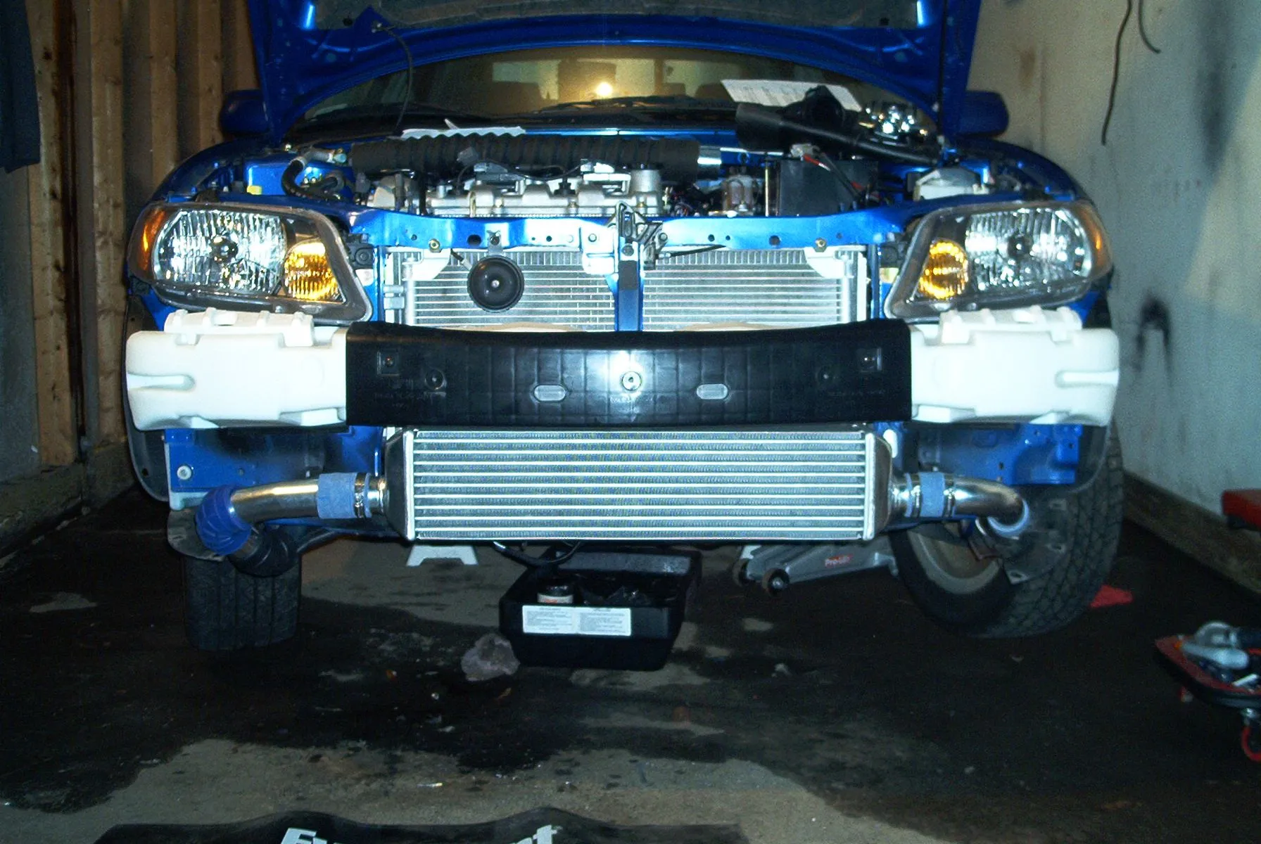

accuser said:
Pedro,
The intercooler is off center.When I sold you the parts you had a Starion(of something of that nature) FMIC.I know you cut up the pipes so they would work with that intercooler.Now that you have the Gen1 FMIC that I gave you, your piping needs to be fixed.I'm going to make you the pipe that goes from the turbo to the intercooler so you can center up the intercooler.
This way you can say you have the Gen1 Mental Addiction kit.
I'll pull out the jig and make you the new pipe and send it off to the powdercoater this week.
I'll also get you a heat shield...
Give me a week to week and a half(Thanksgiving Holiday) and I'll have the correct parts for you.
I won;t be able to sleep at night until your intercooler is centered, all black silicone,Polished heat shield and T-bolt clamps own your engine bay.

yea, beau will get ANYONE anything, and make sure it is done right. i remember how much sleep he lost when i had my FMIC slid the same way (though not as bad).
the only reason mine sits that far is because the second pipe that went on the turbo side of the intercooler was cut up when i was making mods for the starion intercooler...
all the tubes and fins are still showing so it's not making a difference in terms of efficiency... it would just look nicer if it sat closer to the center... but i'm not in it for looks anyways... either way, it's getting fixed soon... beau, the good guy he is... has offered to make that second pipe for me... :-)
