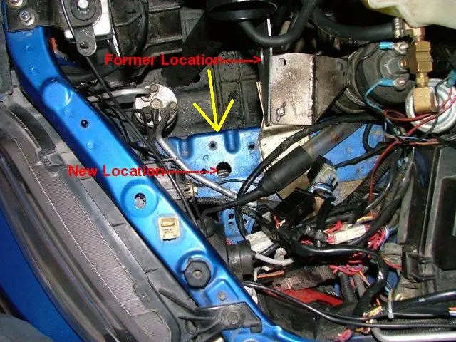

Mine is in the fender to make the ECU think it's colder and give more fuel. Here is a pic that Linux Racr took of where his is. Mine is on the side of where his is just down a little. There is a hole already there that it fits in nicely and you will not need to extend the wires either. The yellow arrow!
That's a great idea!
