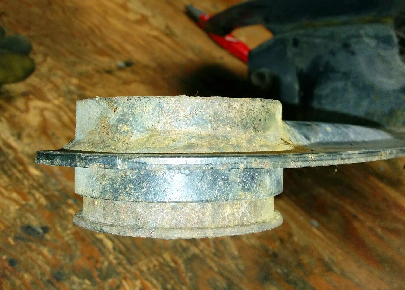

One trailing arm bushing, I was able to push out with my hand. The other one I'll need to work out.

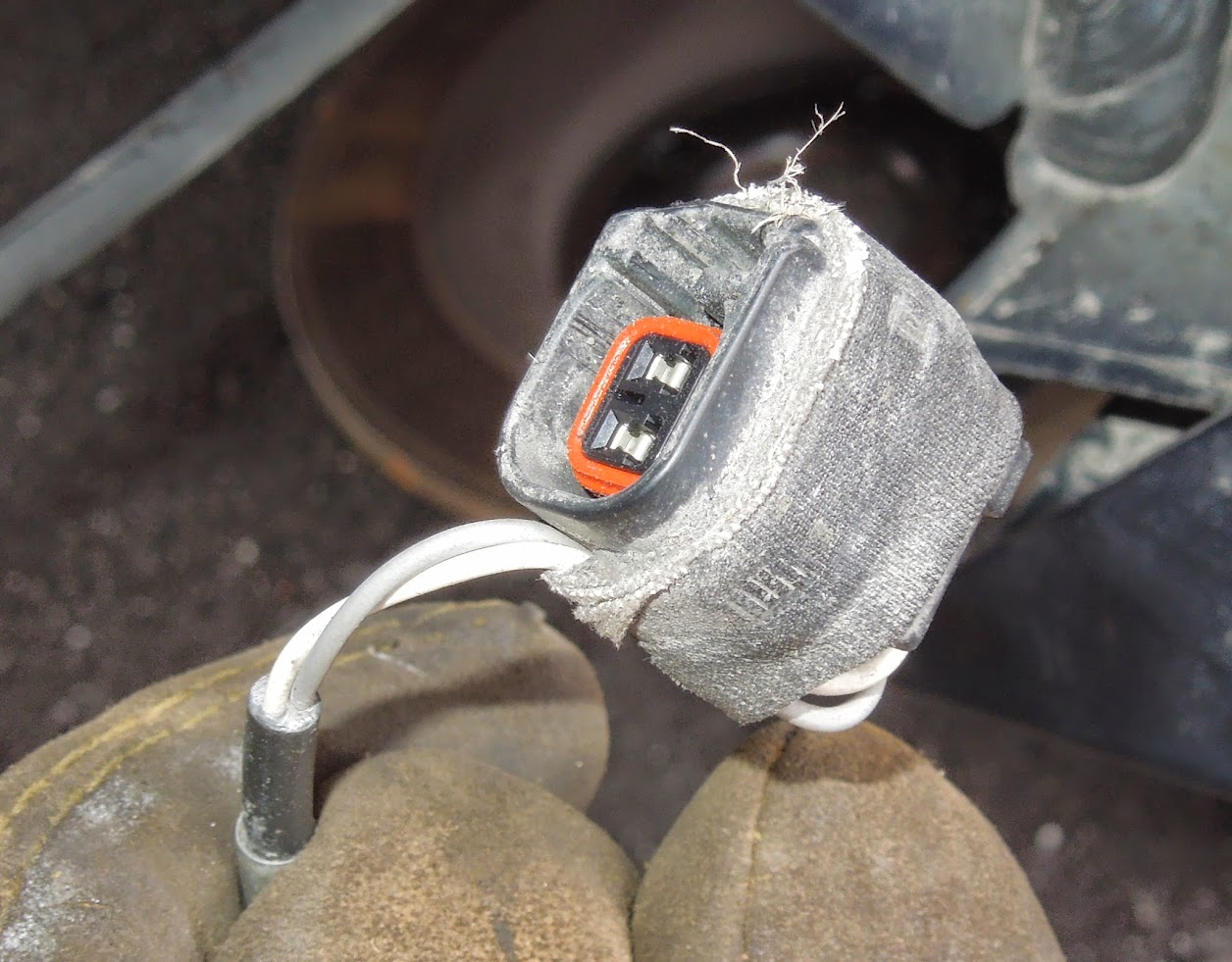

Was the 20 wraps of cloth tape and zip tie a factory installed option?

Yours looks exactly like mine did before I started replacing parts Dave! I replaced the following and the problem is 100% fixed : Trailing Arm Bushings on both sides with OE spec, not poly, Lateral Links, both sides with Moog from Advance Auto, rear shocks with OE Spectrum and shock mounts Moog. I know the OE Spectrums are supposed to be crap but they have done great for the last ten thousand miles on mine. The single biggest contributor to the alignment being so screwy is the bushings on the trailing arms, mine were so bad that when I removed the trailing arm from the car the metal center bar that the mounting bolts use to hold the arm to the car just fell out on the ground! You will have to have a shop press to get the old bushings out and the new ones in if we haven't already covered that ground somewhere in this thread LOL

So does the new Prothane/Energy Suspension (forget which one I bought) bushing press into that insert? Or does that insert come out and press directly into the control arm?
You cut out, drill out, burn out, etc. all of the rubber until you have a smooth sleeve remaining. Then insert the bushing and follow that up with the pin. The pin is not easy to get in when under the car but probably not bad when using a press.
OK that's what I was hoping to hear! The sleeves stay in place. I saw someone with a Focus that didn't look like they used the sleeves so it looked funny to me.
