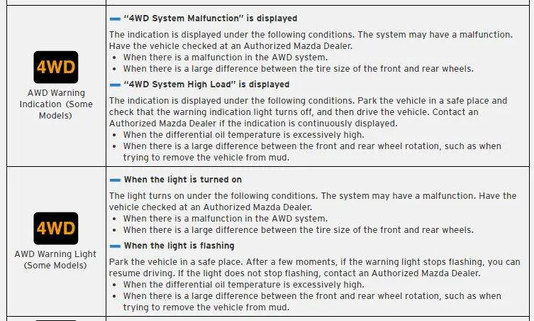

Here's a screenshot from the Owner's Manual of the 2017 CX-9:
Based on your description, it sounds like the diff oil may have overheated?

How could the differential gear oil overheat, especially in the winter? Spinning a tire a lot will do it. Being way low on oil will do it. Or a mechanical problem that needs to be repaired. And, there are other reasons for the 4WD alarm light to illuminate; all need to be checked.
