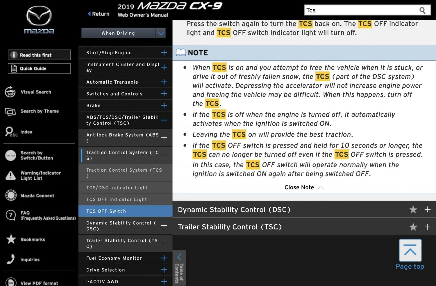

I’m not familiar with 2021 system but your advice on the hill assist button seems good. Not sure what model year the OP has, but here is the manual for my 2019 below...
If I was stuck in deep snow or trying to get up a hill, turning the TCS off would allow the wheels to spin which can help aid in momentum to get me unstuck or up the hill. Once back on my way, I would turn it back on as it will definitely help keep the vehicle pointed in the right direction as I head down the road.

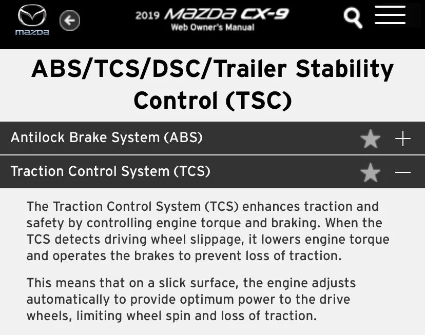

Just to prevent confusion I think what you are describing here is the new “hill assist” button. In the 2019 and older models the TCS works the opposite. When turned on it applies brakes and lowers engine torque to prevent tire slip, when turned off it allows to the tires to spin freely. Here’s an excerpt from the 2019 manual...
