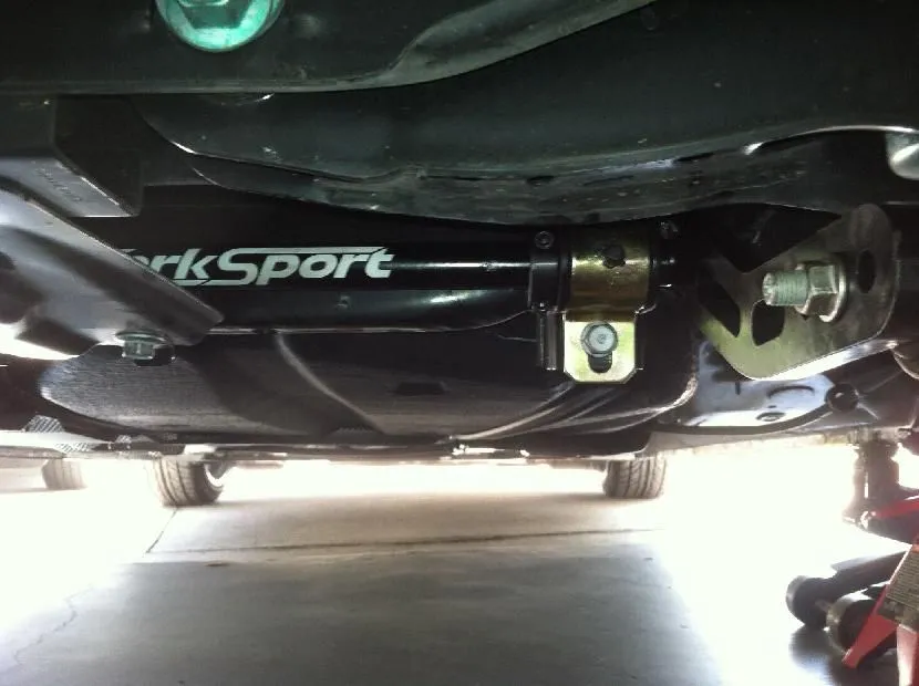

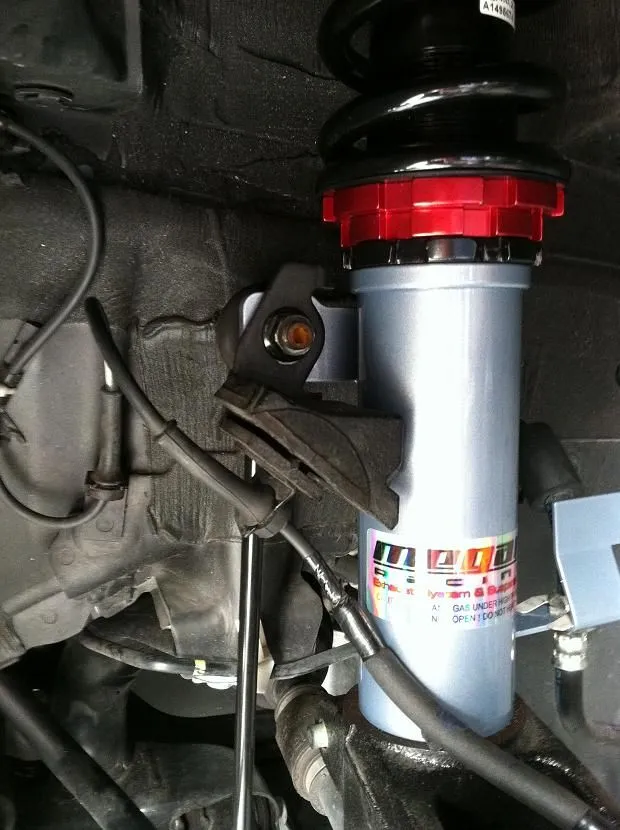

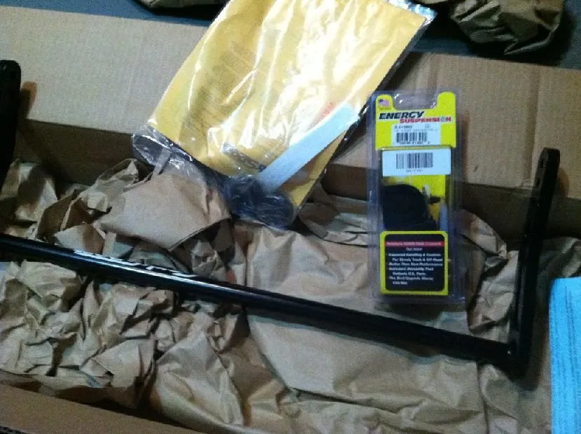

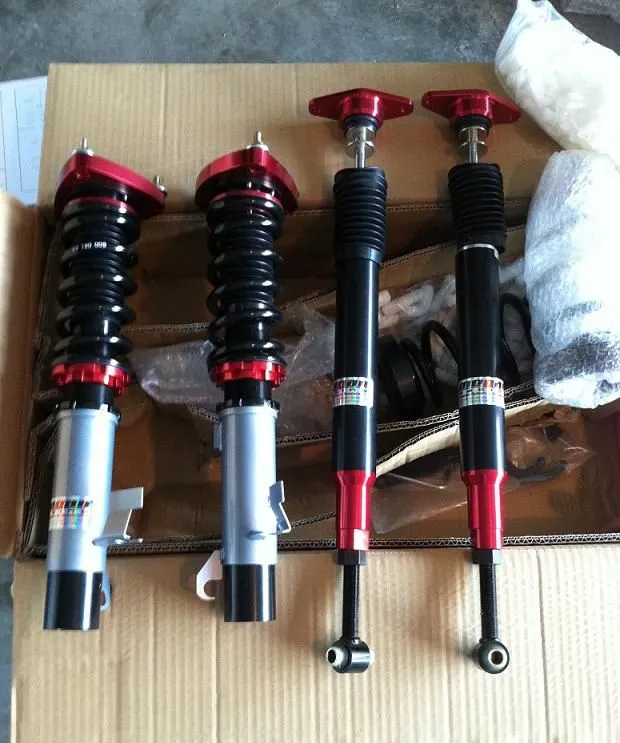

They Are MEGAN Coilovers Cost $900 And The Spring Rate Is 8K Front And 7K Rear. I Put Them On This Morning Along With The Corksport Rear Swaybar, I'll Try Some Side Pics Tomorrow.
I didn't know Megan made coilover for mazda5. Is the coilover specifically for mazda5? Did it bolt right on or you had to retro fit it???
Please post pic! I'm exited to see it
Yes, MEGAN Does Make A Coilover Set For The Mazda 5.
H&R Is Perfect For A Family And Yet Still Sporty.
MEGAN Coilovers I Wouldn't Recommand For A Family With Young Kids, The Ride Is Harsh!

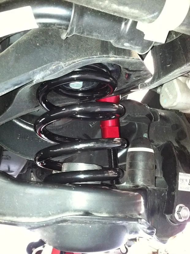

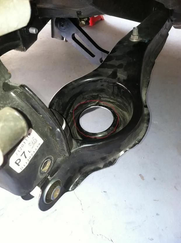

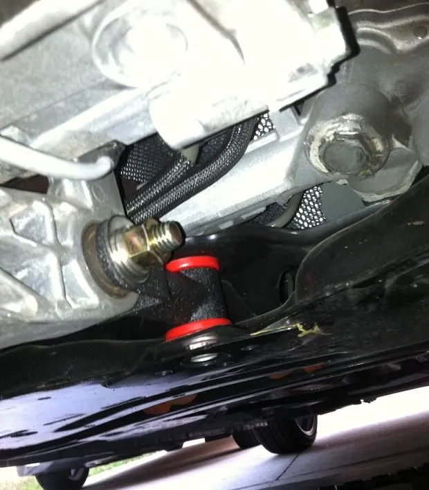

Added Some New Pics Of The Frone And Rear Coilovers Installed.
Rear Sway Bar Installed, And The Rear Arm That I Had To Grind (Debur) For The Spring Perch.

The Megan's are 8k front 7k rear. What setting do you have the rebound set to? I don't know anything about Megan brand but I assume it uses universal cartridges very similar to the likes of BC and Yellowspeed. Two members here are on BC (8k/7k) that I can recall and neither say it is harsh.. If you can have a do over would you have gone with a 6k front/5k rear for a more compliant ride???
if he has those 18's on the car, with the megans slammed (which it appears he does - the fronts look ALL the way down), that would cause some harshness...
I Started On 0 For My First 2 Days But They Are Definitely For Race Only. Now The Fronts Are Set On 14 Clicks From 0 And The Rears Are Set On 12 Clicks From 0. Anything Set On 0-8 Which Is For Race Is Harsh! The Ride Quality Is Way Better Then Expected.
I Don't Think The Shock Inserts Are Universal Cause Each One Is Labeled Specific With Part Numbers.
I Actually Was Contacting Megan Racing For 1" Shorter Springs Front And Rear And 9k Front And 8K Rear Springs.
