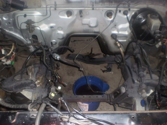

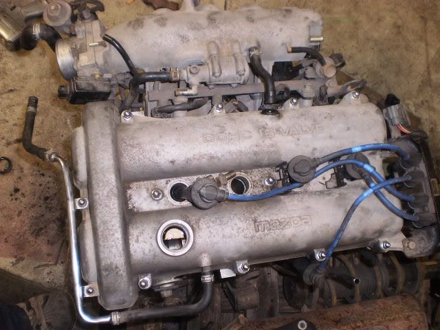

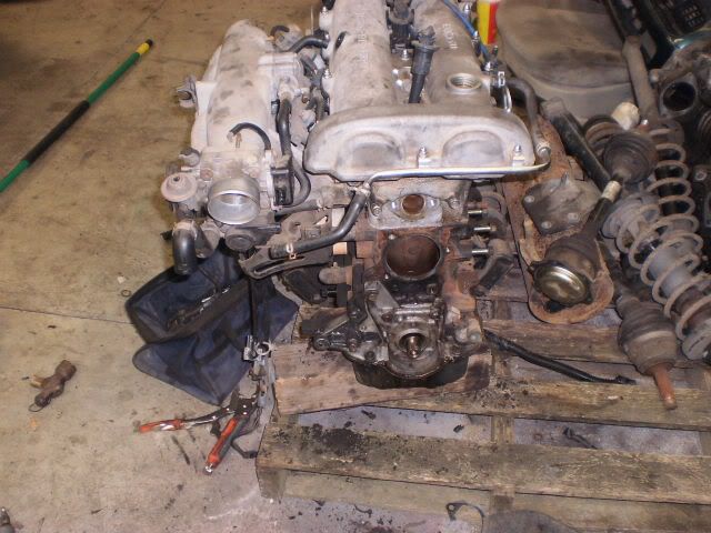

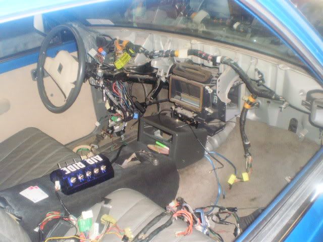

my 1.6 Miata motor swap into my b2200
msp5
Mazda b2200,rx7,626,pr5,and turbo'd mps
So i got the bright idea to swap a 1.6 miata engine into my b2200 heres some pics of where im at.let me know what ya think

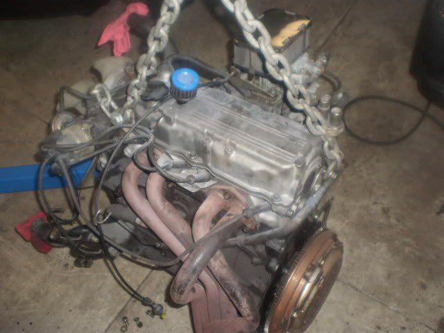

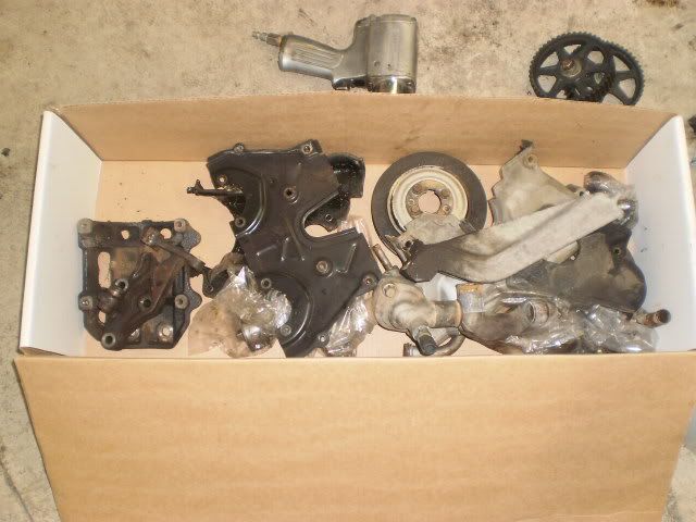

update time.Found the b2200 trans wont bolt up to the 1.6 like i thought it would, so i bought a miata trans for $200.the bell housings are interchangeable.but i want to see if i can make the miata trans work with the b2200 tail shaft due to the diffrent gearing of the trans.ill get some pics up as soon as i get to my garage
