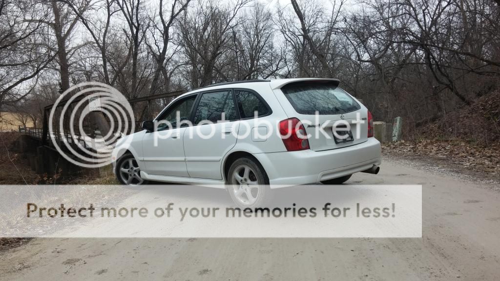

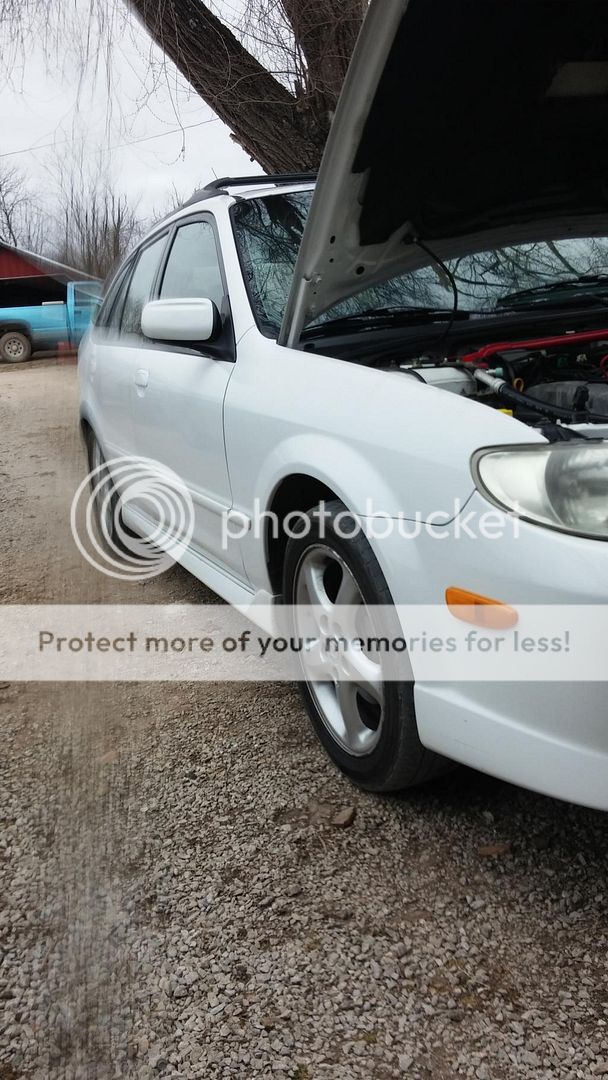

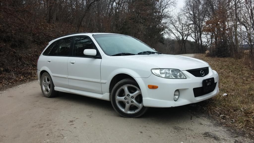

Brought this home yesterday. 02 P5, 5 speed, Pure white. The only option it came with is a power moonroof, which works great. Supposedly has ABS, but I don't have any light for it on the cluster, and it didn't seem to work when I locked the wheels up in my driveway. It's got 160k.
I paid 1800 for the car, knowing it has some issues. The worst of them being that it smokes like a freight train for the first 10 minutes after a cold start. It runs great though, and drives nicely.

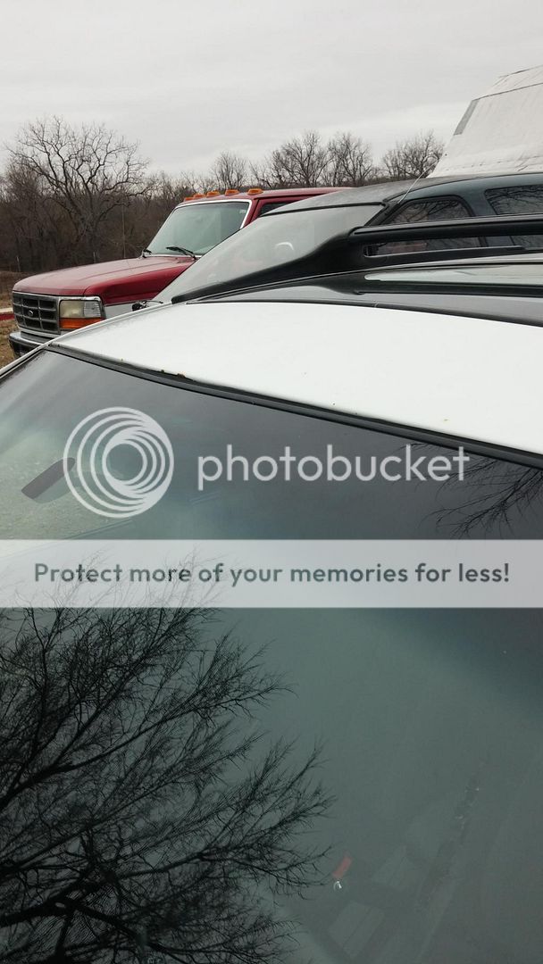

Rust spot on passengers rear fender, and some minor specs above windshield. See photos.

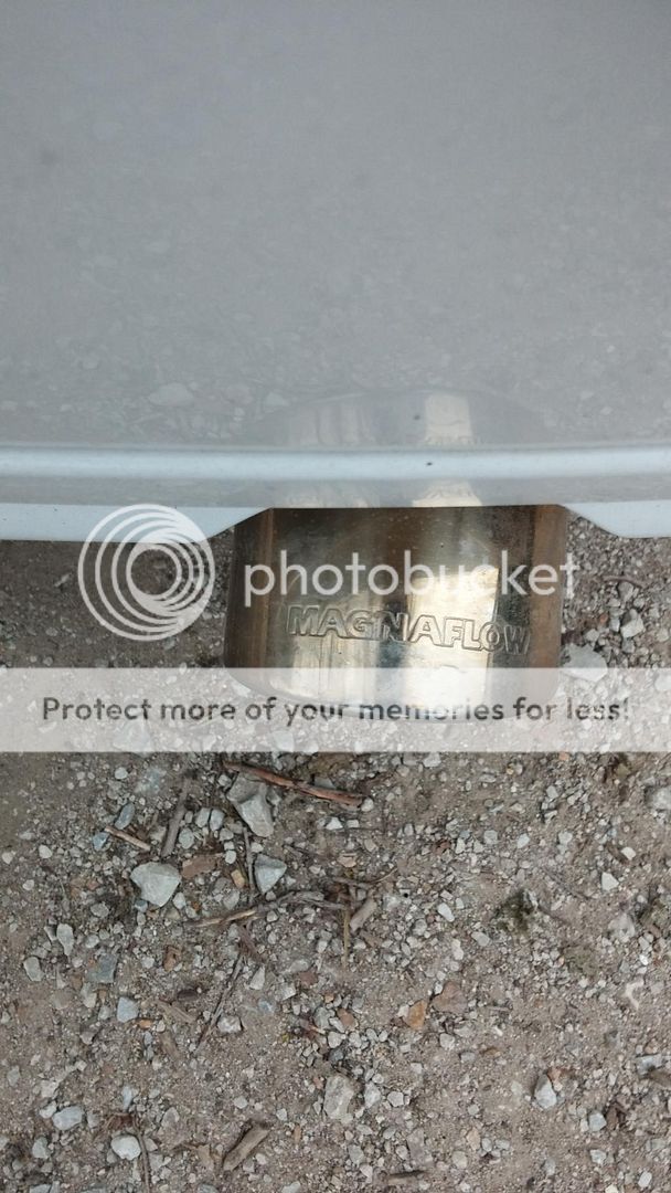

Has 3" Magnaflow cat-back. Sounds pretty good.

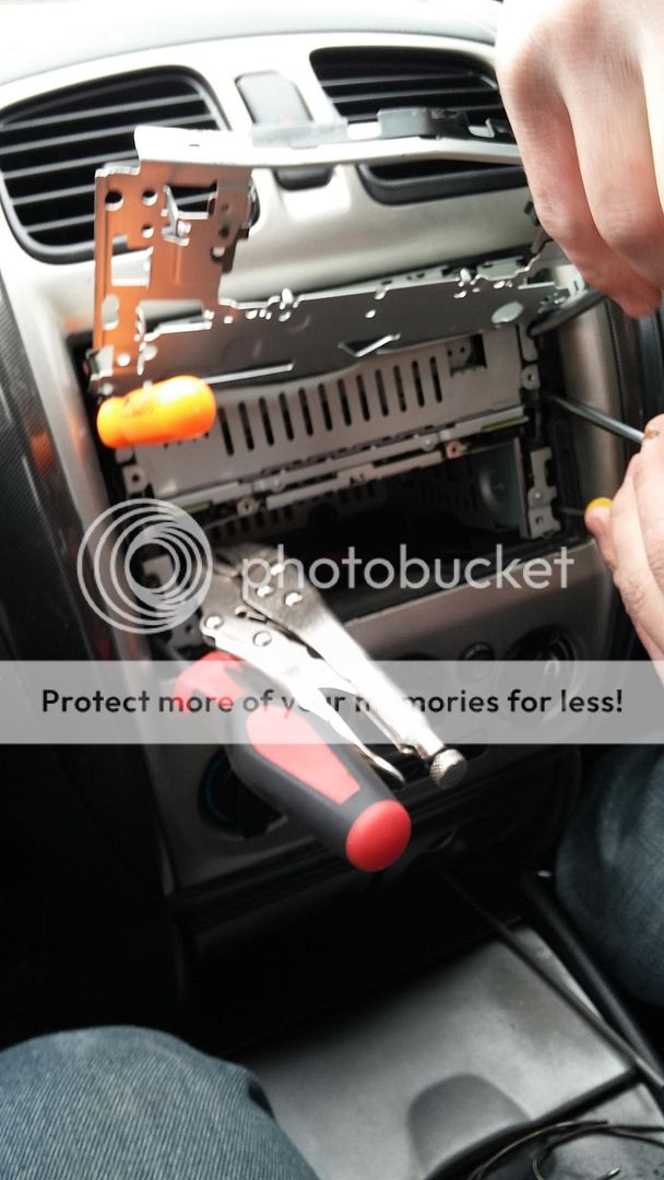

Getting the old unit out was real pain.. I didn't have the removal tools, so I fashioned some from a coat hanger. Progress with those was dismal at best, so I decided to thread a couple of drywall screws into the upper holes on the radio face to get something to pull on. I got two good pulls in before the plastic face ripped off.
After that I pulled up the metal plate that was under the plastic face and was able to get a better view of the retainer clips. After some fiddling it finally pulled out.

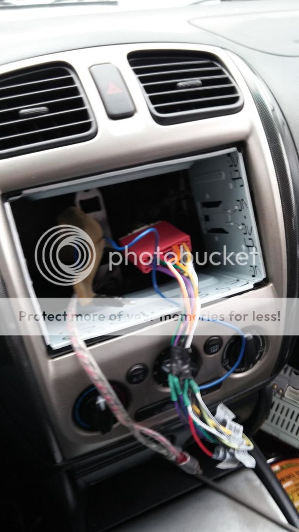

Harness all soldered and DIN cage installed. I went ahead and hooked up the remote and RCA's so I don't have to remove the HU again. I stuffed them under the drivers seat for now. I will run them under the carpet when I finish my subwoofer box and install the amp. I also ran a USB cable into the glovebox.

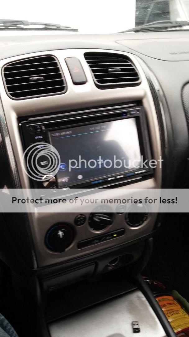

The finished product:
It really bothers me that a bezel was not included to cover the gap between the radio and dash... I'll have to rig something up, I hate the way it looks.
The HU works like a dream though.. Does everything I need it to. You'll have to forgive the blurry pics, the lens on my phone must be dirty.

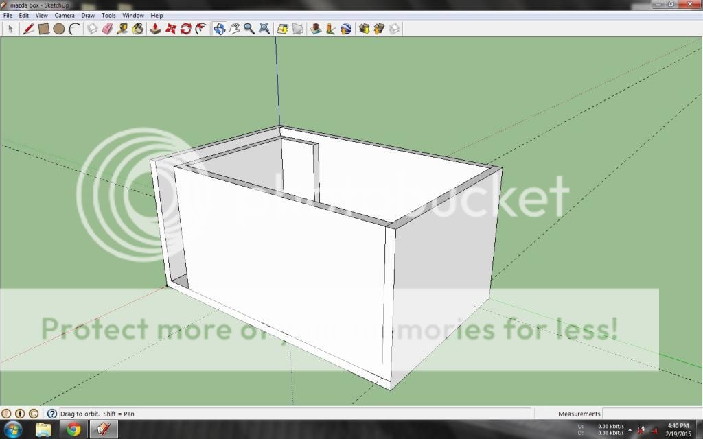

I drew up a design for the box. 2.5 net cubes ported at 35hz.
The DD should bump pretty good off of 1050 watts RMS. I'm really curious to see how it'll sound. I also have a 15" TC9 motor that I might recone for this car. This is all stuff I already have, so no huge investment loss if it doesn't turn out the way I wanted.

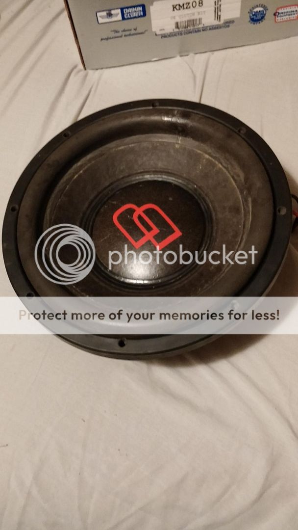

Here are some photos of the sub. It's an older K series motor from 2003. The coils still measure perfect and it's in good shape, but the surround is kinda rough. I am gonna get a universal surround kit for it, and try to get a new carbon fiber dust cap from DD. I bought the sub a couple of years ago on CL for 50 bucks.
