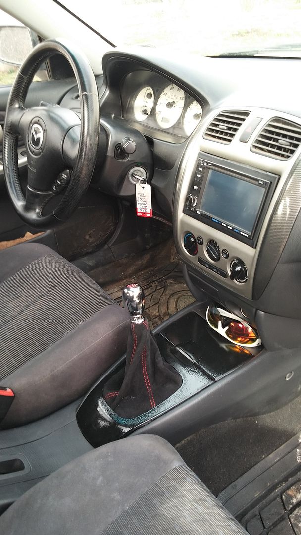

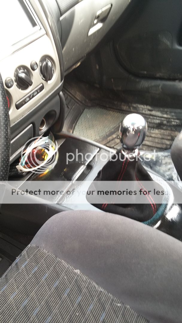

My shift knob and boot came in. I don't know what to think about the chrome knob. I'll give it a couple days to see if it grows on me. The shifter is a little shorter now, this knob slips further onto the shaft, and I cut 3/8" off of the top to shorten it even more. The boot went on pretty well, I had to fold the front slightly, and cut a couple new slits in it, but overall I think it looks pretty good. My shifter bezel was completely worn and bad looking, I think someone spilled nail polish remover or something on it. I sanded it down and painted it, but something went wrong with my base coat (can was almost empty, got more propellant than paint) that gave it a waves on the water texture. I'm gonna let it dry for a couple days then plasti-dip it black, or rattle can it silver like it used to be. Black was all I could find locally (I live in BFE).
The knob:
https://www.amazon.com (commissions earned)
The boot:
If you dont like the chrome, you can turn it into a brushed finish pretty easily. Chuck it in a drill and spin it against some sand paper, then clearcoat. Tends to look a bit more classy.
It would match the trim bezels a little better with a brushed finish. I'm gonna try that, thanks for the tip.
Well, the sandpaper idea would have worked pretty well, if the knob didn't have copper underneath the chrome. I don't know what I'm gonna do now, but even right now it looks way better than before so I'm not that concerned about it.

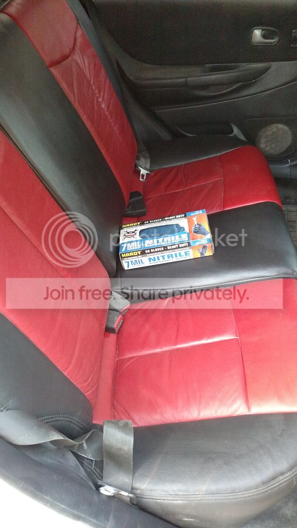

I have red and black Katskinz leather on the way, the set that was listed in the classifieds. I will do my best to take pics during the process of that install. The one thing I really wanted that this car didn't have is leather. That wish will soon come to fruition.

Here are some photos of the leather. I put it in a couple months ago. Despite what I read online, hog rings are not used on the new covers, they use plastic C channel to clip around the framework. There were 4 rings on the factory seats, that only need to be removed.
