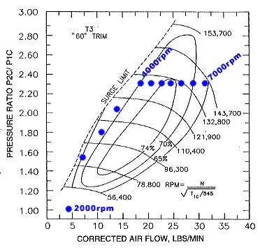

Ok, So I made an excel spreadsheet that we can all use. It will help in turbo size selection too.
Feel free to update it yourselves, as I know it's not 100% accurate. For the VE, I either used .7 or .8, depending on the RPM. Also, as far as pressure drop goes (intercooler pressure drop), I pretty much just pulled it out of my ass.
If there are any errors other than that, just let me know.
I've also attached how my car does on a T3 60 trim compressor map.
Have fun.

Kooldino, am I wrong in saying that it looks like your T3 is a little small for the amount of boost you are running?
