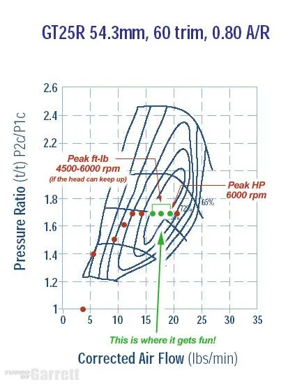

His CFM is ok.. but yes his PR is a little high for the turbo... but that's pretty normal for most turbos... he's not way outside of the efficiency peak, so he's pretty good overall... can't go a lot higher though.

I mapped out the GT25R (roughly). 1 bar at redline would be ideal for this turbo, assuming a fairly stock VE. You can really see where a higher flowing compressor would make a difference for people with free flowing systems.

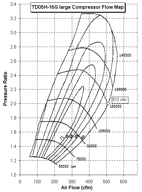

I'm too lazy to map mine.. but here is a Big 16G which is a little less flowing than mine... my turbo reaches out past 550 CFM for comparison... but same rough map..
Where do you get 1bar from? the points you plotted look like 10.3 psi if I'm reading that right.
You're right. I wasn't referring to my plot, though. I was saying that 1 bar (2.0 PR) seems to be a good place to be withthe stock compressor wheel. I'm only at 7 psi right now.
