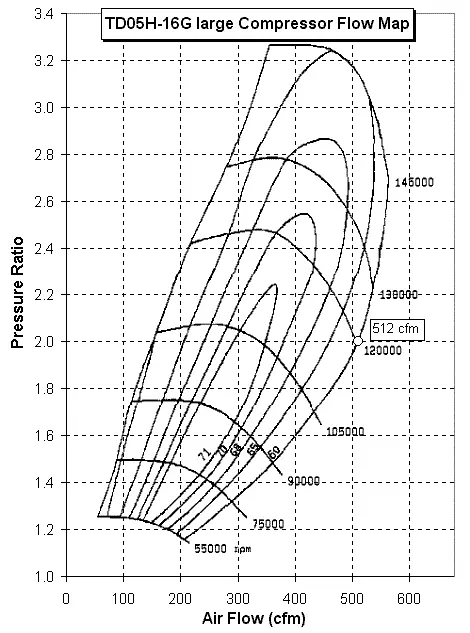

And this is the map for the Large 16G... I run the evo derivative which spools faster and flows another 50-80 cfm more... it is also a perfect match for the car... and the best part is... it costs less than HALF that of the GT28RS as you can pick up an EVO III 16G for about 500 bucks.
It looks like an FS-DE could run that at about 6psi with decent results. Am I right in saying that?
The only thing that I see is that the efficiency of the center island is only 71 percent. That seems a little low.
Yeah that is one downside... but this turbo spools as fast as a T25.. The Evo III that I have is a little more efficient than the map you see, so that helps as well and the overall average for the entire width is closer to that of the GT28... Keep in mind you are only talking about a couple of horse and things that can be overcome with other things.. just think how much more intercooler you can get for the 5 bills you saved buying this turbo instead.
I can totally agree with that. Performance/$ that turbo rules. They used to use those on the old DSM's (same engine as the Evo, pretty much). It's definitely proven!
