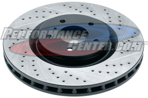

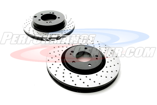

i'm going with rotora.
both fronts cross drilled and slotted for $165.
rear cross drilled and slotter $183.
add Bobcats to that, and say goodbye to braking problems.
or i might just do crossdrilled, to save pads
something about euro spec in the rear or front I forgot which one. Either the front or rear will fit not both. Someone will chime in hopefully. I guess you can go with a combination of rotora and kvr. That's what I'll most likely do.
