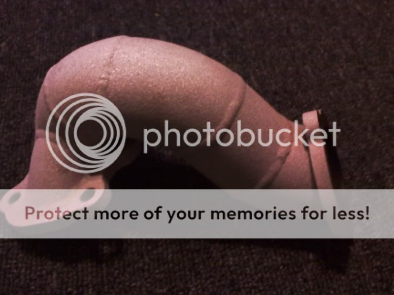

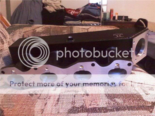

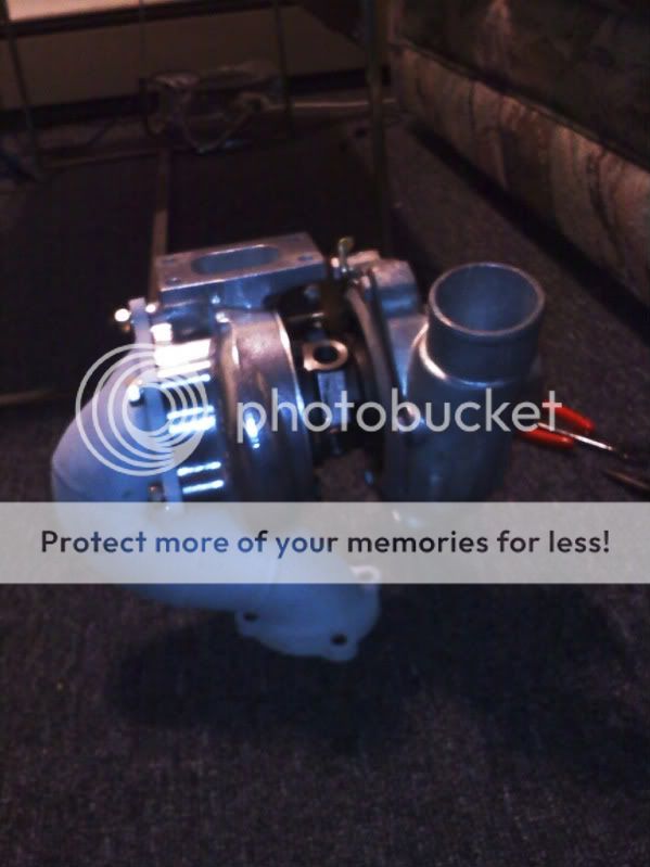

The 505 mani has arrived and Damian is in the process of installing it. Here are pics of the mani, the ceramic coated Corksport S pipe and the disco potato... I'm starting to get really excited!
