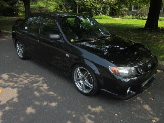

So I'm tired of my car not preforming to my liking, so I'm going to build it up. Here's my list of parts in order of ordering/installation.
What I have motor related:
SRI
Front motor mount
Vac lines
more things im forgetting im sure
What needs to be installed/in the mail/being made now:
FMIC/bov
Exhaust
MBC
New WGA
Whats next on order:
SSAFC
new turbo, not sure which... input from you guys?
forged rods and pistons
Let me know if I missed anything, thoughts, ideas... I would like to keep the stock exhaust mani and down pipe... Trying to dip into the 13's here.
