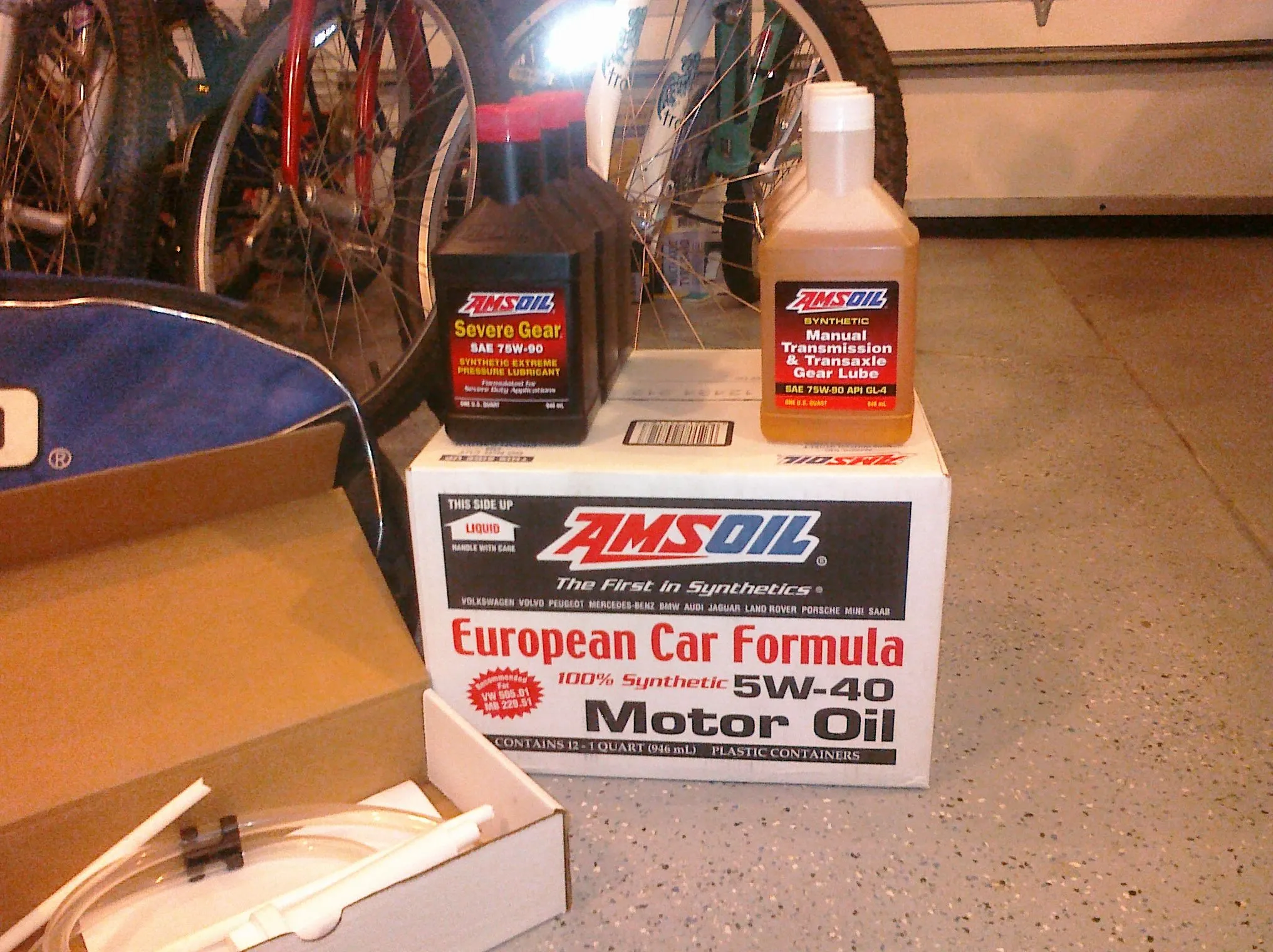

Just put my order in for 3 qts. of Amsoil syn. transmission lube and 3 qts. of Severe Gear 75w-90, as well as the hand pump. Should be in middle of next week.
Here's my purchase:
I also have dealer pricing on Amsoil, so before you buy, let me know and I'll let you know what it would cost with the PC discount. I am NOT selling it (at least not right now).
