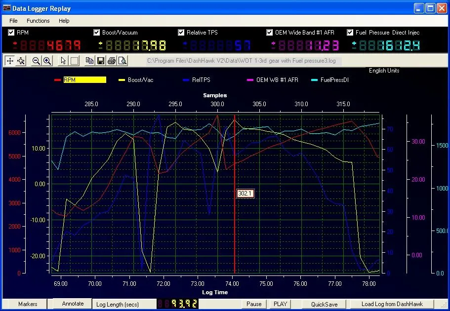

Here is a current log of a WOT run in gears 1-3.
I spike to 14 psi in 1st, 17.3 in 2nd, and 18 in 3rd @ 4680 RPM. In 3rd, I'm down to 11.2 psi by 6K RPMs. At 6500 RPM I'm down to 6.1 psi.

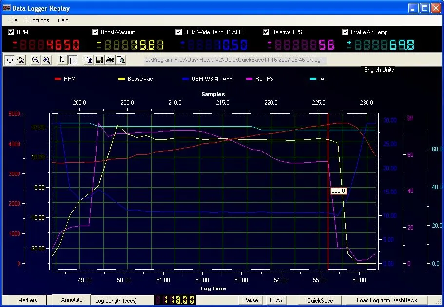

Now its a different story if I start off say in 4th gear at a low RPM and then mash it. In the 2nd log, I spike to 20.6 psi at 3500 RPM and hold about 15.8 psi until 4650 RPM.
