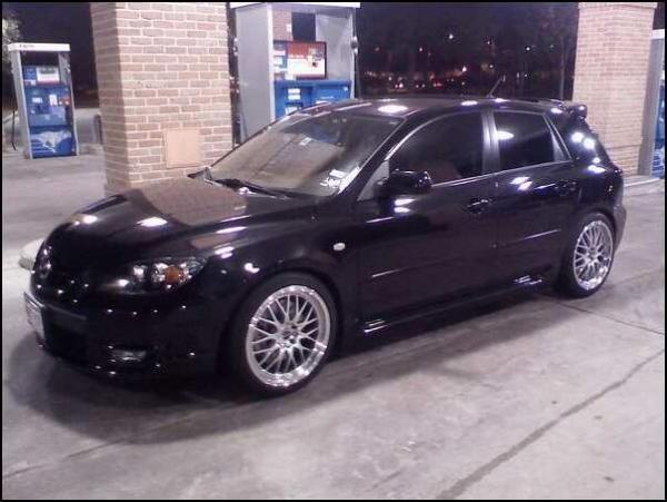

Here is mine.. I know I need better pics but thats all I have for now. The wheels 18x8 with stock tires for now, and lowered on Tein springs.
damn, that looks pretty hot. have any more shots? what wheels are they?
Thanks bro Ill get some more as soon as I get a better digi cam. Mine is isnt nearly as good looking as yours.
I'm usually not a fan of anything but darker wheels on black cars, but those are hott!
thanks alot bro
What part of H-town are you in? I'd like to see your car in person.
I live near Humble on 59 and the beltway.
Very nice, but damn, put some tire shiner on them tires... Tint would also look good. You're gonna love the Cobb SRI.

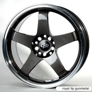

does anyone know if i can i fit these wheels without any fender rolling? 18x8 offsets available: +35, +38, +45, +48? what would be the best offset? i wanna go with a 225/40/18 tire and i have H&R springs.

+48 offset would be the best. the closer to stock the better.
whether or not you will need to roll your fender i cant personally comment on. im pretty sure ive read people running that tire size w/o rubbing. i believe that the stock size for rx-8 wheels/tires, which a lot of speed 3s r running (only difference is the minor offset difference)

GONES GOT BOOST; elects offset +45 is perfect in this car, no rubbing.

225 with 48mm offset should be fine

I have 225/40/18 tires on 18x8 wheels with a 45 offset. i also have Cobb springs and no problems. I bet you will be ok
