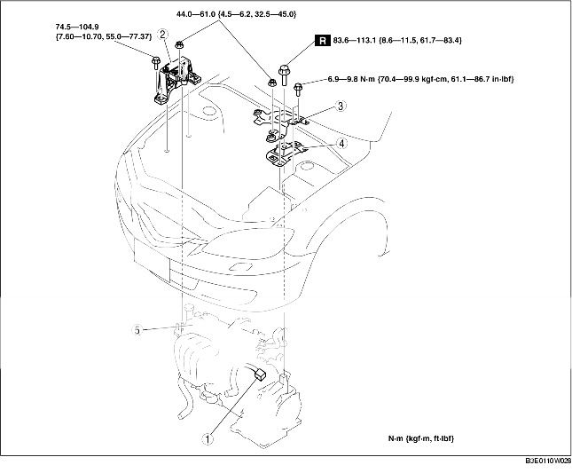

Diagram and torque spec for the MZ3
Hey, all this went up elsewhere and IS NOT FOR THE MS3. Still it shows the location of the tranny bolt that has come lose at least 3 times ("R")and a spec that is probably the minimum for the MS3. Anyway, get the dealer to tighten it if it seems at all lose, since no one has come up with the spec for the MS3.
the ms3's bolt is the same as the normal 3's (what you posted), but there's a discrepancy in the FSM... in the engine removal/installation section, it shows the value of what you posted (and that you must replace the bolt), but in the transmission removal/installation section, it shows 69.0-93.3ft lbs (but no mention of bolt replacement)
what is shown for the *normal* 07 mazda3 though is, there are 2 types of bolts... one is with a washer and one without... for the bolt WITHOUT the washer, you replace it... for the bolt WITH the washer, you don't have to... torque values are the same as what you posted... a discrepancy also exists on the normal 3's torque values... similar to the ms3's... in the transmission removal/installation section, it shows 69.0-77.4ft lbs... no mention of bolt replacement also
further look at this bolt shows that both the 2.0l and 2.3l models use the same bolt, and the ms3 also uses that same bolt... so now it is :wtf:
obviously the bracket on the tranny end is not the same between the A26M-R (ms3), and the G35M-R (normal 3s), but it uses the same bolt and therefore the tensile strength would be the exact same
so with how ****** up this s*** is, I think to be on the safe side, replace the ******* bolt and use that high torque value I've found (69.0-93.3ft lbs)... but if the dealer fixes the s*** for you, more than likely, they'll blast the s*** out of it with an impact wrench anyway... that's even better because it'll be even tighter (not to the point of breakage)!
