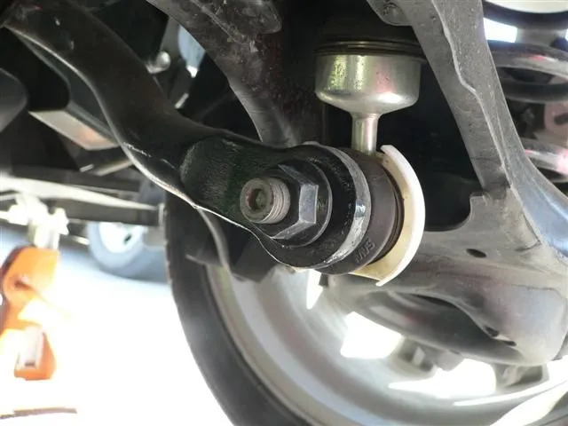

Can anyone post a pic of said bolt? I was under my car for the umpteenth time on Sunday and couldn't find a goddamn thing that was loose.... (nuts)
This one.

I have not seen anyone on this thread identified as owning a 2008 MS3 with this problem. If you own a 2008 and have experienced this problem, please speak up, it would be interesting to know if it was confined to 2007 models so we could start looking for any differences. If it happens to my 2008, I will put a jam nut on those exposed threads. They should be protected anyway!

Unfortunatly, 515 miles in, got the clunk. Crawled under the car to find the driver rear nut was hand tight. I snugged it up, clunk went away.
2 days later it was back. Jacked up the car this time so I could crawl under and get some more power on the wrench.
Has anyone found a permenant fix for this? Heavy torque and some red loctite?

I used blue 242, 40lbs all better for 16000 miles. Red is better until removal, then you need the heat. Blue did it for me. good luck
