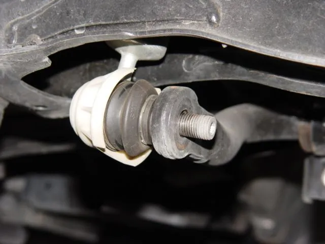

WTF Clunk! No Nut at all!
New to forum- Thanks Guys for this thread! Been driving around with wash bucket full o' tire shine and stuff in trunk and thought that was what was clunking...wrong!
Check this out-
You all should be getting aftermarket rear sway bars anyway. During the install, loctite those endlink nuts. Two birds, one stone.
This is how they fixed my problem-
Took out the stripped bushing assy and sent me on my merry way until the part comes in next week.
No loaner, no nothing but an unattached sway bar on the left side.
I don't know what I think about this.
