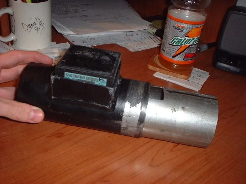

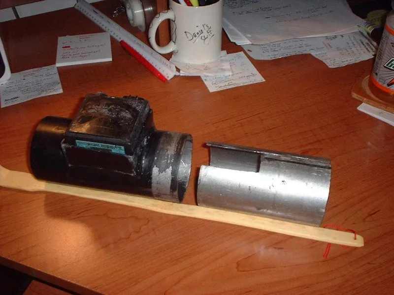

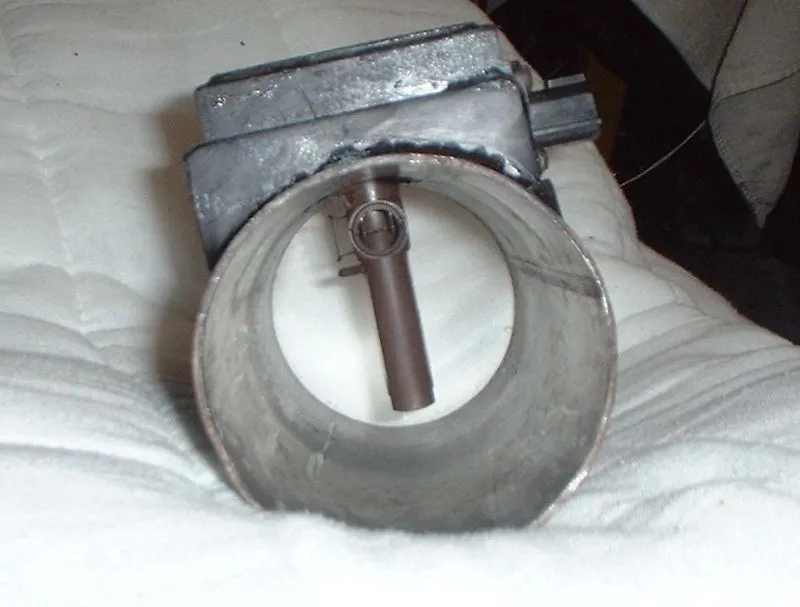

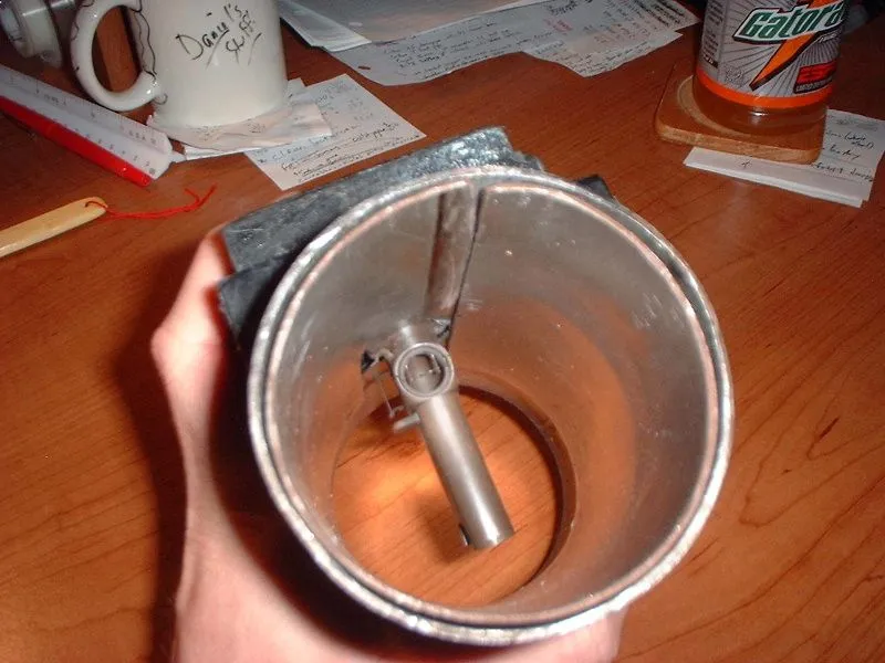

i was bored today and thnking about doing the SRI.
what i wanted to chime in on was that the stuttering issues people may have could be caused by the inaccurate diameter of the MAFs housing. ok we know that. so what to do.
im putting the "backstory" in quotes
well, it just so happened that when i first turbocharged my 240sx, i used a hacked mafs setup. it used the principle that going from stock 270cc injectors to a set of sr20det 370cc injectors that dropped in the fuel rail, was an increase of ~37%. luckily, late model 240sx's used plastic mafs housings with a probe style, hotwire MAFs. DSMs had done this before as well, so what we did was cut the MAFs housing to just the probe and square area above it that housed the circuit board/electronics.
Doing some calculations with radius, diameter, pi, and using our 37% increase from stepping up to the larger injectors, we were able to find out the size that the "new" MAFs needed to be. the stock MAFs was ~2.4xx" inner diameter, and after the calculations, we came up with a figure that a 37% larger MAFs housing would have to be ~2.875". perfect. we then placed our MAFs probe in a 3" outer diameter pipe, with 1/8" walls (.125"), making the inner diameter 2 7/8" (2.875").
this was all done to bypass having to buy an s-afc,and cut the fuel trims by 37%. plus, being an s-afc tricks the MAFs signal going to the ECU, the timing maps remained unchanged and can cause problems when starting to really fool with s-afc "tunes". (the hacked mafs setup we used, we just used a .75 degree of timing retard per lb of boost, and we deviated from the stock 20 degrees by moving base to 16* BTDC and were only planning to run 7-10psi, and it worked out perfectly, for being way cheaper and definitely safe.
anyways, we found there were slight inaccuracies in guessing the MAFs housing, being that a "percentage" increase involving cross sectional area and volume and flow patterns really couldn't be spot on with simple calculations (whereas going from 270cc to 370cc on the injector side of the equation was rather straightforward).
what we did was develop a "shim" to slide into the hacked MAFs housing, effectively reducing the diameter of the MAFs housing and kinda getting the fuel trims back to close to normal. before, they weren't way off, but they were slightly lean. the driveability test passed with flying colors, and the wideband increased noticeably when the shim was inserted.
all the shim was, was a piece of 2.875" OD piping with 1/8" wall thickness (mild steel exhaust pipe you can buy anywhere - stainless might be better to not build corrosion in humid climates), and it had an ID of 2.75", and the car ran a bit better, at least slightly richer to keep peace of mind.
here's some pictures of it, i'm going to attempt the custom SRI (because CAI vs SRI is a dumb argument and it really isn't much of a difference anyways). and while redspeed found the correct MAFs housing size, this could be a viable option as well...though i'm not sure how well it would work with the plastic spectre pipes, not sure how easy it will slide in and out.
these are just thoughts, and luckily newer MAF sensors are mounted on the pipe with screws, so it's easier to remount them (we had to get creative). but short of buying the right sized pipe, this is the only thing that will effectively "fill" the area without being a worry that it will get sucked into the intake tract or worse.
