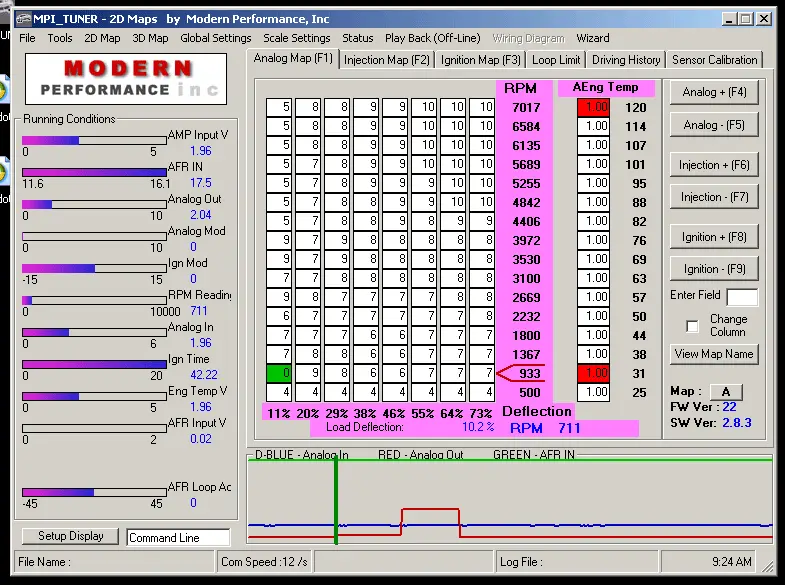

Problem 1: Bad maps randomly appears
Whats this....The car starts nice...drives normally, I stop to do something, shutoff and restart and as I drive it the car feels too damn erratic. So I connect the laptop to the tunner and this is what I see.
Whats supposed to mean?

Problem 2: Fuel cuts or what?
Looks and feel like a fuel or ignition cut, but the tunner gets crazy when this happens. For 1ms all readings go all around the map. You will need to replay the log file and see for yourself. This happens a lot, like 3-10 times every 30min - 1hour depending on how often I go into boost.
Problem 3 Off charts after boost
In this situation after a pull in 2nd, 3rd and 4th gear, notice in 4th gear how the ANALOG OUT sends a wrong voltage. WHY???? Notice that the Analog in is still sending the correct values!
After that, The car is not driveable, I have to pull to the side shutoff and start again the car.
Download the log file and run it, you will see how I try to continue the drive in the highway with no luck!!!

BUT, I found that my unit is still having an issue with the analog out voltage...and I think if this is having this problem, maybe it has other issues causing the cuts? Check the attachment.

Why are you running the analong output if you are not controlling the stock injectors? I will not guarantee that your MPI Tuner is not defective at this point in time. If it is it would be the first defective unit we have had.
I do know that everytime anyone has had any problem like you are talking about it has come down to bad wireing, bad tuning, or other problem with the car. If you send the unit back to me I can test it and make sure that it is working fine. After I test it and it checks out fine[more then likely], I will send it back.
Then you will have to take a step back and look at your car part by part and find the problem. By not tuning the stock injectors you are already hurting any chance you have of ever getting your car to run right, but it is you car and you can do what you want.

Ok good...the unit works. But what if I do changes online and the MPI tunner doesnt take them! How Im going to tune this thing?
You use the input to read the MAF not the output.
Then what does the OUTPUT do? Isnt the output what the MPI sends to the ECU?
