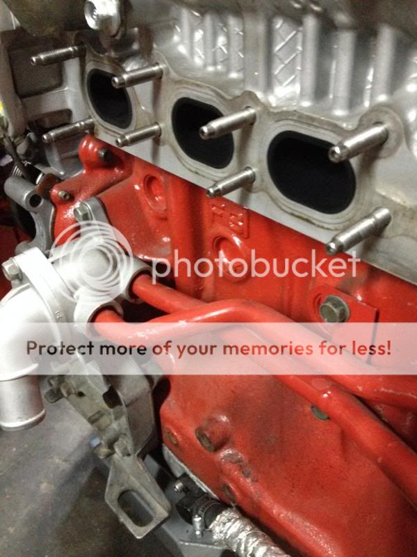

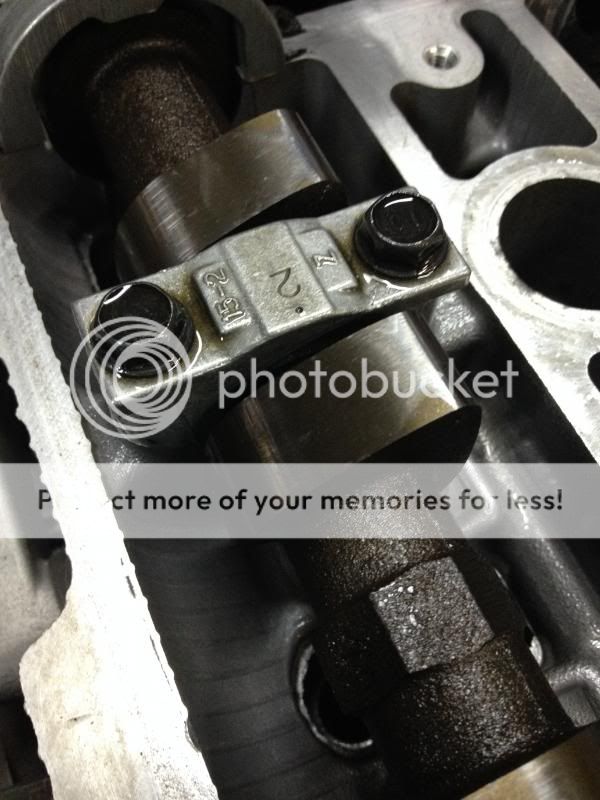

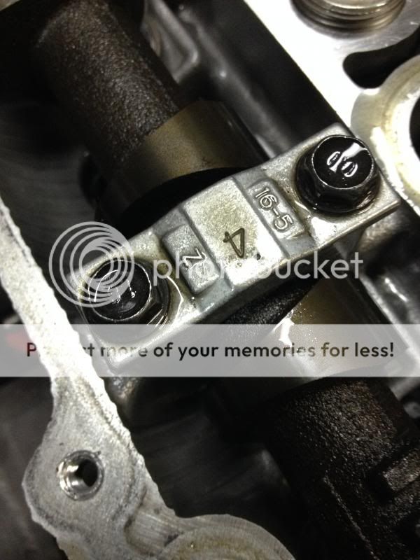

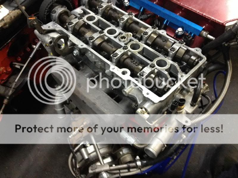

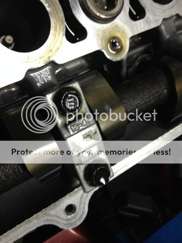

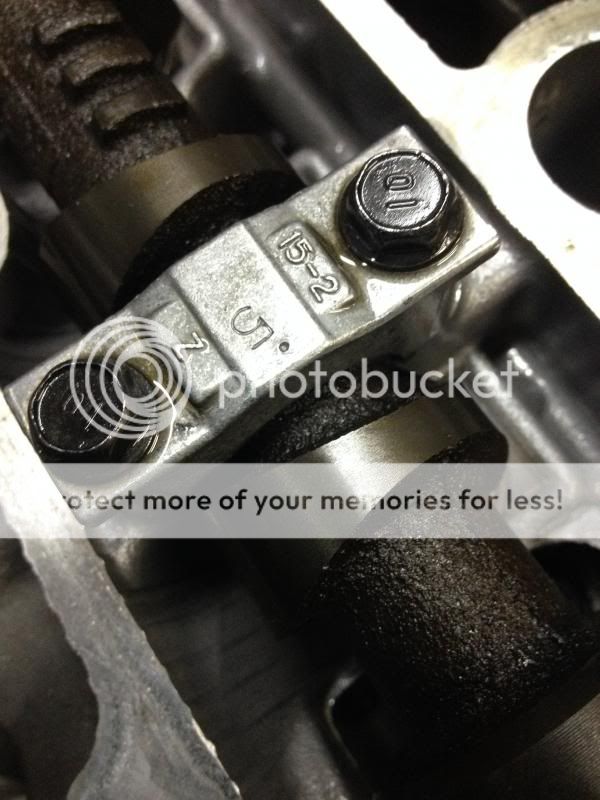

so i guess whoever re built the cylinder head was retarded and put the s*** together backwards. I sure hope my rods and pistons are still ok.
What do you mean "backwards"??
It wasn't whoever REBUILT the head it was whoever put the head on. You can't install the cams and caps until the head is torqued onto the block.
Well I dunno lol. I'm not an engine builder . This is just what Dandw said to me
I'm just not relaying info properly all I know is it's getting fixed for good. Cylinder head is getting rebuilt and they will double check to make sure the bottom end is still ok. Than I will go from there.
So the cylinder head was assembled wrong from whoever built it in the first place. Got another engine given to me for free and turns out the cylinder head on that one is also ******. So im back on the search for a 2.0l cylinder head that is rebuildable
I've got one sitting in my garage. Came off an 02 protege5. I have it apart and I can supply cams and caps too if you need. PM me if you're interested.
Big thanks to alamo1 for helpin me keep the build moving along. Update is it is back in the machine shop with the cylinder head i bought from alamo and new cams from corksport. Gonna hope this time around it turns out nice. If all goes well in a few months ill send it to toma to tune it.
