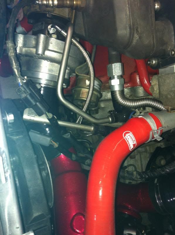

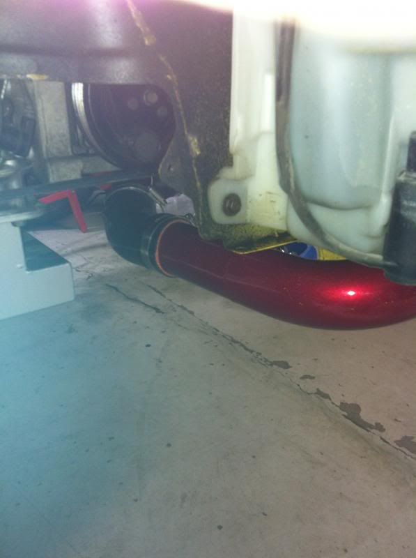

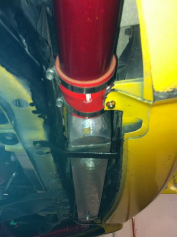

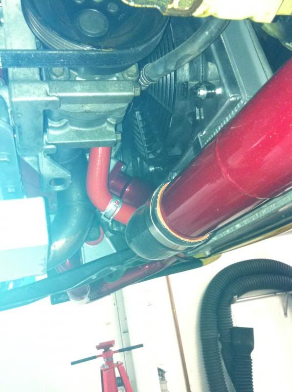

Intercooler core is now installed. Pipes are being welded and fitted. Should be bring pipes to the powder shop in about a week. Ill be looking into getting an ebc soon. Im thinking about an hks version 6 what is everyone else running for boost controll?

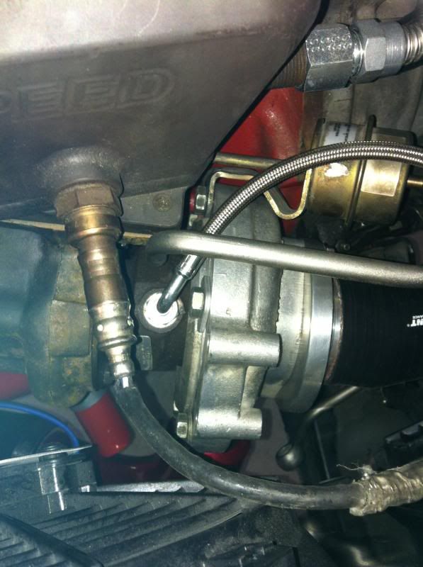

So the turbo has been clocked again to fit a shorter distance to the intercooler. Pipes are at the powdershop and will be back in a week. Went to get the fuel pump put in and it wont fit. Its a walbrough 400 so i might need to buy another fuel pump. Aem ignition coils also getting installed. Gonna double check the sparkplugs to make sure they will work with the aem system. Next the oil system will be getting installed. Fuel hose is installed on the fuel rail now. Seems like there is a bit of a gap with the 1000cc injectors and the 505 intake manifold so im hoping its not going to leak.

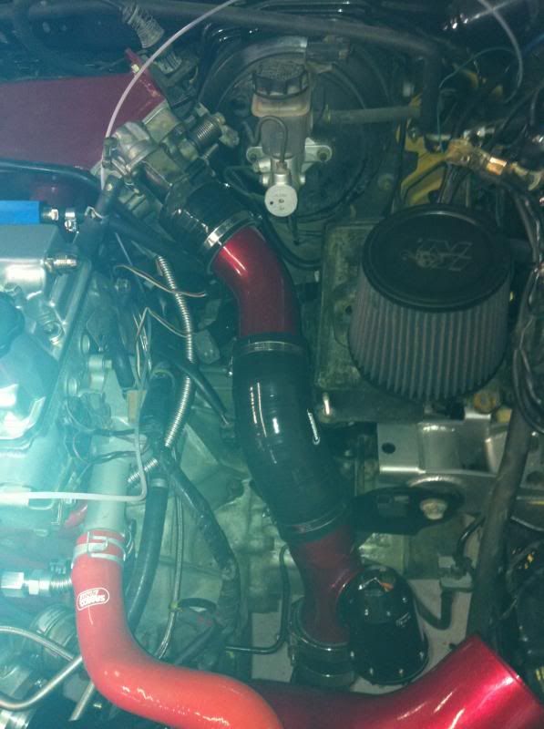

Flip that BOV 180* around. You'll get easier access for the vacuum line and it will keep water from collecting in it and being sucked into your intake.
Lol ya we were actually just talkin about that when i was at the shop. Turns out this bov is counterfit too which kinda sucks. Hopefully it doesn't leak. Next up is the oil system. Might just get a 2 way drain so the oil system and turbo both drain into the same spot on the oil sandwhich plate.
