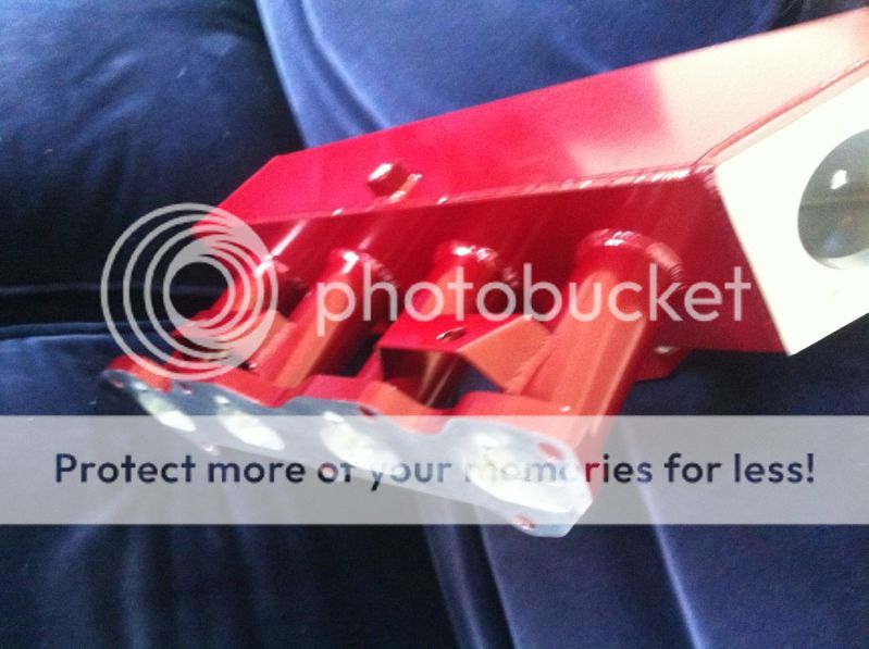

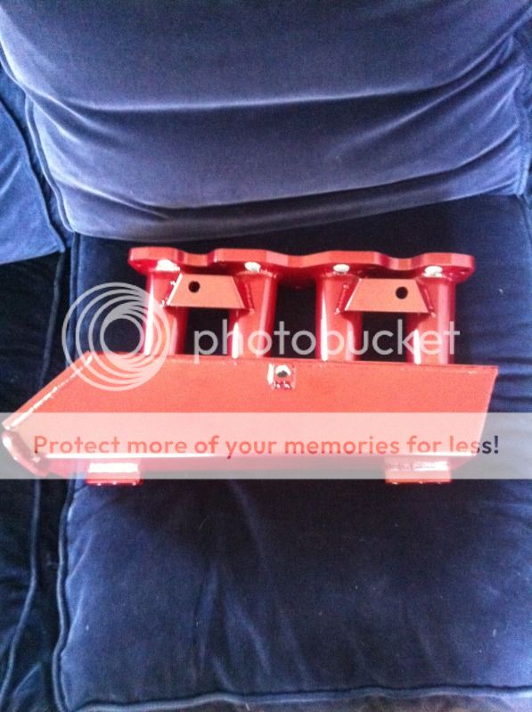

Ya its gonna be sweet when it gets done. I was just hoping it would be done sooner so i can enjoy it for the summer. Samco rad hoses came in today along with my 400lph fuel pump. Radiator should be here soon and ill be getting my intake tommorow:)
