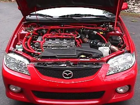

Is there anything "bad" that can happen by removing the first part of the original mp5 intake? It just seems so stupid to have a small intake like that sitting and sucking warm air from above the radiator.
I attached a file with an arrow pointing to the do-hickey that I want to rip out.

Nope...not that I know of
I did the same mod and the car runs fine. You notice a slight difference in throttle resopnse, nothing drastic though. Also, there's a very slight increase in growl when you step on the gas. That piece is basically for resonance purposes to keep engine noise down.
I've taken the quasi cold air/air muffler/water bypass off my Pro5 for the following reasons: After long trips that part of the airbox gets really hot since it's over the manifold and radiator. Also it weighs ~ a pound. Like Mah P5, my car now has a little better throttle response with a little growl. I wouldn't recommend to ride around in the rain & puddles because there is better chance of sucking water in. Also that chimney part of the airbox is sucking "dead" air. Dead meaning warm air sitting in the engine bay. The AEM short ram intake sucks "dead" air too. I'm waiting on competing companies with dyno results before I buy a CAI. I'll be damned if I spend $300 for a 2-5 hp increase. I was happy to get a moderate hp, torque, and mpg increase with the K&N drop in air filter. I couldn't beat it for $34. Also I don't have to worry about that maintenance item since it is warrantied for 1,000,000 miles.
There's no consequences really...it'll be removed as part of any CAI install...and even if you just removed it and didn't buy or make a custom CAI, you'll already get a little better throttle response.
I really don't think the AEM sucks in "dead" air. It sits down by the hole that goes to the ground. I doubt AEM would release something that shoddy. They do have a track record for some of the best research.
