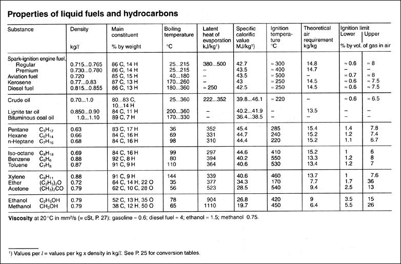

This is taken from The Bosch Automotive Handbook:
It's interesting to note that Acetone has similar properties than Ethanol. It also ignites at 9 parts of air and is a lot more volatile than gazoline. Ignition temperature is quite high (it has an octane index of 150).
If Acetone is mentioned in this book it surely means thst it has been considered. I've "heard" tha some gas companies are using it as part of the additives they put in their gas (to market it as a claner burning gas and so on). For plastics and other parts that could corrode, some people have done tests (in different forums like ours) and did not report corrosion. And IMO, 1/1000 parts of acetone surely doesn't corrode more than 10% Ethanol.
It would be nice to find a serious study about this additive, see its effect on EGT, timing and so on...
