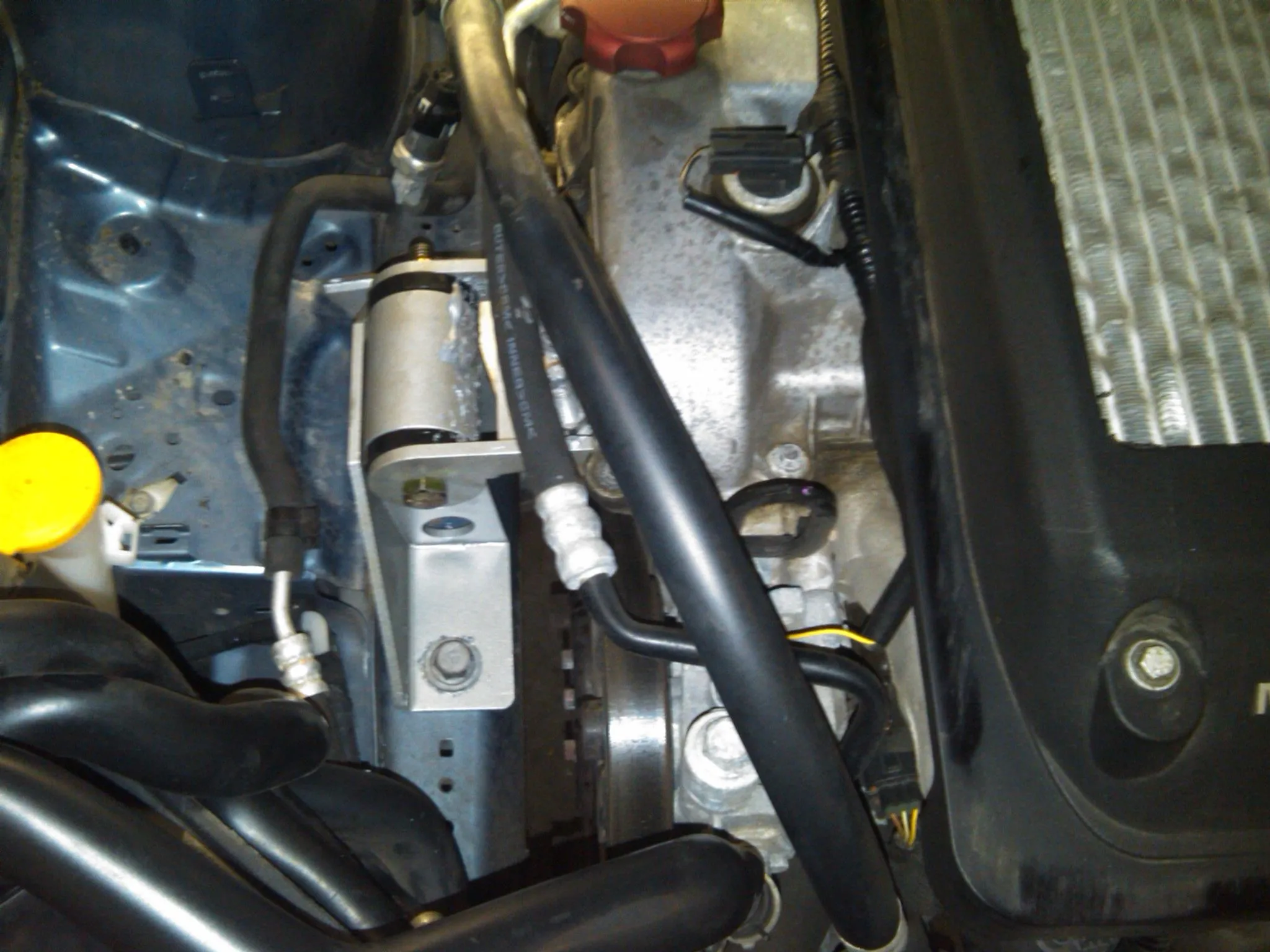

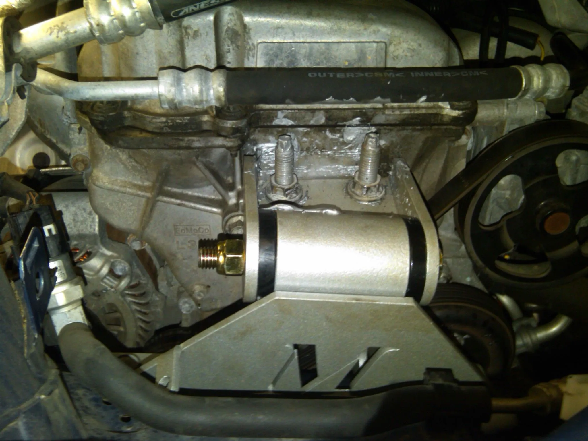

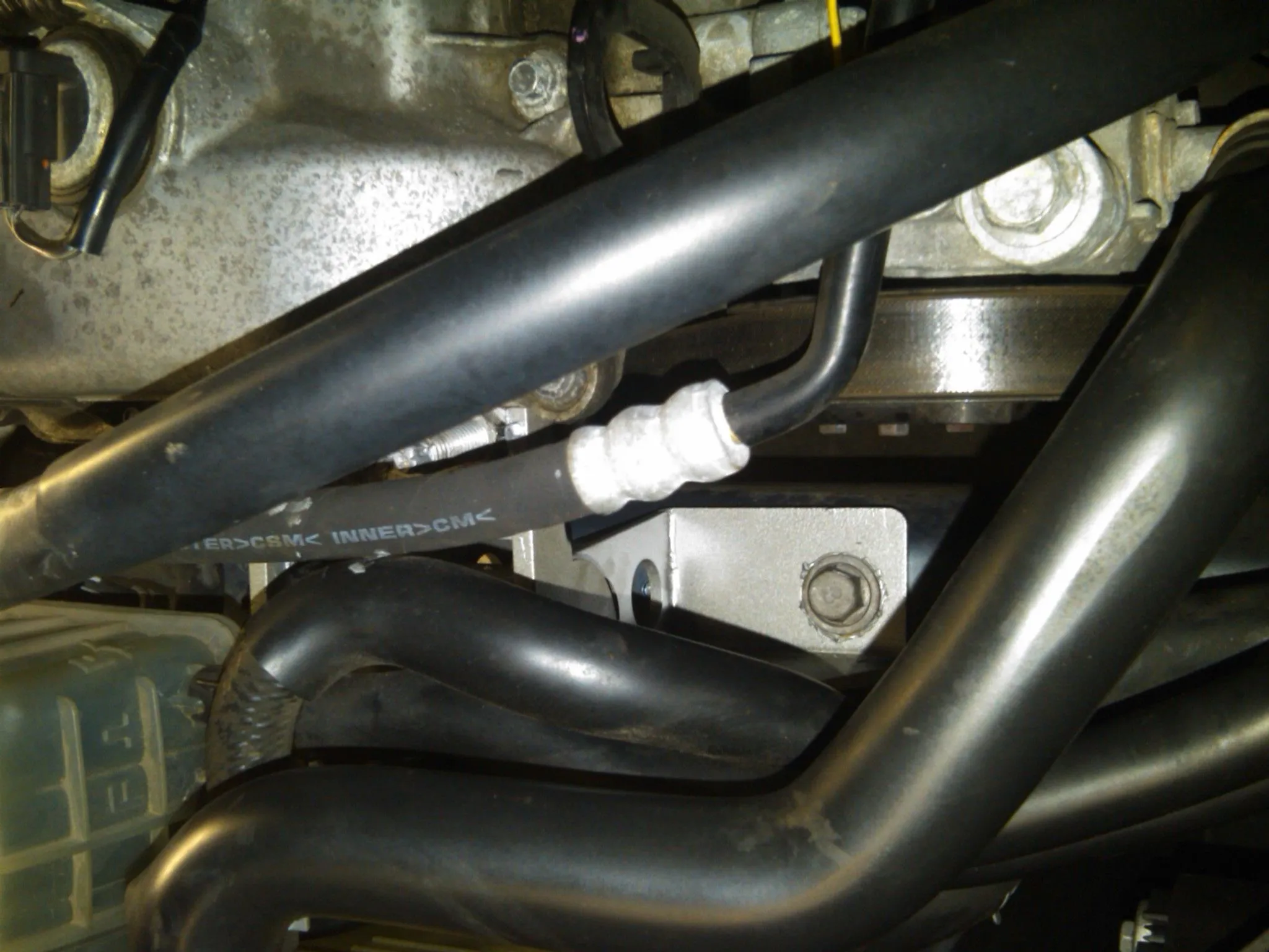

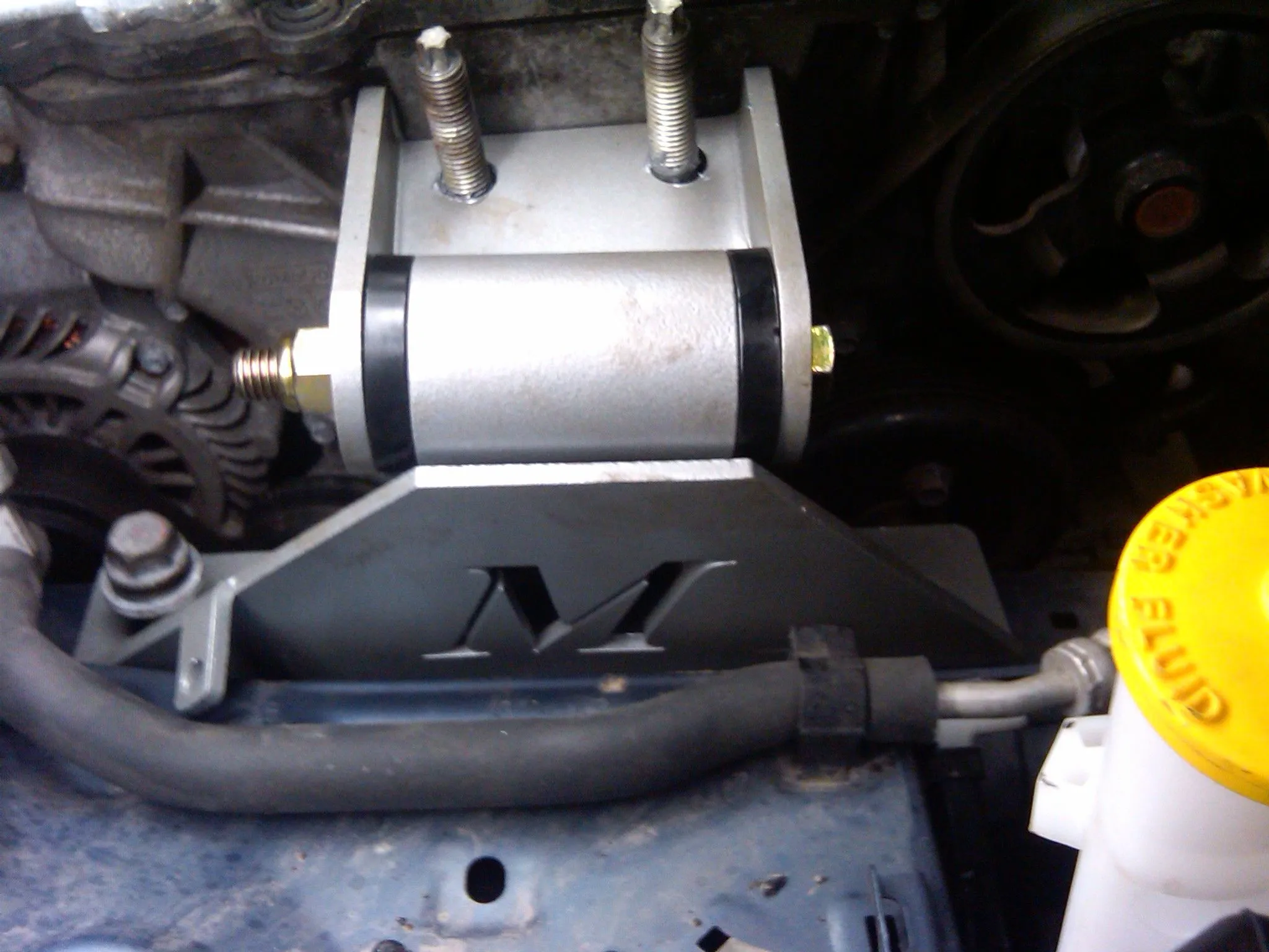

im going to attach some pictures.
install was easy
1.unbolt coolant tank and just bend it back. (something under engine to support it. to be safe)
2. unbolt the mount and just take it out.
3. take out the studs on the block (for this mount you have to remove them just to drop new mount in.
4. remove the ground wire then just relocate it up on the shield. drop the mount in, put the bolts that go to the frame first then screw studs back in. (i used anti seeze for all bolts)
5. tighten all bolts then bolt the tank back on and your done lol
