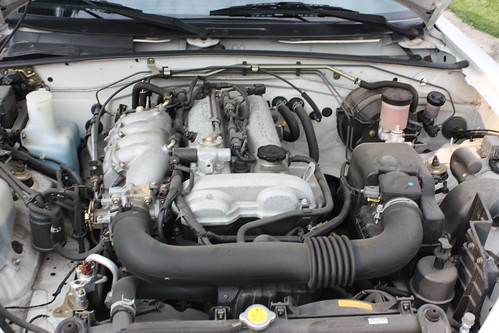

We cleaned up the dirty engine bay (it had dirt dobber nests in it! lol!), but the fluids were all perfect and the car spins like a top.
