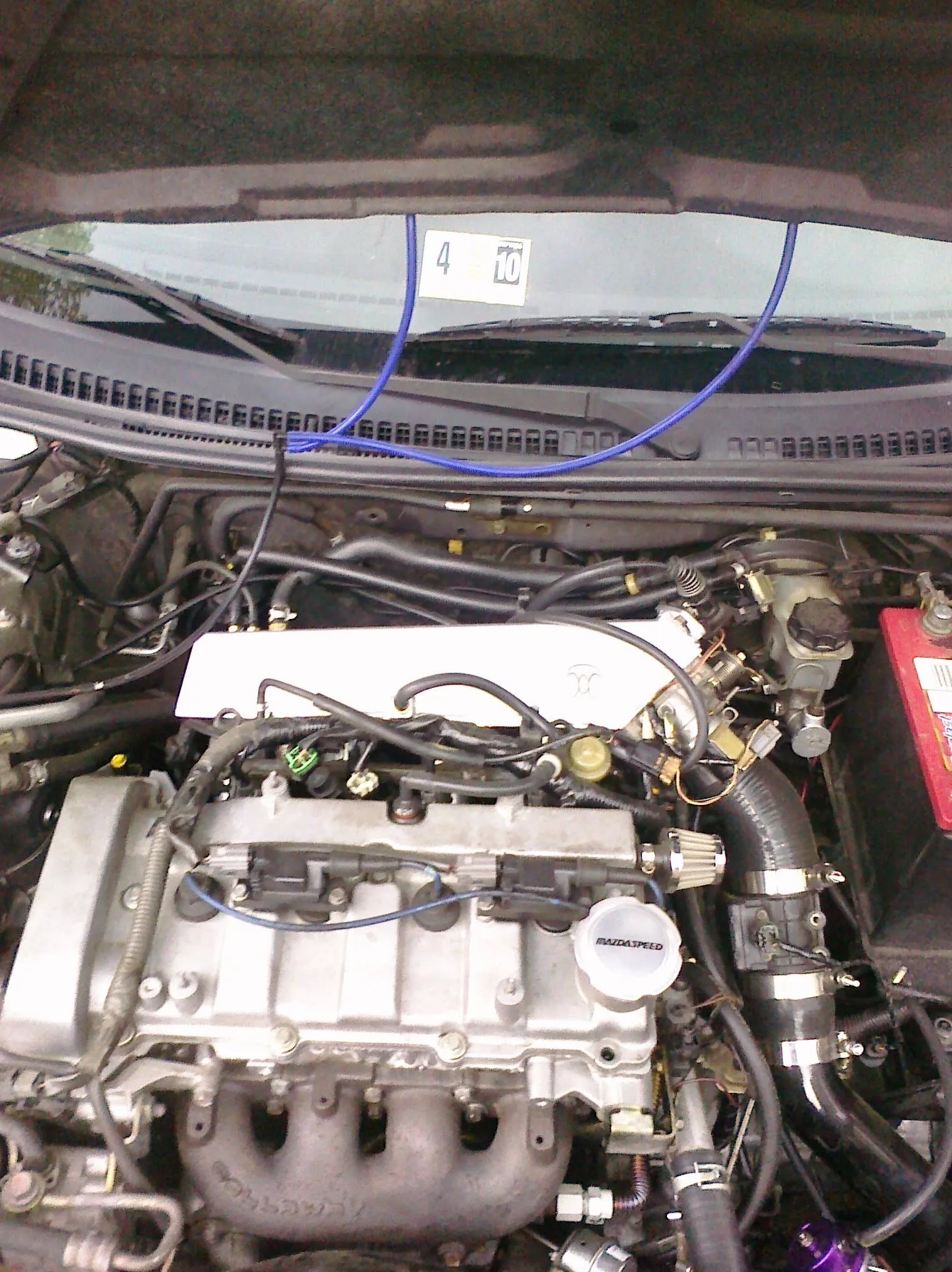

sorry to thread jack but this questions been in my head for a while. Do any of you think i could run a meth nozzle on the bottom of this coupler without it destroying my maf?
Just put it as close as possible to the throttle body while still having some room to manipulate the coupler / TB connection. Methanol vaporizes pretty quickly, so with air always passing through the MAF area, you shouldn't have any puddling issues or anything like that. Best idea would be to drill that pretty manifold and do direct runner injection.
Never put the injection before maf otherwise your car will bog as s***.
