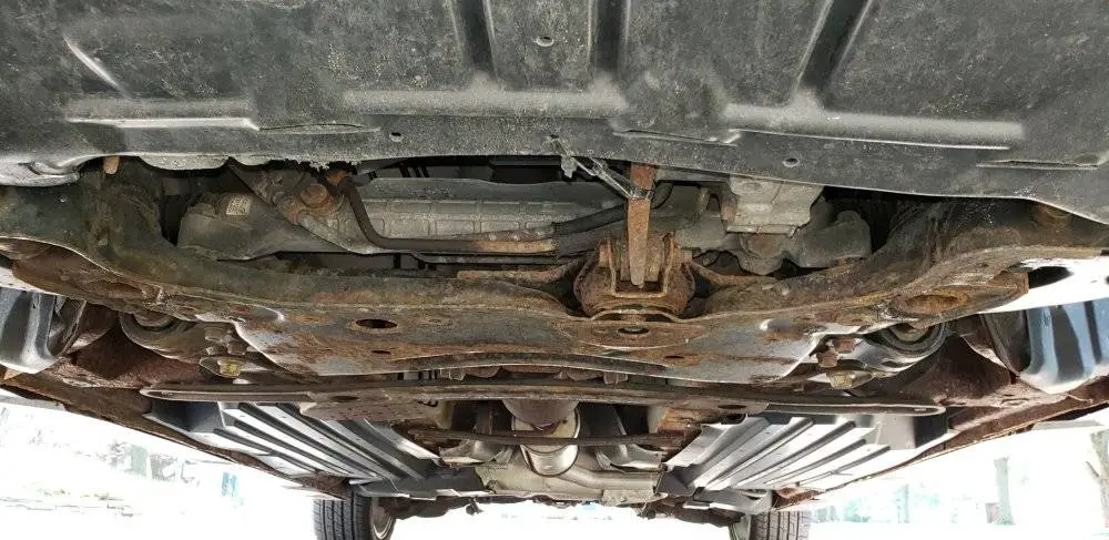

Just bought this 2008 Mazda5 with 128,000 miles. Here's the undercarriage. Curious as to your opinions on the rust. Taking it to my mechanic for oil change and plugs so will have a better look and inspection when it's on the lift. Any spots in particular to watch out for and check out more closely? THANKS!

Looks like a lot of surface rust, but nothing that would scare me off personally. Depends on what you're used to in your region - I live in an area where they salt the roads heavily every winter, so that looks normal to me, but it would probably be a surprise if you lived somewhere like Arizona.
If anything, I'd say that it'll be harder to break some bolts free if you ever have to replace anything on the undercarriage, so be prepared for that with some penetrating oil, elbow grease, and maybe a few extra nuts and bolts.

Thanks--I'm in he Cleveland, Ohio area and they use salt in the winter.

uhhh, considering what we've seen in terms of rust in the "rust belt", I'd go at least south of kentucky. that looks horrific, just imagine what the rust on bolts look like when you're ready to do a brake job.
So now I have 2 completely divergent opinions. Guess the only way to tell for sure is when the car is on the lift and I can closely inspect, tap, probe, scrape everything. This is my first MZ5 and I really like it a lot. But if I've got issues that I'm going to be throwing money and time at, then I'll think about selling it and finding a cleaner one from a salt-free area like the Carolinas or Texas or Arizona...
Right. It's hard to tell from those pictures if there's any spongy or rust-through spots.

Its hard to tell from pictures at the front there, but I don't see any obvious holes, there's still a bit of painted surface on the subframes, and the pinch welds running along the sides are straight, so I'd suspect its mostly surface rust. This will give you an issue with all the small 6mm bolts and studs holding underbody plastics on (prepare for lots of breakage), but larger bolts should be fine.
However, I've found that the real problem area is the back, around the rear wheel wells (especially their leading edge), and the body around there, the rear subframe mounting points, and over the muffler and it's heat shield. That's where the rust on these is almost always at its worst.

Yes, you need to go poking and poke in the corners and not just where you can see.
This looks driveable for no more than 3 more years in the rust belt.

If you drive that car like it is for 3 winters in the salt...I'm betting it's toast.
Fluid film is like what you have but not the same. It is a gooey sort of undercoating that sprays on and sticks like a grease.
Your stuff may be fine too but you need a wand applicator to get it in the hard to reach areas.

1st thing is take a heavy screwdriver and see if you can poke holes in the frame, near any spring supports, and the rockers. If the screwdriver goes through you have big problems. You definitely need to spray the whole undercarriage with rust converter ...wait for that to dry for two or more days then coat that whole thing with fluid film. Or find a good local mechanic to do the above. Good 🤞.
You really should convert any rust before you fluid film it.

There's mixed reviews on rust converter.
I used Rust-Oleum Rusty metal primer spray can for light surface rust areas.
Luckily mine ( 2018 cx5) was only light rust. Wish had watched videos first.
But there are some youtube videos which tested rust converters found the high phosphoric acid converters that are paintbrush on work best. Check vids for products. "Repair geek" video results:
1. Rust Kutter paint on
2. Corroseal paint on
3. VHT spray on
All others failed testing... See video
Of course Coke and Pepsi have phosphorous acid so guess you theoretically could make some cola gel and maybe paint that on?? Not sure how well would work. Although I was able to easily remove rust from alloy wheels with just Coke & aluminum foil, not sure if best solution for rusted frame.
Also don't spray fluid film on cats, exhaust, etc as will burn off and don't spray on shocks /strut assemblys so you can see if they leak/fail. Avoid spraying rubber, boots, etc.
Only spray the underside that's exposed ( Mazda has covers on alot), really spray the rockers, the frame around the strut/shock assemblys, wheel wells not covered by Mazda covers, etc. Don't forget to spray fluid film inside the frame holes, bolt holes, pass-thru holes, etc. Anywhere there's a hole, get some FF in there. If unsure, watch some videos on undercoating car/suv with fluid film. "Repairgeek" has good YouTube video on fluid film. Don't forget to wear your PPE respirator/mask.
