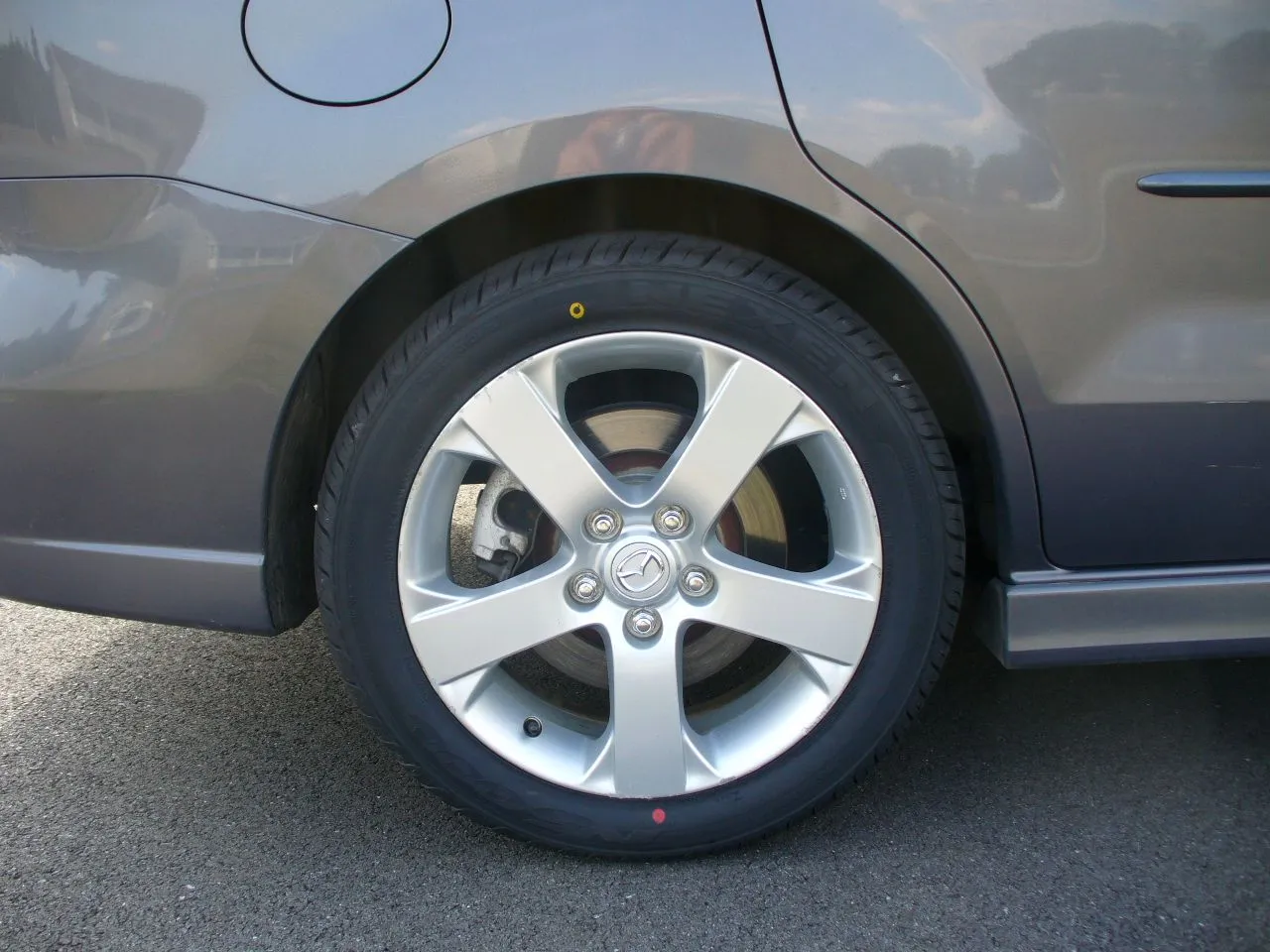

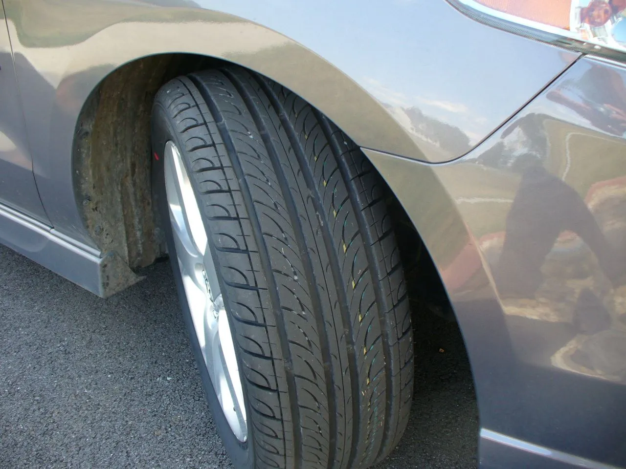

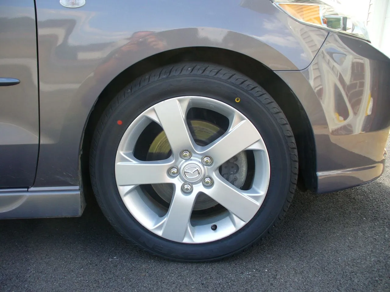

Just got some Nexen N5000 for $80 each out the door from local dealer. So far so good. I didn't know much about them other than they are Korean but decided it was worth the chance. Dealer said the have sold a lot of them with little problems. Seem pretty quiet so far. Still handle pretty good but not quite as sure footed in the twistys. They are H rated instead of V but its my wife's car so I think 130 mph is still plenty plus car rides much better. I do miss the woop, woop, woop sound my stock toyo's made!

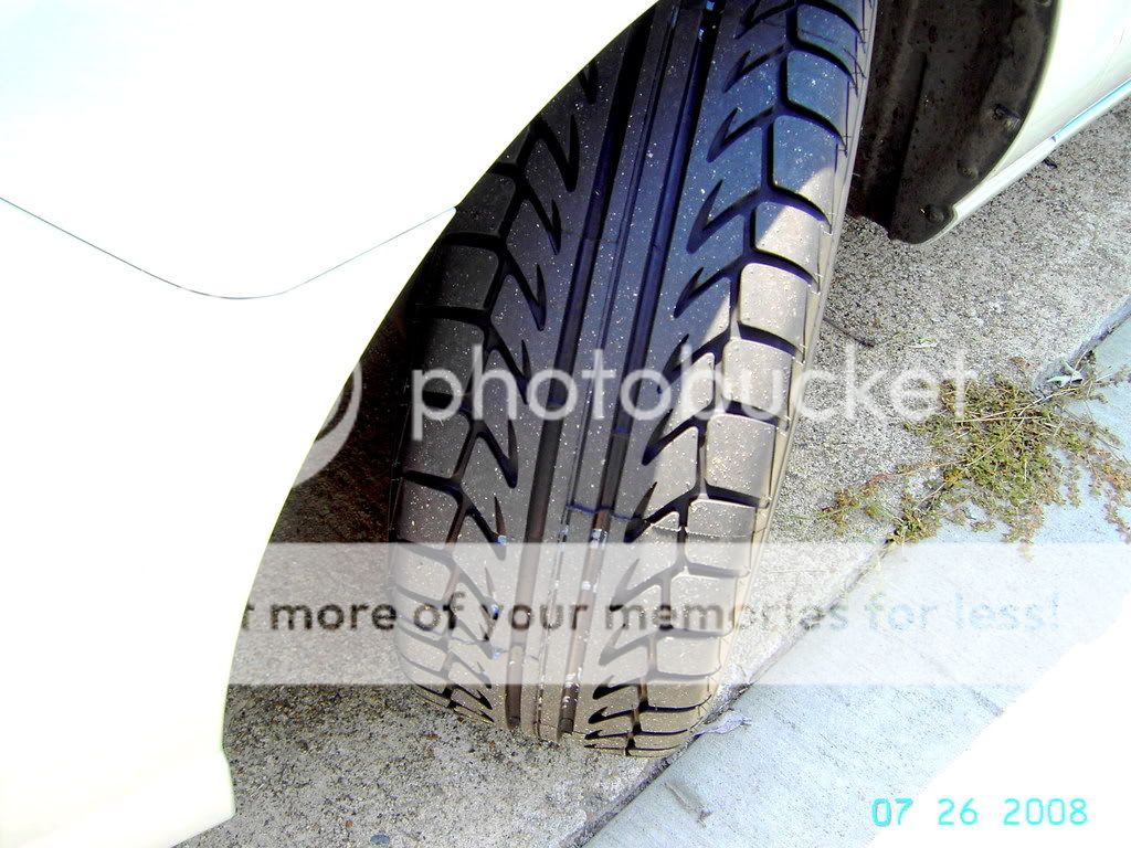

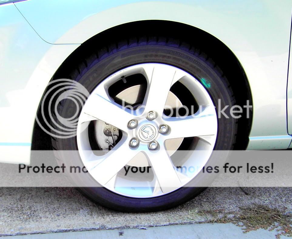

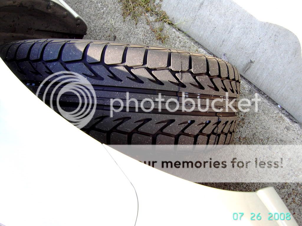

Some pic's of the new tires...... pretty smooth ride, alot less road noise than the OEM tires, seems a little more loose in the steering, but may not have the right pressure in the tires, checking that today...... I'll keep updating the site on how they wear........ Sam's has a 4 year warrenty on the tires......we'll see.....
205/50ZR17 89W BFGoodrich g-Force™ Sport
I had BFG g-force Sport's on the Focus I had prior to my Mz5. They seemed to be a great choice for the Focus (good handling, quieter than OEM Firestone's) and weren't too outrageously expensive - but isn't any 50-series tire expensive nowadays?
I sold the Focus after putting about 15K on the g-force tires and they were still going strong. The car was sold to an acquaintance of mine and they have another 15K or so now and she told me she was shopping for replacements. So, 30K wear on a Focus with regular rotation. I generally don't expect too much in the way of tire life from 50-series tires, but I am trying to make the OEM Toyo's last as long as possible (or I can stand them, they're getting noisy at 15k miles now...) and the g-force will be on my short list of replacement tires. Thanks for the info...(drinks)
Someone doesn't know how to mount tires..... Wonder how many weights there are on the inside of the wheel. I'm pretty sure you are supposed to line up the yellow (or red) dot with the valve stem. Motorcycle tires are that way.
