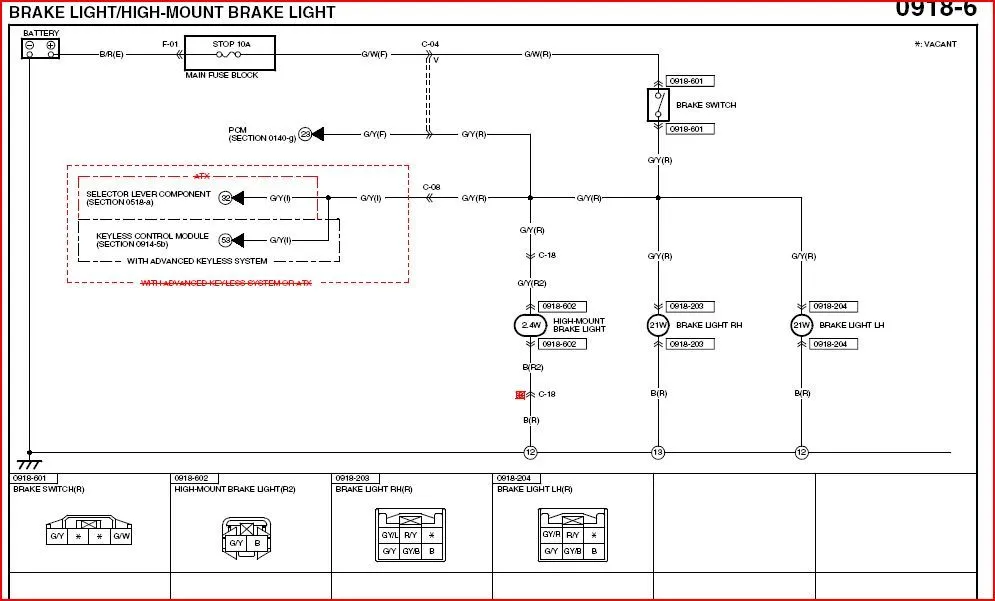

I wonder why there are 4 wires in that connector. The wiring diagram that I got from the internet only has 2 wires going in. For the brake switch.

What do you mean by 'shorted out'?
- The bulbs are burnt out?
- or the brake light fuses are blown?
- or the bulbs simply don't light up?
Anyway here's the drawing from a MZ5 wiring diagram. I have no idea
if this applies to all mazda5s.
good luck.
