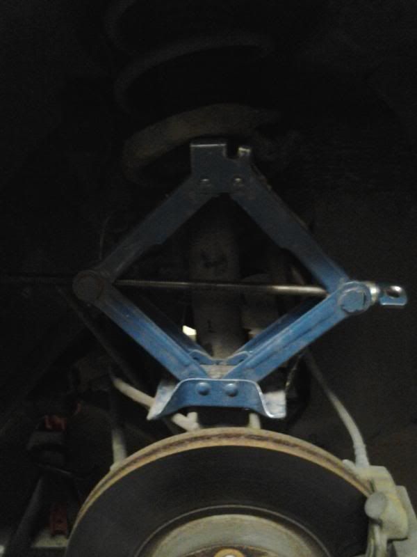

FYI.....when removing the OE strut from the Hub/Spindle let your tools do the work for you. Instead of using a hammer and spending time banging on the hub use a scissor jack to force the strut from the seating position on the collar. Like so:
Trust me, I tried- no matter how I crammed the jack in or shimmed it with wood or anything else, the jack kept slipping out.
