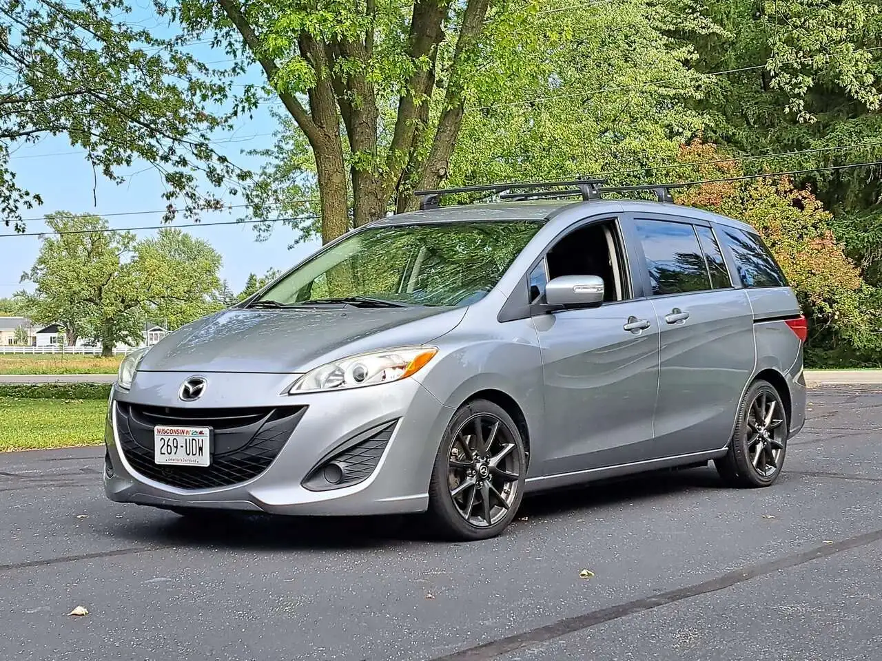

Honestly, just installed them as they were set from factory. I counted shock body threads and they were set the same accordingly. I skipped the drilling of the front upper mount because I couldn't be bothered at midnight when it needed doing. I might try an acetylene torch in there. not sure yet, but the fronts will have to come out again for alignment. Its not terrible for now, and I want new tires for next year anyway. (The 205s are too small)
I will work on final tuning after the second pass and get some numbers.
Holy smokes the rear suspension is noisy. I'm thinking about sticking some vibration foam all up in there. Any other suggestions? I don't think mileage alone is going to solve this. The plastic perch rings are still intact.
My final ride height is 24.5" front and 25" rear measured from ground to fender lip on wheel centerline.
Had some success putting a ring of adhesive vibration foam on the rear perch between the plastic ring and locking collar. Also put a ring on the bottom of the spring, so the plastic ring has foam on both sides. Now I just have some noise from the upper shock mount in the rear. Will add same foam there as well.
