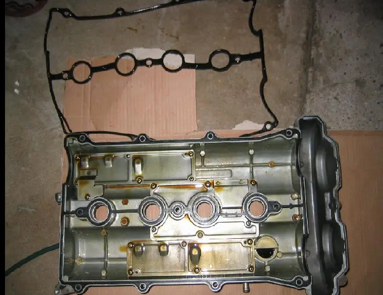

If you use a cheap/crappy aftermarket gasket, it will not last and may not even hold. Other common causes of leaks are not tightening to spec and/or in the right sequence, or poor prep on the surface area. I havent had any issues with leaks on gaskets/seals I had to service (knock on wood), aside from one bad experience due to poor quality part (see below).
What puzzles me is that both Mazda and Ford Motorcraft offer a replacement filter but they dont offer a gasket (not that Ive seen)..?.. Id like to know how someone is suppose to seal it. Is there an approved gasket maker/sealant with a Mazda or Ford label on it?? The fact they offer the filter would lead me to believe you can (debatable if you should) change it. On the flip side, there are quality aftermarket vendors (IMO, better than OEM) that do offer the gasket and filter kit for the Focus. Even the Duralast I used is not bad. I struggle to make sense out of this one How can the aftermarket offer a gasket but not OEM? Note: I did not research into the Focus or other cars that may share the same transmission/pan.
Personal experience, can you spot the difference between a quality gasket vs. junk? The junk gasket leaked on me after a few thousand miles and I had to replace it, again. Learned my lesson on saving a few bucks but to be fair I was mislead by the seller (I think it was alloemparts.com ?) who claim to sell OEM parts. I also bought a clutch slave and opened it up and the plunger and spring inside was absolute garbage.
