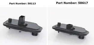

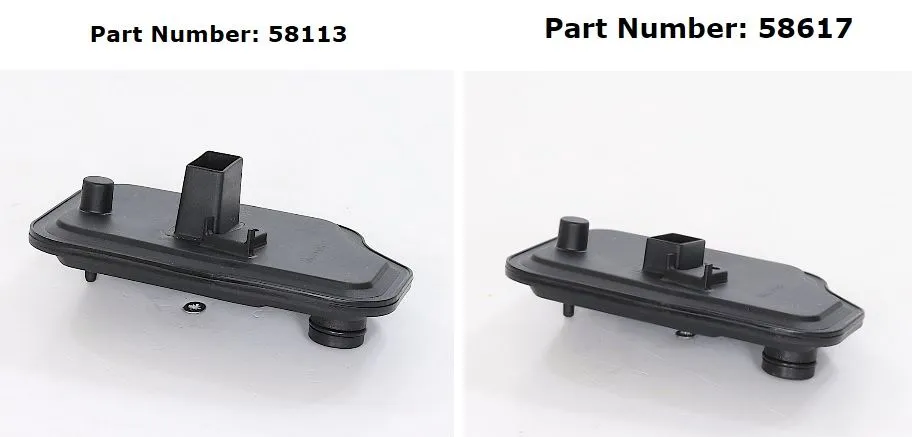

When I first changed out the filter and gasket, no replacement parts were available for Mazda so I went with a 2008 Ford Focus kit. Gasket fits perfectly and the filter works but the (discharge?) tube was shorter on the Focus filter. I need to open the pan to replace the pressure control solenoid and went shopping for a replacement Mazda gasket and filter and was confused by some misinformation. If you own a 2008 and google/Amazon for filters that 'fit my car', you may get the wrong filter.
TLDR, FNR5 (5 speed auto) filter has a longer tubing.
Using WIX's catalog as an example:
http://wixfilters.com/Lookup/Applications.aspx?Section=1
'06-'08 ref part#58617 for the 4F27E (4 speed auto) THIS IS WRONG. 2008 is a 5speed.
'09-current ref part# 58113 for the FNR5 (5 speed auto)
